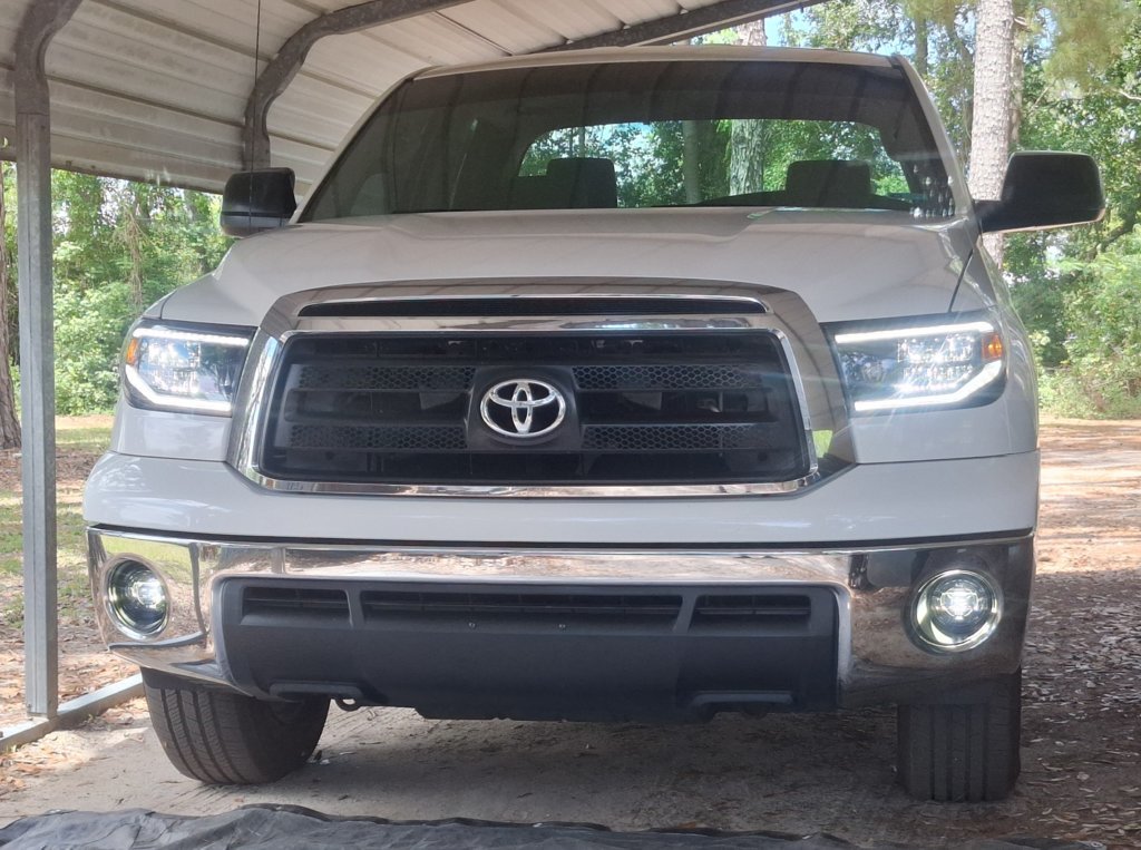

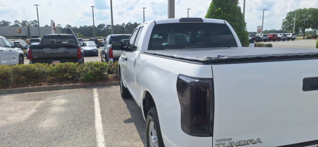

    2010 toyota tundra rwd 4.6l double cab
    Hey everyone. I have a 2010 toyota tundra rwd 4.6l double cab. I want to do a RC 3 inch leveling kit or possibly a 3.5 inch lift. I want to use fuel darkstar 22X9 5X139.7/5X150
    5.04 backspace 1mm offset 110.10 bore.
    Will these wheels work with either of those lifts and if so what's biggest tire I can use without rubbing or needing to cut stuff?20250504_140427.jpg 20250519_155841.jpg

    No way I would even think about a 22 inch wheel on these trucks.....especially with that size lift, and not to mention that the ride would be absolutely horrible. You are asking for a whole lot of rubbing issues with that wheel size. The tires wouldn't be more than bologna skins either.

    I can do a 305/50r 22 or a 33X12.5R22 with a 3inch lift according to everything i read. That's far from skins for tires. I'm more concerned about the offset of these specific wheels more than anything. I was gonna go with a 20 until I saw my sons buddies Tacoma with 22s on 35s

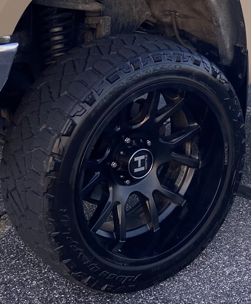

    Sell you these: IMG_6389.jpg

    What's the specs and how big is your lift? How much you looking to get for them. Any rubbing or clearance issues at zero lock, etc?

    If you're dead set on 22s then do it. It'll ride like crap is all. For that size and offset, you'll probably need to do a body mount chop and push the front bumper forward. Lift height isn't really the issue or gonna solve for that offset. That size would probably even fit on stock offset at stock height. Those RC lifts aren't great either, I'd stay away personally. I think you'd be better off leveling the front with 5100s and doing body mount chop and cutting pinch weld and push bumper forward if you want to make it work. Lots of guys do that for aggressive fitment and that's probably what you'll have to do if you want that look. To each their own.

    Depends on tire size but yea probably. You might clear the body mount but probably will rub on the mud flap and bumper. I'm running 20x9 +18mm with 285/60 tires. 33.5" tall. I rub very minimal. Usually when backing up and turning. I did trim my mud flaps. I'm lifted 1.5" up front.
