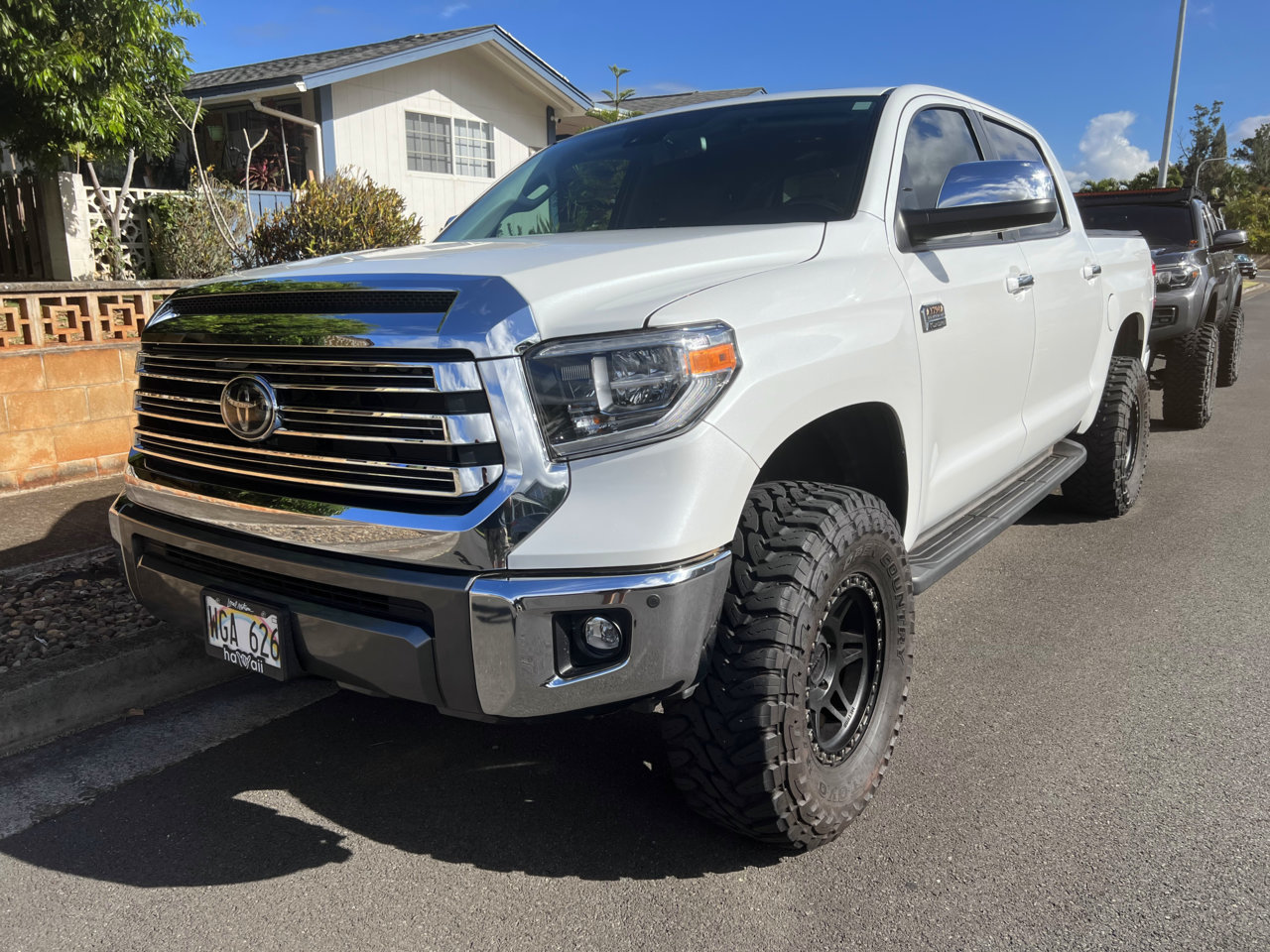

    Traded my 17' F-250 for this 21' 1794 Wind Chill Pearl. Had it for a couple months but ive done a bunch to it, so decided to make a build thread. I like the looks of the Pro so i decided to make it look like one lol.

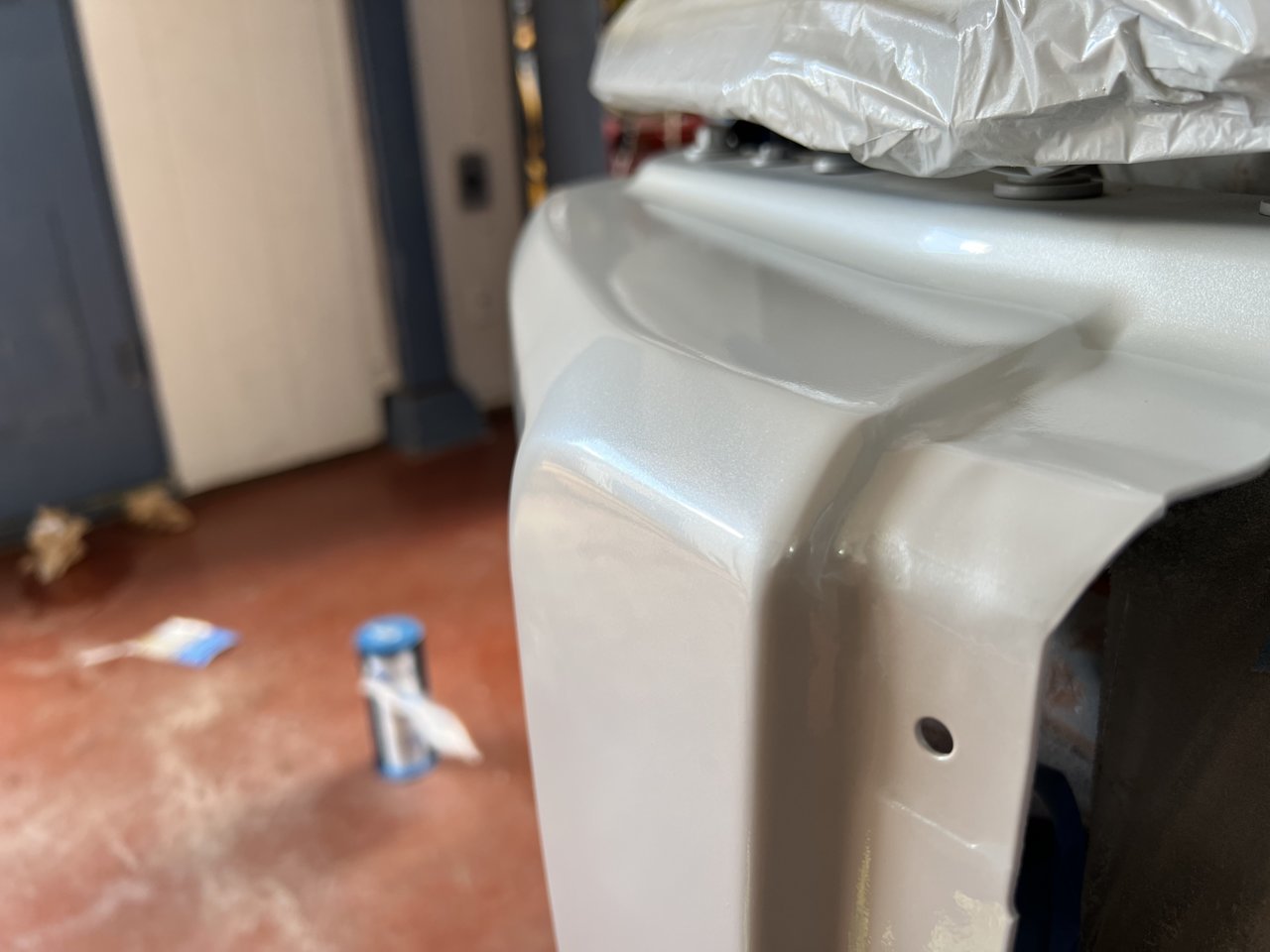

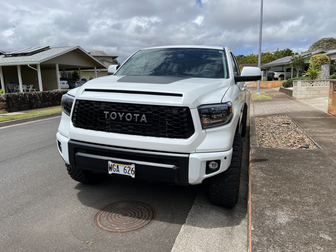

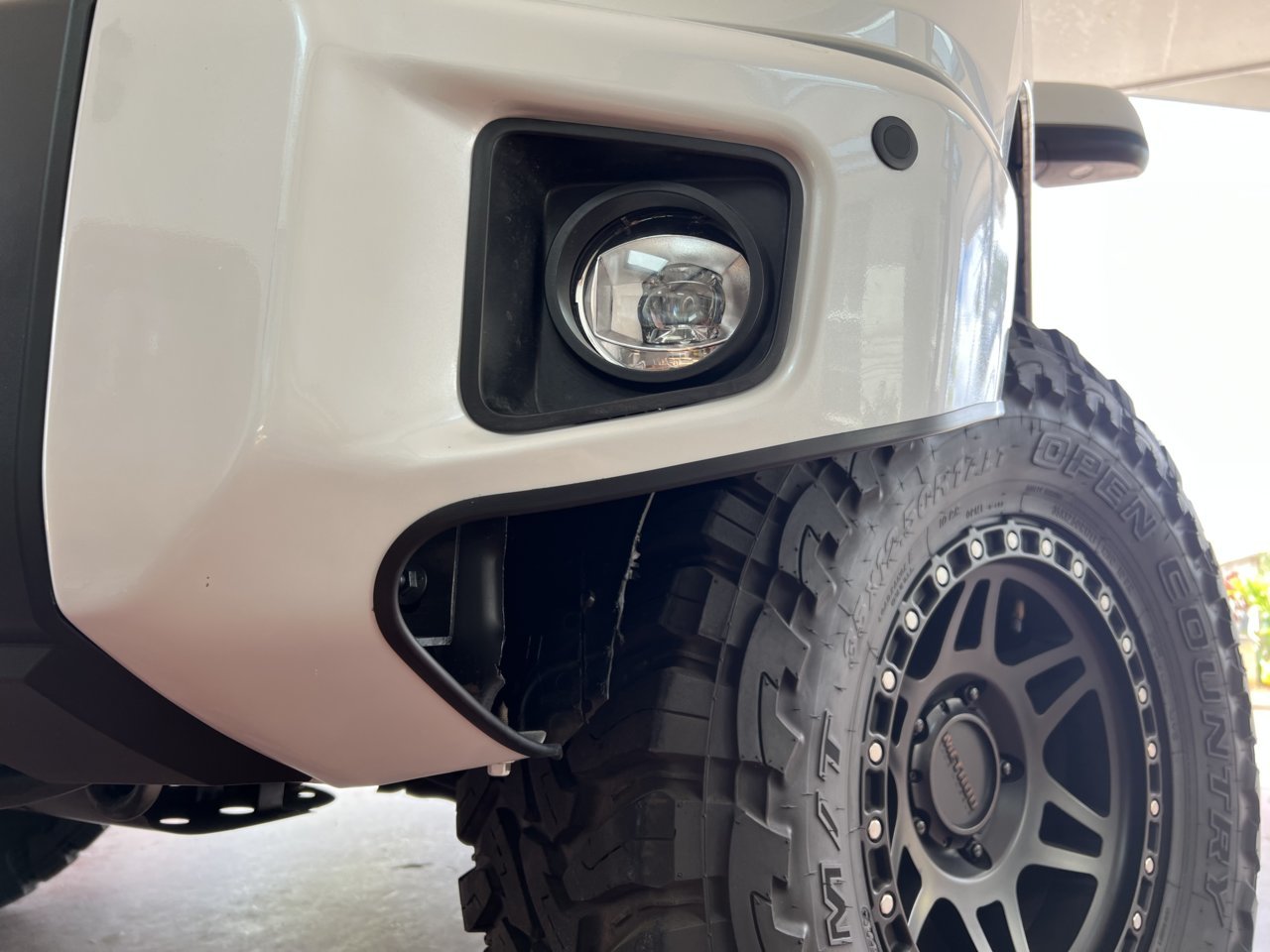

    --Exterior/Suspension/Wheels--
    -Truck came with 17" Methods and Icon Suspension
    -Changed 35/12.50/17 Toyo M/T's to 35/12.5/17 Geolandar M/T's
    -color matched the bumper caps, mirror caps
    -painted chrome handles and grey center bumper cover matte black
    -ordered color matched 19+ Pro Grill/Hood Bulge
    -TRD Pro Headlights
    -De-badged 1794 door emblems
    -"Viper Cut" front bumper caps
    -HotTails Option A + Full VLED swap of all bulbs

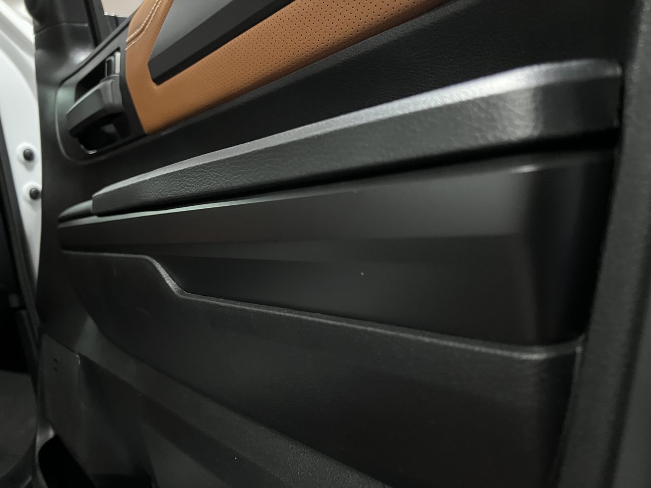

    --Interior--
    -Swapped Tacoma steering wheel
    -AJT full blackout kit
    -Meso Dome/Map Lights
    -VLED's footwell kit
    -TRD Pro all-weather floor mats
    -3 switch panel by shifter
    -paint all wood/silver parts matte black

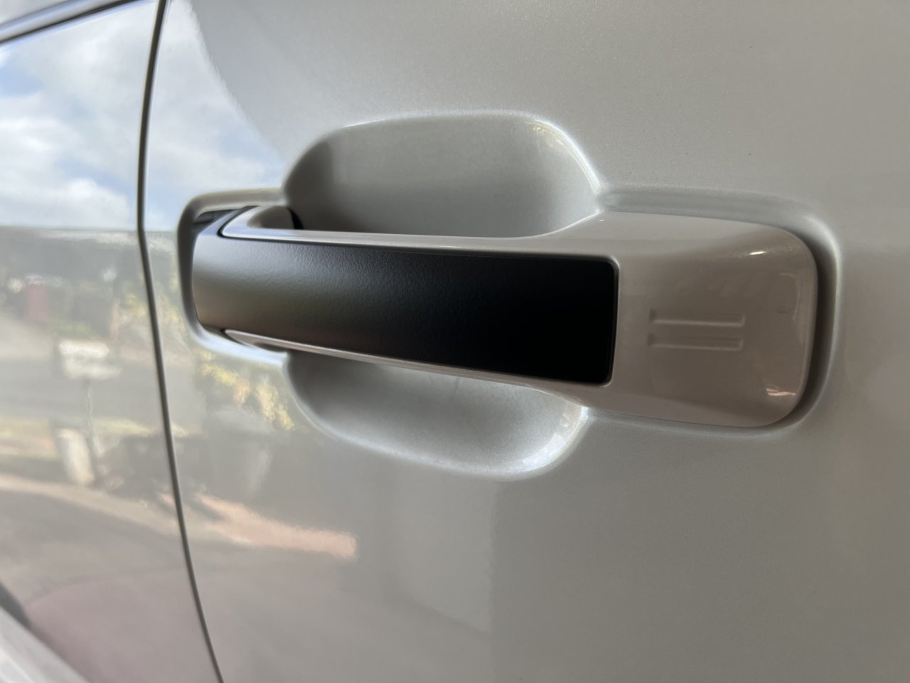

    How are your door handle holding up? I have a Platinum and the chrome door handles drive me crazy

    They still look the same as the day I painted them, and my truck isn’t garage kept

    Do anything special or just clean, prime and paint?

    sand with 320, adhesion promoter, base color and 2k clear. I didn’t use primer
