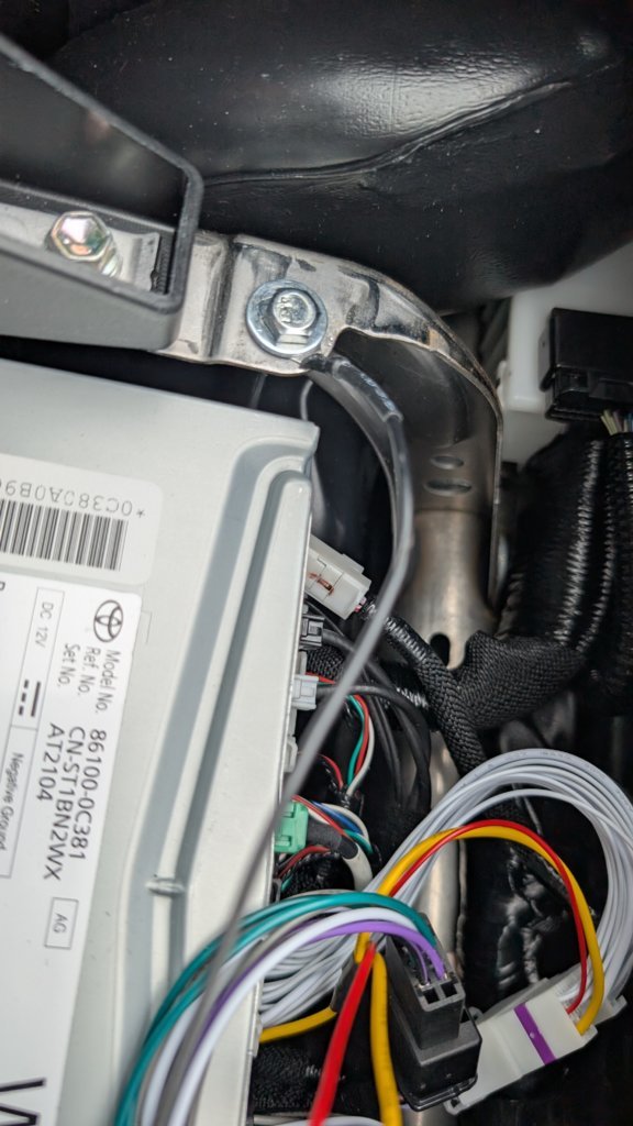

    Wanted to add an alternate grounding location for the Beatsonic amp. On the drivers side metal dash frame, there is an unused threaded hole. You can use an M8x1.25 (may be a m8x1.0) bolt and a washer to ground the amp.
    Mraz likes this.

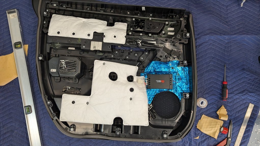

    It's been a little bit since my last post and a lot has happened with the system install. Going incrementally as I have has really given me an appreciation for how complex these new stereos setups are.
    Since the last update I have made several changes,

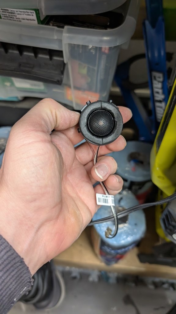

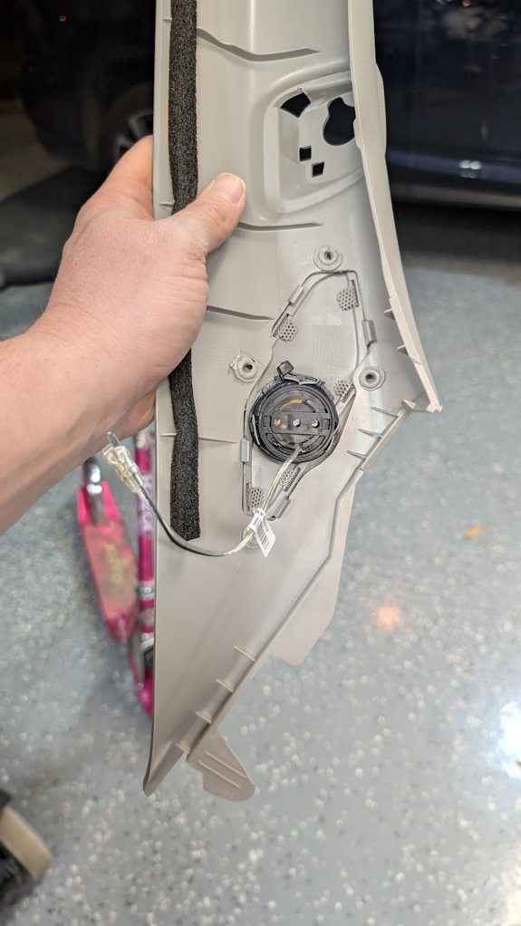

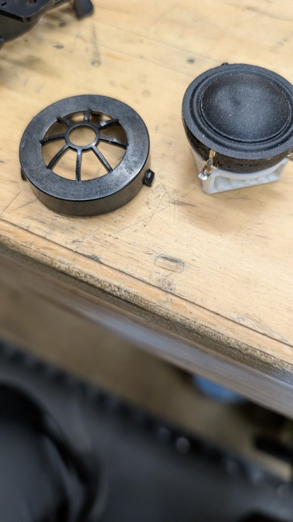

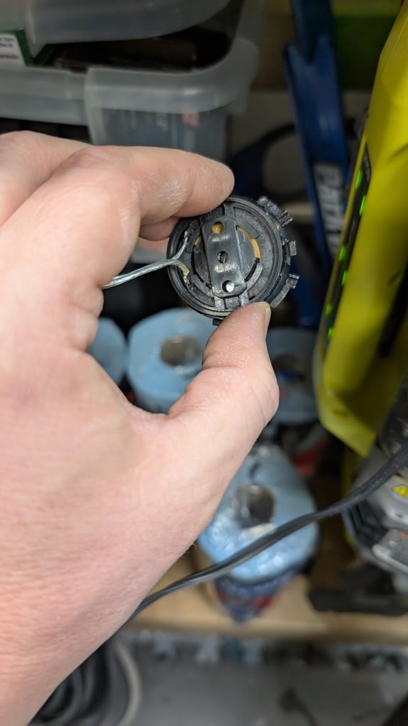

    1 - The a pillar and rear door tweeters were replaced with infinity 375tx soft dome tweeters. These tweeters fit nicely into the casing for the factory tweeters which allowed me to use the factory locations without any modification (until a tab broke on the a pillar thus the zip tie).I have put pictures below for refence on how I accomplished this if anyone else would like to try in the future. the case to the left of the factory tweeter is simply hot glued on. A little gentle heat with a heat gun and they came apart with a little work.
    upload_2025-5-17_9-23-13.jpg upload_2025-5-17_9-24-38.jpg upload_2025-5-17_9-25-1.jpgupload_2025-5-17_9-22-41.jpg
    2 - Added DS18 pro 2 way crossovers to the rear doors and a smaller capacitor for the front a-pillars. After listening for a bit i felt the tweeters were still to bright and added the 2 way crossovers to attenuate them by 6db. This helped but the fronts were still screaming loud. I changed the crossover in the front to a small capacitor and that helped a little.

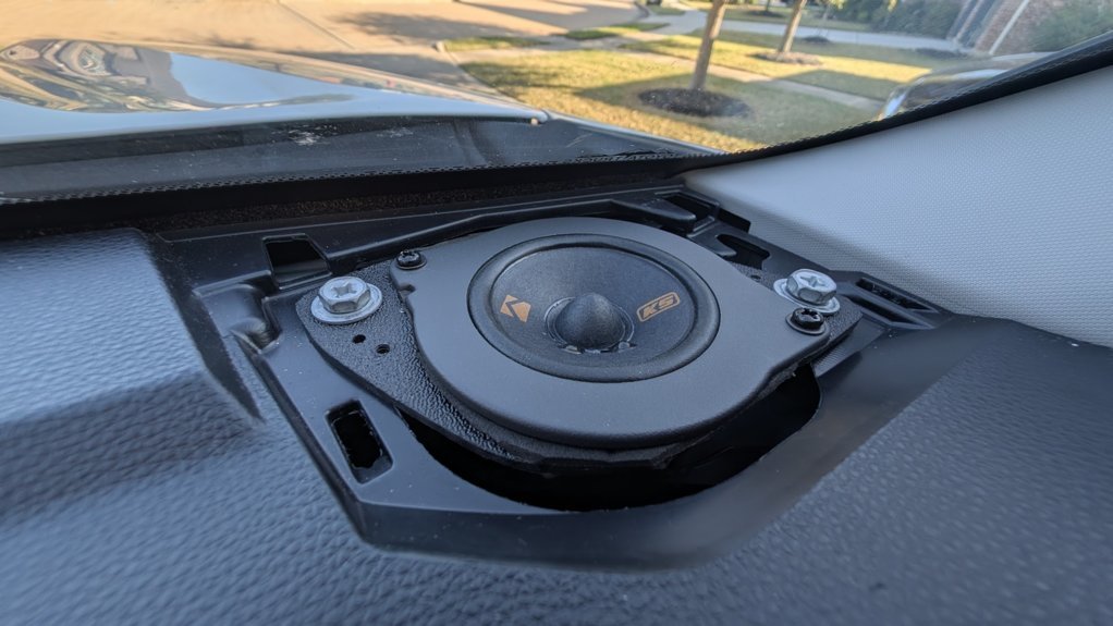

    3- Changed out the dash speakers from the pioneer to kicker 2.75's. This was a small improvement as well and made the overall sound warmer, but I still wasn't fully satisfied.

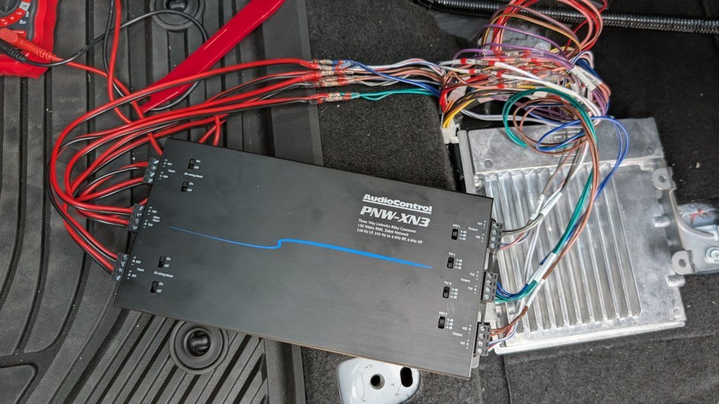

    5 - Installed an Audio Control PNW-XN3 3 way crossover on the front tweeters, L&R Dash speakers, and front door woofers. This made the most improvement and finally made it sound like a cohesive system. The door speakers are not full range but the factory amp crosses them over at to high a frequency (IMHO) causing them to reproduce frequencies they really don't sound at. The crossover also has built in -3 and -6 DB lpads for the highs and mids. I set these at -6 for the highs, and -3 for the mids which allowed them to mesh more nicely with the woofers. As an unintended side benefit, I was able to increase the levels on the EQ in the head unit increasing the level of all the frequencies across the board bringing more mid bass and a overall richer sound quality. The below pic is an in process one. I don't have a pic of its temporary home until I decide if I want to go further.
    I have PAC integration kit and an infinity 8 channel amplifier sitting on my bench in the garage, but I am not sure I am ready to install them yet. I also have infinity reference 6X9's as well that I am considering installing. I will update this thread again if I take it to the next step and install the PAC Kit, amp, and infinity 6x9s.
    Ultimately, if someone where looking to make a significant upgrade without having to tap into/bypass the factory system, I highly recommend components in the rear with a proper 2 way crossover (many of the ones that come with the set don't have a real low pass filter), components in the front setting up the fronts as a three way system using the PNW crossover, and the addition of the beat sonic DSP*.
