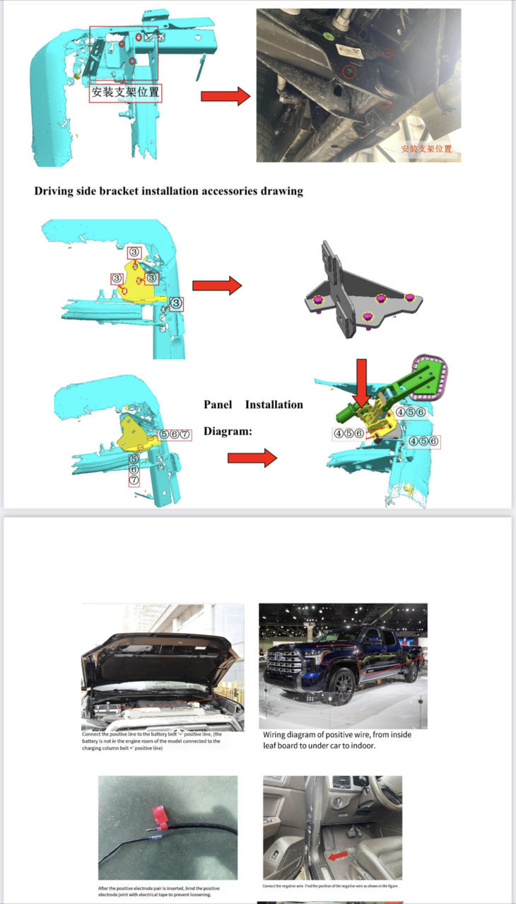

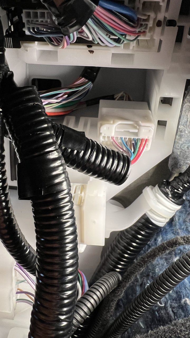

    just installed automatic bed step onto my Tundra 2023 1794.
    The installation instruction given to me by a Chinese guy and it worked perfect
    I have attached the instruction below
    you need to find white plug on the side on the bottom can panel.should have blue and white cable in the middle of the socket

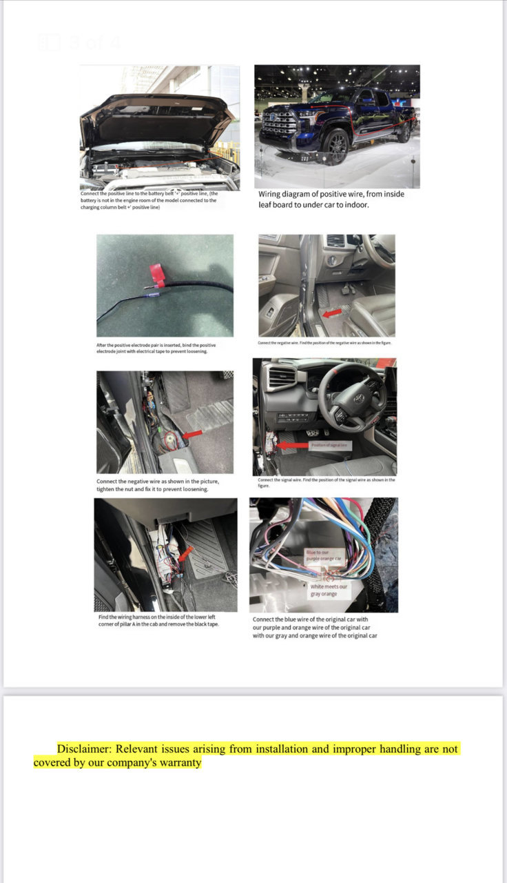

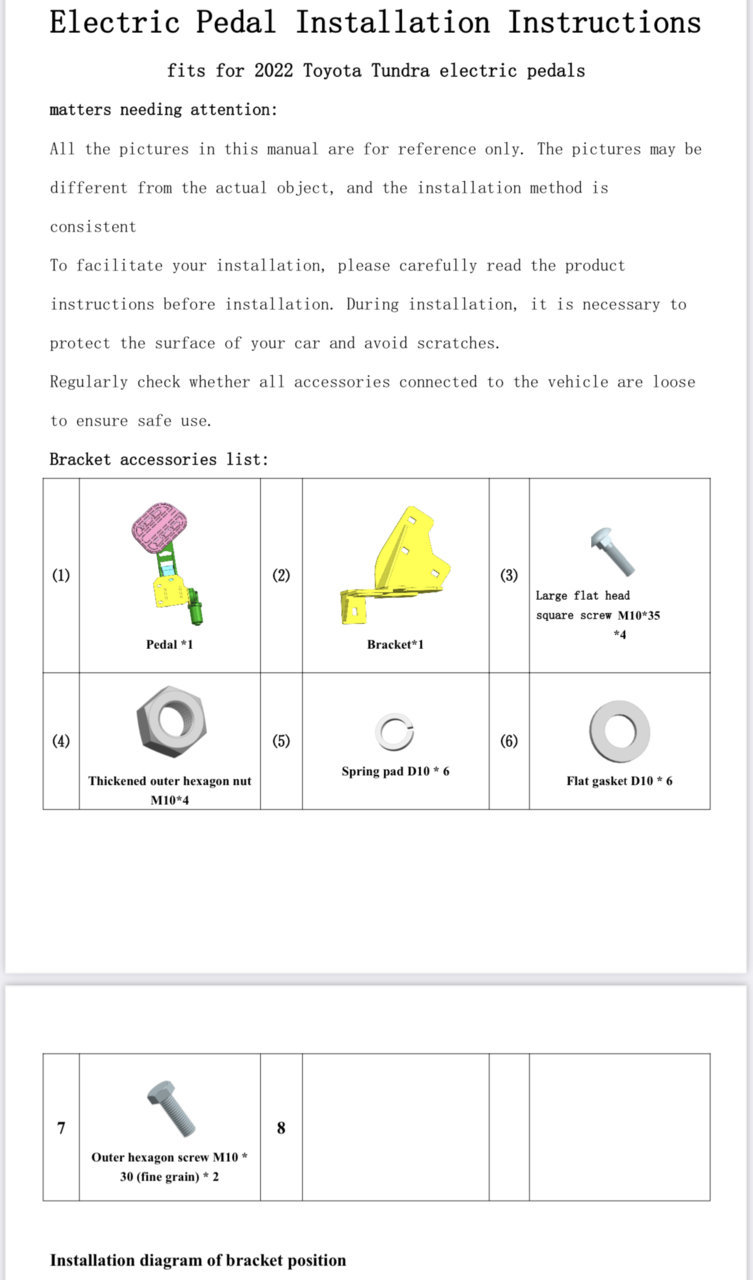

    Dont worry I have snapshot for that instruction too F8A35F3C-395A-421E-8AED-20EE96355C74.jpg9DCF03BA-D3C9-4919-AEBD-C4DCF961A298.jpg

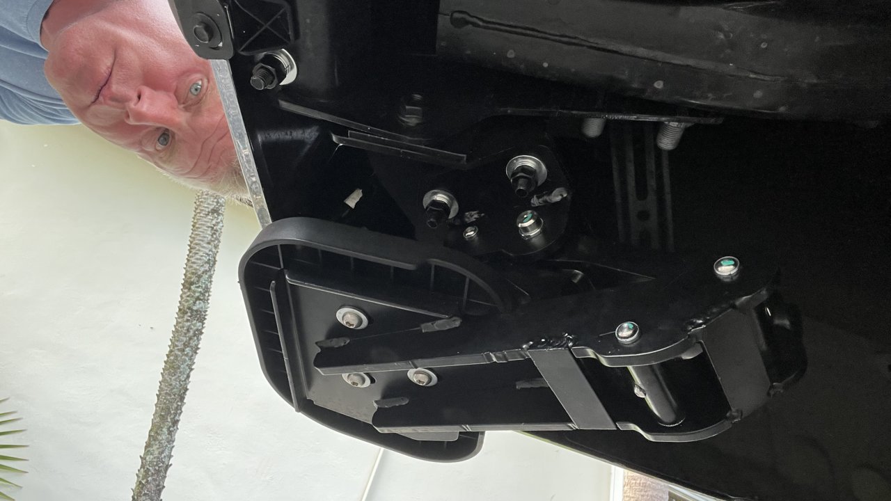

    So. I bought this bedstep off of eBay. Offered the $400 and accepted. I got it in less than a week from china. This thing is well built and sturdy. Very easy to install. The directions suck and pretty useless if you’re trying to find the right harness to hook up trigger circuit. The seller on eBay was useless. I sent several messages and they never responded even once. I have the whole kit installed and only needed the correct factory wiring to tie into. At this point the step was useless and I started a return with eBay. As a last resort I pulled the power step ecu out and took the cover off to see if I could see what the circuitry looked like for a clue to the voltage source (electrician) luckily the OEM company was written on the circuit board and I was able to contact them directly. The company is AKM4x4. They are a Chinese 4x4 supplier. I was able to talk to tech support over WhatsApp and took two seconds to find the proper tie-in
    This step works perfect and looks and acts just like OEM step.

    Yukonrider…. The step works automatically with either the key fob, tailgate handle or tail light switch. I have been using it for two weeks now and I am super happy. The instructions from the seller are horrible but it is super easy to install if you have any mechanical aptitude. Finding the right wire to connect to was impossible until I found the parent company and they sent me pics over WhatsApp posted a couple of pics but I couldn’t upload video of operation

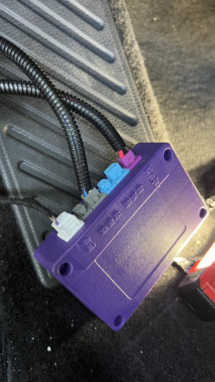

    I have a couple of pictures and a Video that will not upload to this forum for some reason. It might be a format issue. The purple box is the control module and mounts right at the connection point behind the left hand kick panel.
