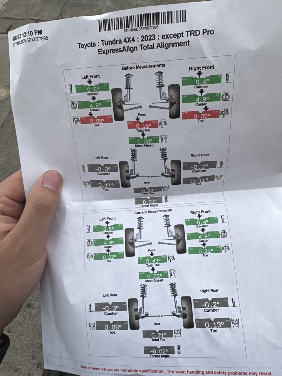

    Just bought my tundra .but when I pull the wheel straight.it turn to the left .anyone can help to see the numbers?

    Those numbers look good.
    Perhaps try rotating the wheels and tires. And confirm the air pressure is correct.
    Also check to see if the left brake calliper is dragging. A thermal gun can measure the brake temps. If one is higher, it could be the reason for the pulling.

    I had a very similar problem on my 2023 1794. I had to have the steering wheel about 5 deg to the left to drive straight. Took it to the dealer and they adjusted Toe-in and now it's perfect. I'm sure it came that way from the factory.
    Also note that there was a TSB just a month ago for a similar problem, where Toyota adjusted the alignment due to premature tire wear, maybe a pull to one side too. I'm glad that I waited to get this done and by chance waited long enough for that TSB to be released...thus updated alignment.
