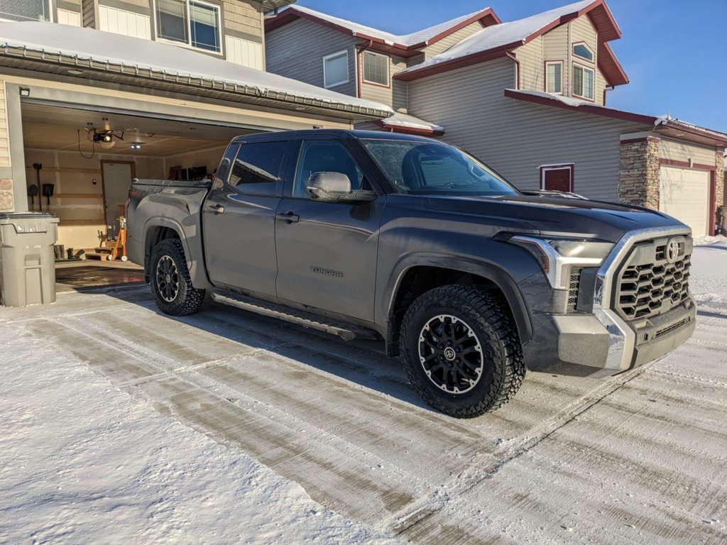

    Super happy with my Falken Wildpeaks. OEM wheels and suspension.

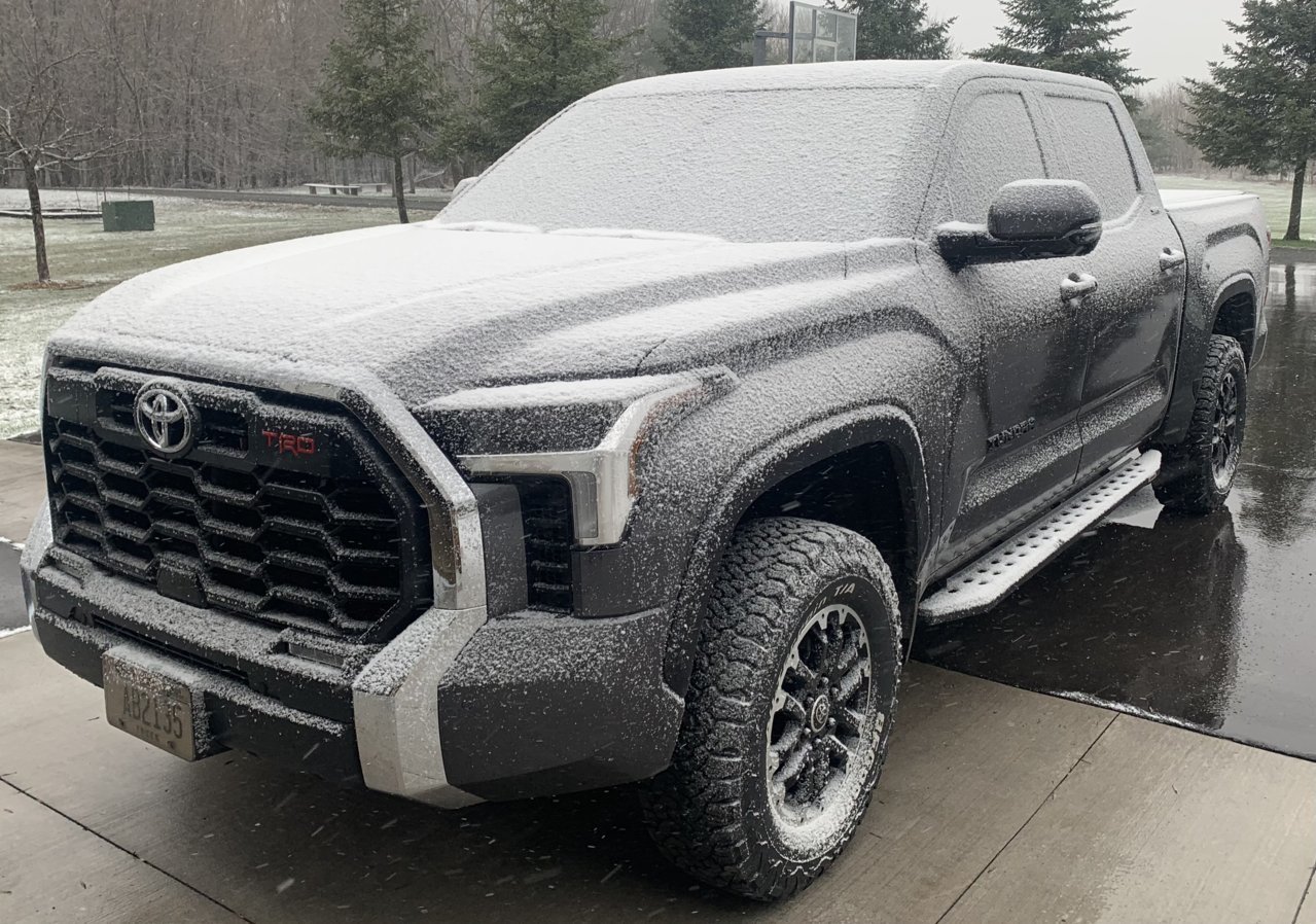

    I am super happy with the BFG KO’s. Excellent snow tire. They are a little rougher than stock but not much. Have 1.25” Bora spacers on too. 51344DB7-84DF-45D4-8B8D-8EC926E136EF.jpg

    BTW, tire size is 275 70 18 and they were on for a while before the small lift was put in. Fit just great.

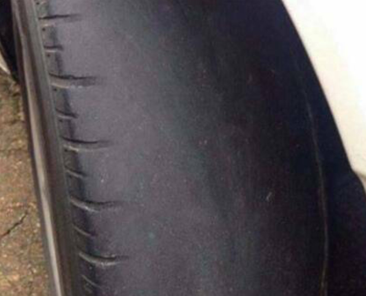

    I just finished sanding my tires so that my TRD. Hopefully it will ride smoother. IMG_4947.jpg

    should be pretty smooth on the highway now!
