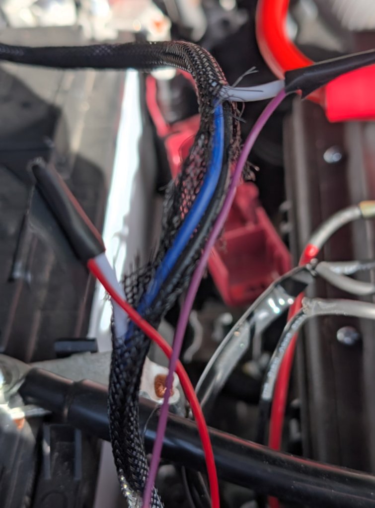

    So I've read this thread and the other one that 99ways2die posted about his install multiple times as well as searched google and other forums and I'm needing some help. I already have my light bar working with a Cali Raised switch inside the cab and it works like a normal on off switch currently. I have now installed the Canm8 with the wireless reader in the correct spot behind the glove box. I ran the wires coming from the actual Canm8 through a grommet located behind the battery like you suggested.
    I have a few questions though, the Canm8 directions that are on their site and their app show like 12 wires coming from the unit and they have all kinds of different things they do(labeled), which I'm assuming I don't need to mess with except a couple since I have the wireless reader? I'm assuming I just need to use the ground wire provided and ground it, give it 12v somewhere from the fuse box(constant or an accessory) and then use the Grey wire (High Beam Output) and attach it to my Cali Raised switch and I should be in business? Do I need to add wire to the grey wire(output from Canm8) seeing how its pretty short and run it back into my cab and hook it to the Cali switch or can I splice into the wire that is already built into my light bars wiring harness that currently comes from the switch and goes to the relay?
    It runs right by my battery and fuse box and would be easy to splice into right there instead of running a new single wire into the cab. I believe it would be the blue wire on my current light bars harness that I would be tapping into. It’s a 3 wire harness going to the switch. I'm on the home stretch of this install so thanks for the write ups and help.
