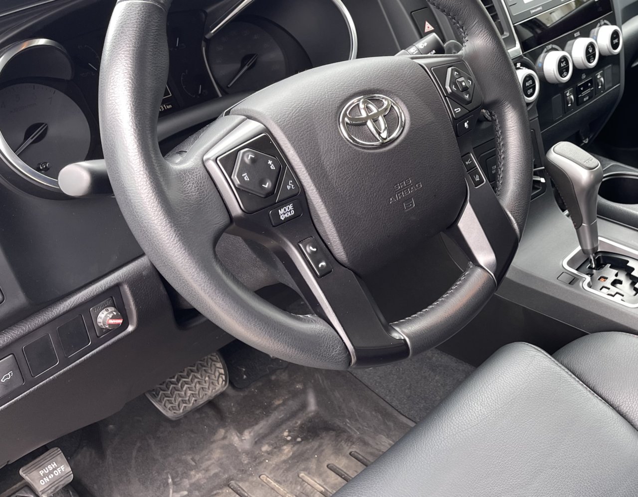

    Also, installed a REDARC trailer brake controller, mounted on the left switch panel (that I changed for one with 5 switch holes vice the stock 3 plus storage).
    REDARC controller works great and makes towing my other toy a breeze.

    just curious, how was install for REDARC? where does it hook up to? I am thinking about it as well, since I tow my bikes to the track all the time...
  15. Jan 4, 2023 at 6:13 PM
    EliSeq
    EliSeq [OP] New Member
    Jul 30, 2021
    #66173
    55
    Hey Mike, it's pretty straight forward, as the Sequoias already come wired for a Trailer Brake Controller from the factory. The electrical connection for the TBC is under the kick panel on the driver's side (above the foot rest for the drivers left foot.) This video is really helpful. https://www.youtube.com/watch?v=4Kn2O4eR7R8
    You will need a specific Sequoia cable to connect the REDARC TBC to the Sequoia.Here's the list of parts from 4wheelparts.com, (note that these are Canadian prices).
    Hopefully this helps. The REDARC works amazingly well and I have no complaints. I've towed my empty 18ft trailer (1400lbs) all the way to my 6500lb boat/trailer combo.
