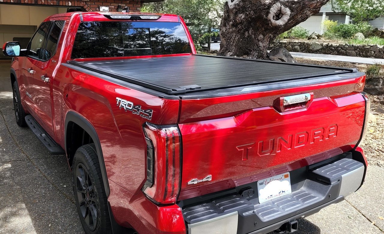

    I thought I would share my install of the Retrax ProXR on my 22 today.
    HEADLINES:
    => I really like this cover... many advantages over folding ones. Very sturdy, rolls smoothly. Very secure.
    => Install went very smoothly and there were no fitment issues. Took about 2 hours but could probably do a second one in under an hour.

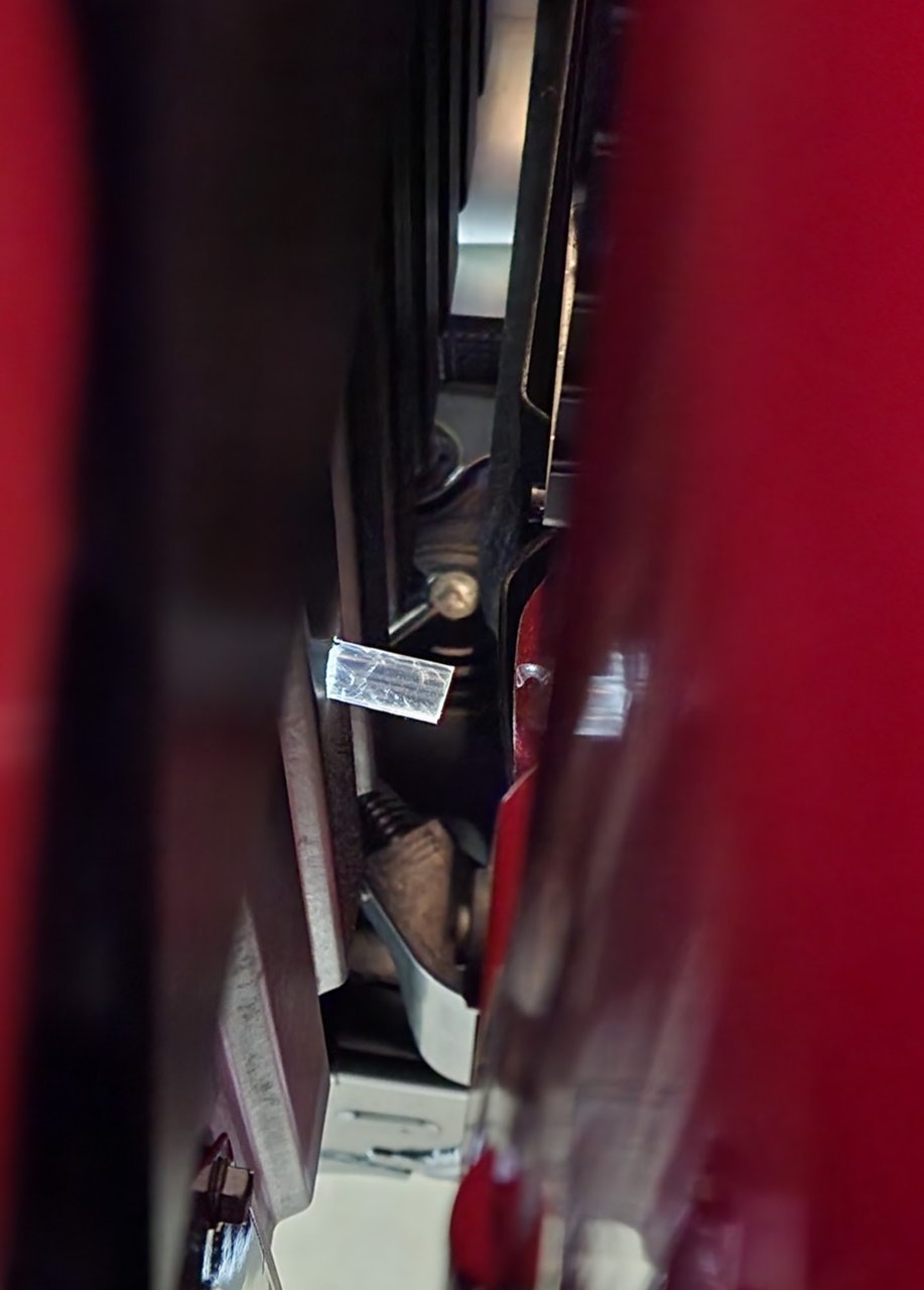

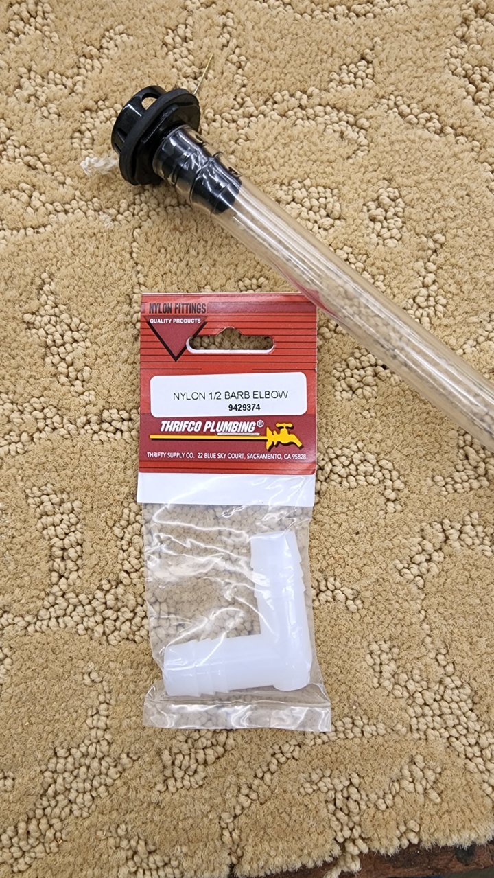

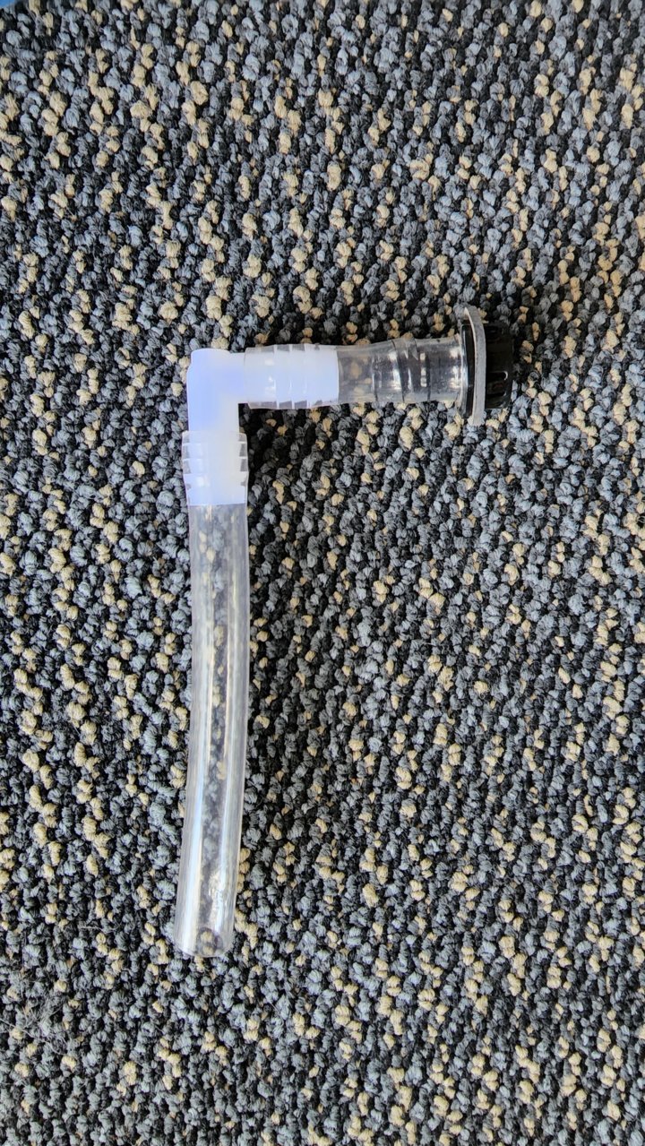

    2. I decided to modify the drip tubes in order to minimize the chance of damaging them and to maximize the usable space under the Retrax canister. I bought some nylon 1/2" elbows at the hardware store and routed the tubes out the front of the bed, as high as possible. You need to use a 9/16" bit for the tube hole, but drill a pilot hole first. Watch out where you drill, there are some interference points between the bed and the cab you need to avoid. The supplied tubing fit tight on the barbed elbows, but I wrapped them with electrical tape so I didn't have to look at the white plastic. By doing this mod I now have 7" of clear space all the way to the front of the bed... plenty of room for sheets of plywood or drywall.

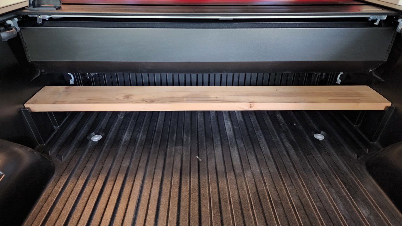

    3. I cut a redwood 2x8 to 62" and have set that in the bed wall detents as protection for the Retrax canister...in case I have to slam on my brakes and the cargo comes hurtling forward. It is easy to remove when I want that space for storage.

    What made you decide to use redwood for the board?

    Looks great. I have a similar Pace Edwards retract on my Tacoma and I love it. One thing I would change on yours is to replace the electrical tape on the hose fittings with screw or spring clamps, zip ties, or best of all Oetiker clamps.

    I thought about that, but since those buggers went on the barbed fitting so damn tight (I warmed the tubing a bit to get them to go on), and any water in the tubing will be at zero psi, I did not see a need for clamps or zip ties. Once they are on you could not pull that tubing off the barbed fittings. The tape is purely cosmetic.

    That is what I had on hand! (other than the fact that is is rot resistant to boot)
    The bed detents fit any 2x8 (7.5" wide) board
