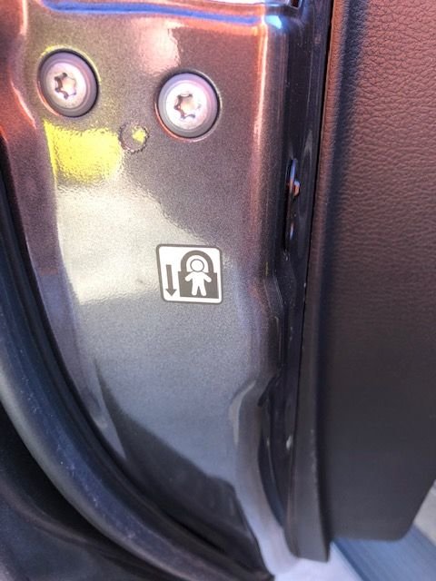

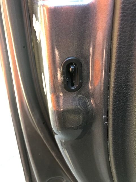

    I don't know if this is the problem, but make sure your child lock is not engaged on that door.
    I have a 2014 double cab, yours might look a little different.

    I looked at that and it is off.
