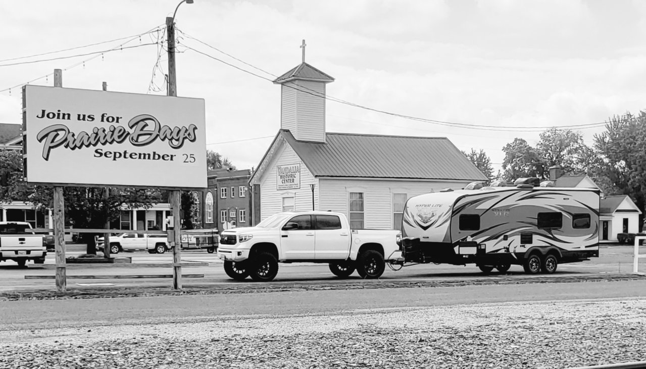

    TOWMIGO...Firestone airbags, daystar cradles, fabricated aluminum spacer plate under cradle and fabricated axle bracket extensions with my father in-law. Went with manual inflation valves and installed them in the fuel hatch housing.
