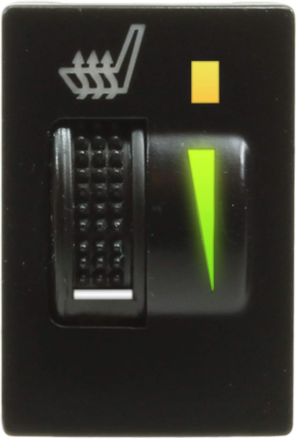

    He . Does anyone know if Toyota does or has anyone added rear seat heat. 2020 crewmax sr5
    What is best?
    What do guys like / not like about install
    Does the wiring get in way of aftermarket storage
    Where did power come from.
    IF there is a thread I can't find it.
    Cheers

    Not specific to the rears, but the info would be the same.
    https://www.tundras.com/threads/anyone-add-heated-seats-to-gen-3.8217/
    https://www.tundras.com/threads/what-are-my-aftermarket-heated-seat-options.21217/
    https://www.tundras.com/threads/seat-heater-install-on-2014-tundra.20930/
    I’ve considered doing it on my truck and mounting the buttons on either side of the 12v plug (there’s enough room in the back empty space of the console to stash the fuses and relays). I would pull power directly from the primary ignition wire or battery though (battery if you have relays set up that use a trigger wire attached to ignition or accessory so you don’t have seat heater draining your battery while you have the truck off) - routed through one of the engine bay grommets, and then down the gutter, under the front seat to the console, and then back out the same way and down the gutter to get to the rear seats. Worst part is going to be pulling the upholstery off the seats and putting it back on.

    I didn’t have to pull any of the leather covering off my rear seats. I was able to slide the heating pads in by only undoing the elastic straps that hold the covering.
