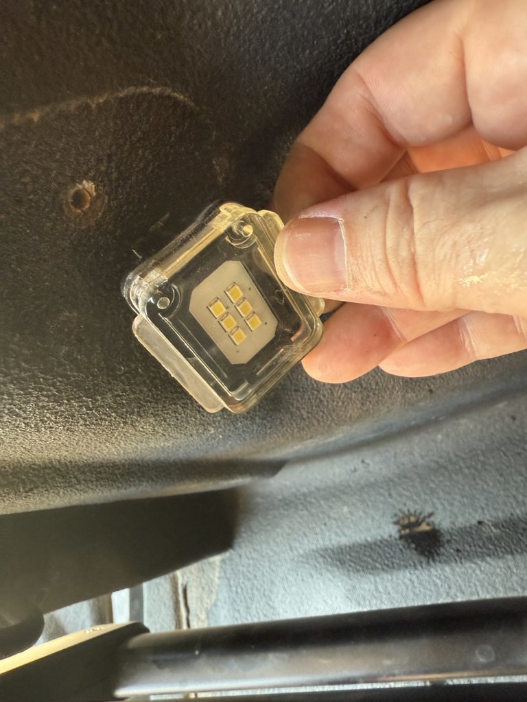

    One of my bed lights on my 2020 Tundra SR5 Crewmax isn't working. What is the part number for the replacement parts? I see lots of clones on Amazon but not sure if those will take the same power connector as the OEM?

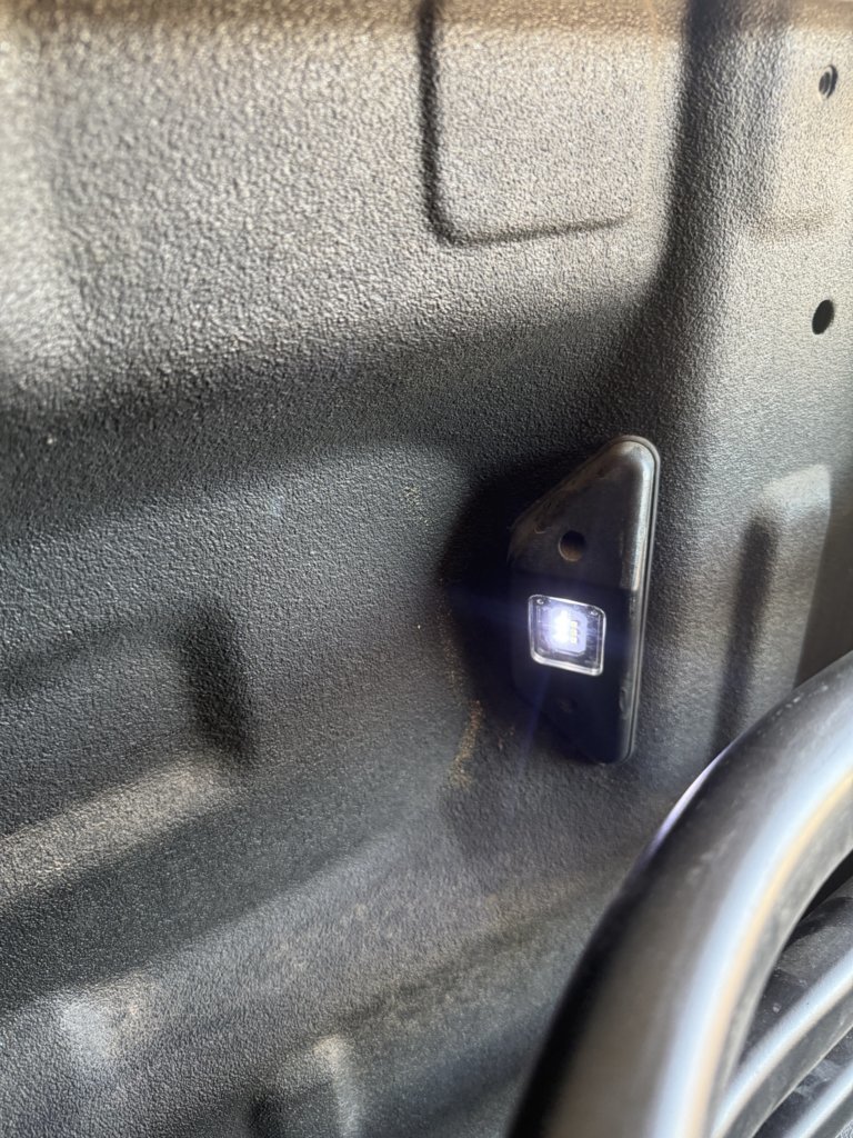

    You're better off replacing them with something better.
    You've already got the wiring done.
    I used some cheapo Amazon lights and tapped into the existing bed light wiring..
    Amazon.com: Xprite White Truck Pickup Bed Light Kit, 24 Led Cargo Rock Lighting Kits w/Switch for Van Off-Road Under Car, Side Marker, Foot Wells, Rail Lights - 8 PCS : Automotive
    From this.
    I had to put one in front because of my swingcase.
    To this..
    Lucid Tundra likes this.

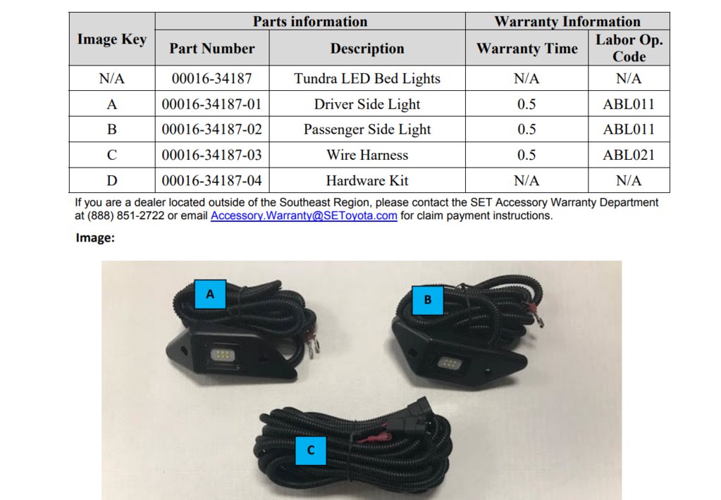

    My truck didn't come with bed lights, so I installed OEM, then the ones pictured.
    00016-34187inst-20Tundra.pdf
    This is where you tap the power and ground into the cargo light circuit.
    Cargo light connector
    Hope that helps..
