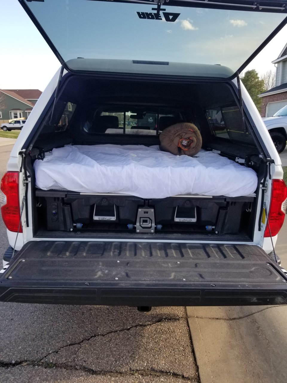

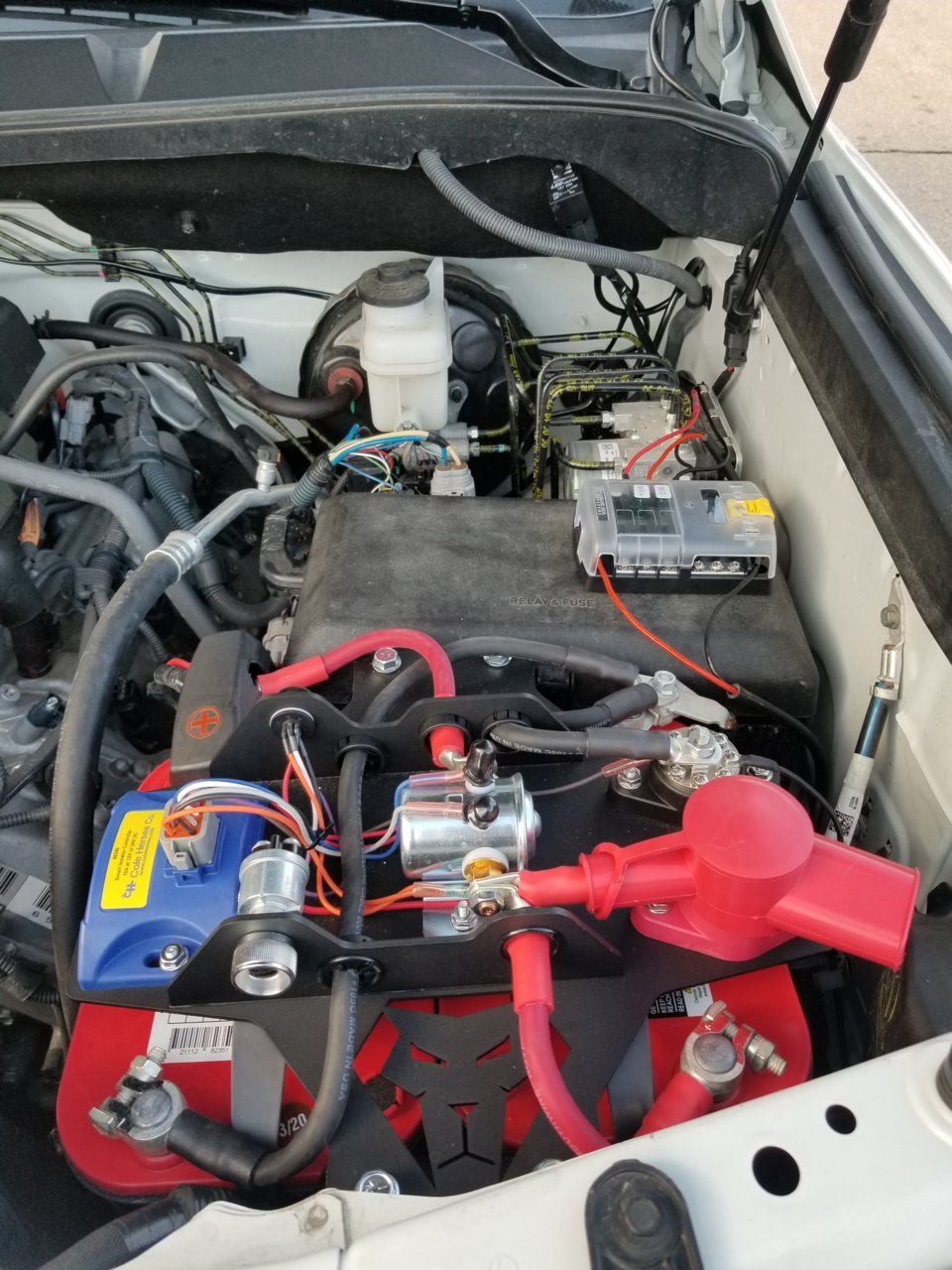

    Genesis Offroad dual battery set up
    Decked storage system
    Tochata 5 inch foam mattress

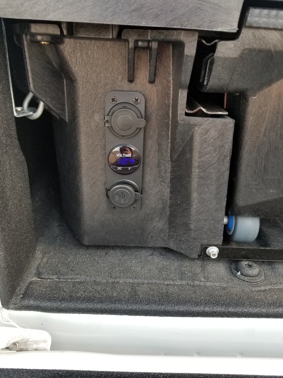

    12v power bank and aux battery voltage indicator mounted in Decked system
    Ditch lights from Caliraised
    ARE high rise topper20200318_175941.jpg 20200404_171831.jpg 20200404_172040.jpg 20200404_172046.jpg 20200404_172145.jpg 20200404_171927.jpg

    Loving the power bank set up in your DECKED system!! If you can share some instal info we know a lot of people are interested in the best way to set that up.

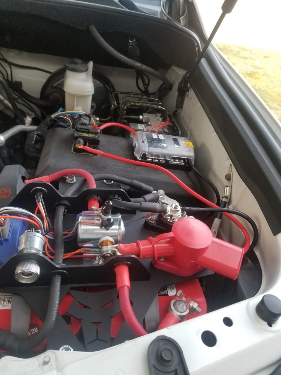

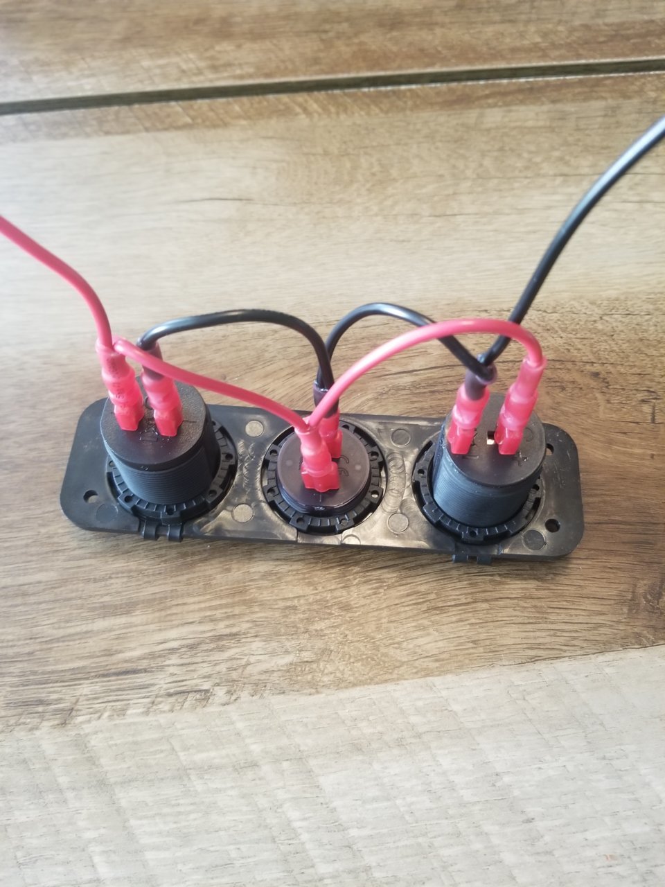

    I will add some more info and try to do a more in depth write up when I have time, but toss some details out now. I installed the dual battery set up and a 6 space fuse block. Since the pictures above I added a 100 amp breaker between the auxiliary battery and the fuse block and changed the wires there to 8 gauge wire. The breaker is 100 amps so if the total draw on my fuse block is over that it will trip the breaker. I mounted the breaker and the fuse block to the cover over the stock fuse block with exterior rated double sided mounting tape available at Home Depot/ Lowe's. I used some 14 gauge wire that is bonded inside of a protective cover designed for auto/ marine use and ran that from the fuse block, under the truck along the driver's side frame to the bed. Start running it from the truck bed though. I went through the small hole already in the bed just above where the tailgate side on the driver side ammo can is located. I ran the wire into the ammo can corner through the drain hole. I used a drill and a paddle bit and then a sharp utility knife to notch out a hole for the 12V power receptacle. Go slow and take out a little at a time and continue test fitting. Don't want to mess up this hole in the Decked system. The receptacle I bought was not pre-wired so I wired it with some connectors, red and black wire, and heat shrunk all of the connections. I used the provided screws to attach the receptacle to the Decked surface. The voltage meter display shows my power level on my auxiliary battery. I ran this on a 15 amp fuse.

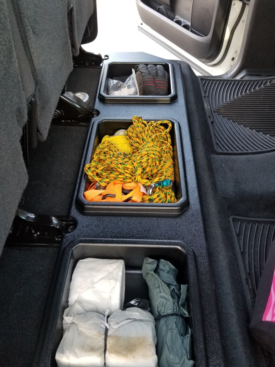

    That explains the nice storage under the back seat. Why they chose not to do something similar on the CM baffles me.

    Toyota should have made the under seat storage standard. At least there was an easy mod to get some.
