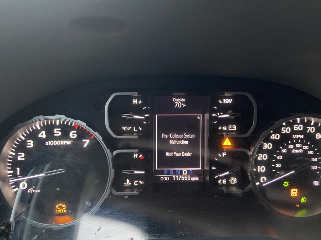

    Hi all! Looking for some guidance. I Have a 2019 tundra literally 1 payment away and I get the pre-collision malfunction issue. Took it to the dealer and they looked at me like I was talking in Chinese. They saw the message and said it will be 199 for a diagnostic check. Has anyone been able to fix this issue without the dealership? No alterations or tint. Truck is stock SR5 with 117k miles. Would appreciate the help.
