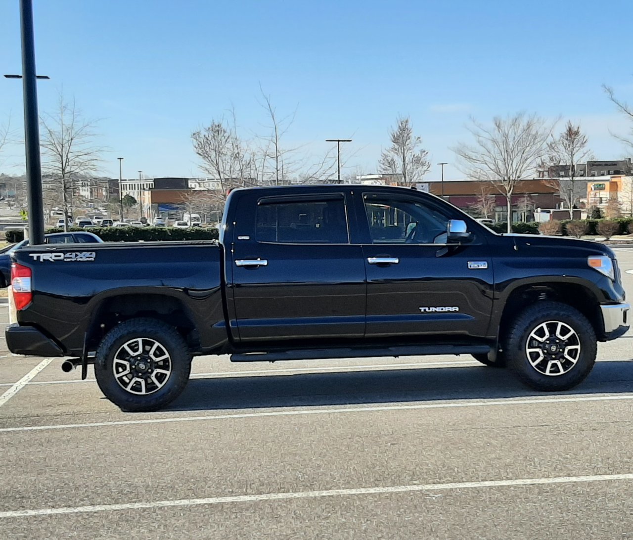

    So what you are planning is about where my truck is at. I have mine set at 2 inch lift front, 1 inch lift rear. Here is how the setup looks. The mods really helped with drivability and handling. She runs tight and handles really well for a large vehicle. A few lbs of air pressure changes can take the truck from a more soft ride to quite sporty. 2-1 lift and 27570s-2.jpg

    Thank you for the detailed answer! I only tow a small utility trailer for now. Once I get a bigger trailer I’ll look into the RAS.
    I am going to pick up a carrier bearing drop though since I’m doing a 1” rear lift.
    Your truck looks good! What size tires are you running?

    running 275/70-18 Wildpeaks, which I also ran (and they fit great) when stock. There is enough room set at 2 inches to clear 295-70-18 or 285/75-18s
