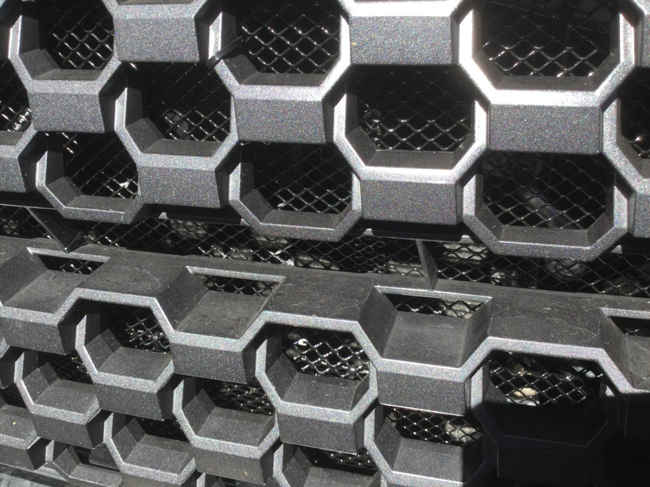

    Here is my honeycomb with gutter guard. I do this with all my vehicles.

    Working on it :-)
    How did you attach that? Is the gutter guard in 6" strips?

    Yes it is. I screwed it in on the edges and then used small zipties every few inches to suck it up to the honeycomb. You can actually see one in that pic. Its an easy 15 min job. I use tin snips to cut around the TSS sensor and to cut the excess off.

    Looks like it's attached with zip ties. I can see 2 in the pics. Wonder if it's attached with anything else.

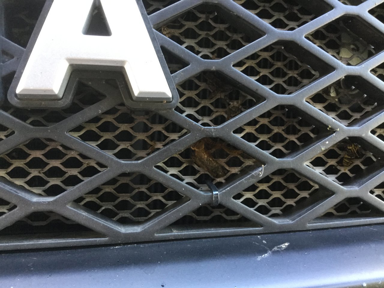

    They make the guard in a silver as well. Here is my FJ grille.

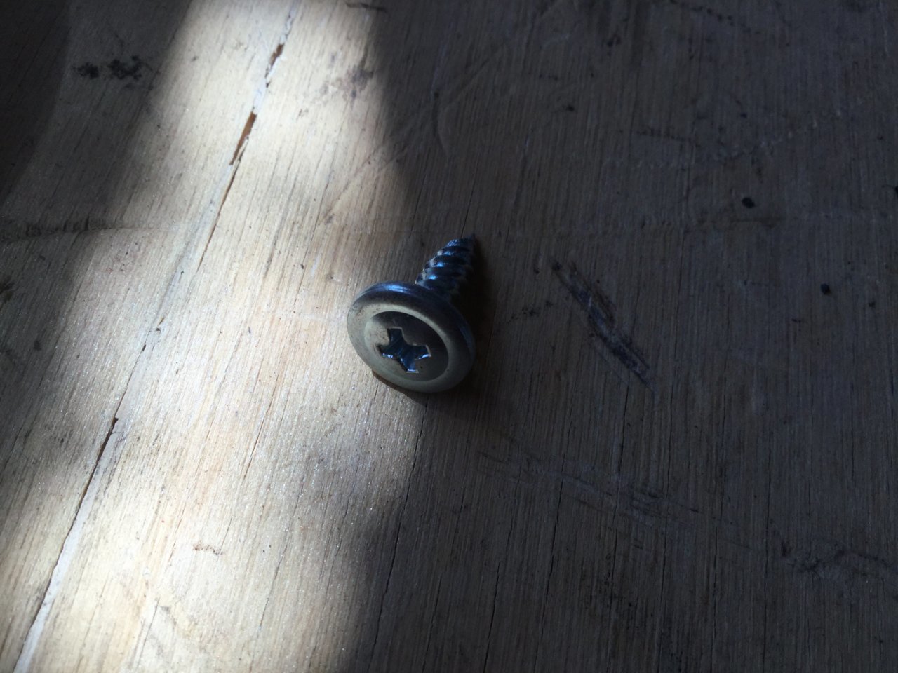

    And here is the screws I use. And i try and hide the seem behind one of the rows and zip tie them together.

    Appreciate it. I think I will need to still do a screen with smaller holes after seeing the size of the chips in the radiator. How does your radiator look at this point?

    Condensor and radiator looks like new. But the real test is the FJ. Had it since new and installed the gutter guard the day I bought it. Has done 100k with 2 trips to alaska(with 100s of miles on gravel and sanded roads)and at least a dozen trips across the lower 48. Have had rocks break 5 windshields. The condensor and radiator looks perfect.
    I would be concerned that smaller holes could effect air flow and cooling in hot climates.
