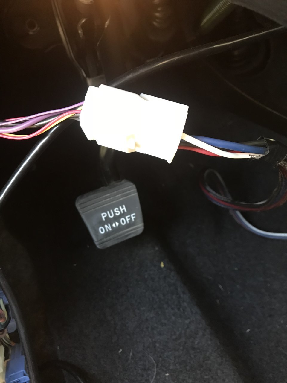

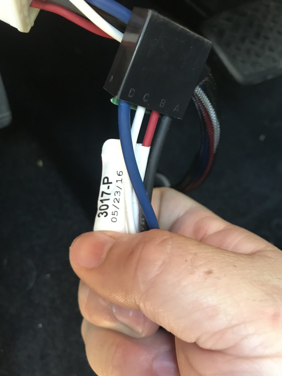

    I think I found it under the kick panel the pins all line up.046F6086-7259-4D6D-A40C-2DC5524EB4C6.jpg
    I unhooked turned the key over and it shows the tire warning but no brake controller issue. If I unplug the ibc it tells me their is a fault
    Giving it a shot . Has this controller and harness from my 3rd gent tacoma.
    Showing the esp console. (Irritated the factory system sucks!)4D37C1CD-57FD-4374-AF4D-3A2CDBEA3BF1.jpg
    No trailer connected and tells me their is a fault.97DA441F-6F66-457A-AD11-EDCA9091A5AD.jpg
    Apply trailer brakes manually and it overrides.
    Any insight? This is an 18 cm limited.

    Did you keep the IBC intact or you remove/disable it? I might just buy a Prodigy RF Brake controller as well.

    I would test with a volt meter and make sure the pins on both plugs line up to what that circuit is supposed to be.
