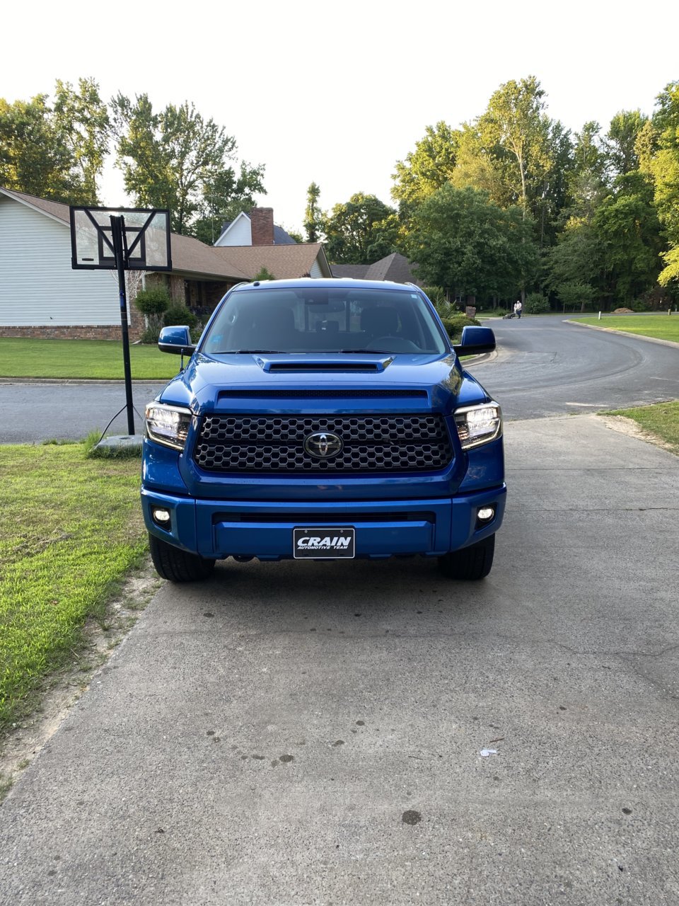

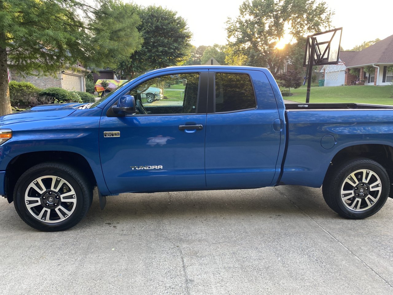

    I have had my 2018 Tundra TRD Sport for a week now, have ordered some stuff for it, but looking for suggestions on lift size. Don’t want it too tall so I was thinking 3 to 4 inches. First 4wd to own.8B04D25B-D599-47A8-92C9-22DFB5C2D0AF.jpg90EDCF9E-B58F-47A8-89C7-B32415778501.jpg

    Welcome to the Forum.
    There's lots of discussion on lifts, and some vendors on here that can provide guidance as well. You should know that lifting 3" or more you will likely have to get aftermarket UCAs to get alignments back in spec, and might need a diff drop as well. If you are going to go with new wheels and tires you'll want to figure out what offset you want, and if you are willing to :sawzall: and :welder: to make them fit.
    A place to start, maybe? https://www.tundras.com/threads/guide-different-types-of-lifts.546/

    That’s a gorgeous looking truck you got there OP!

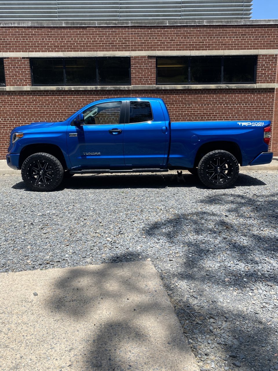

    Ended up just having the front leveled 2-1/2”, got Nitto Ridge Grapplers and Fuel Maverick satin black wheels with milling and step bars.1C95D82B-041D-4120-8934-C1FFAB6EF95C.jpg

    Sharp rig. Tint the front windows a bit and it'll really pop!
    How do u like the nittos?

    Looks great.
