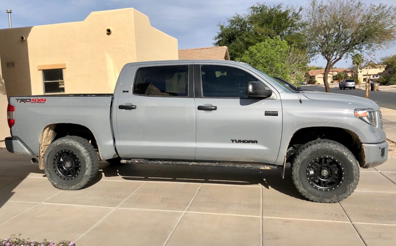

    The dealer did coil overs for me, raising the Front 3” and leaving the back the way it was.
    My radar works fine.
    Stroke250 likes this.

    any pictures of your truck from the side ?
