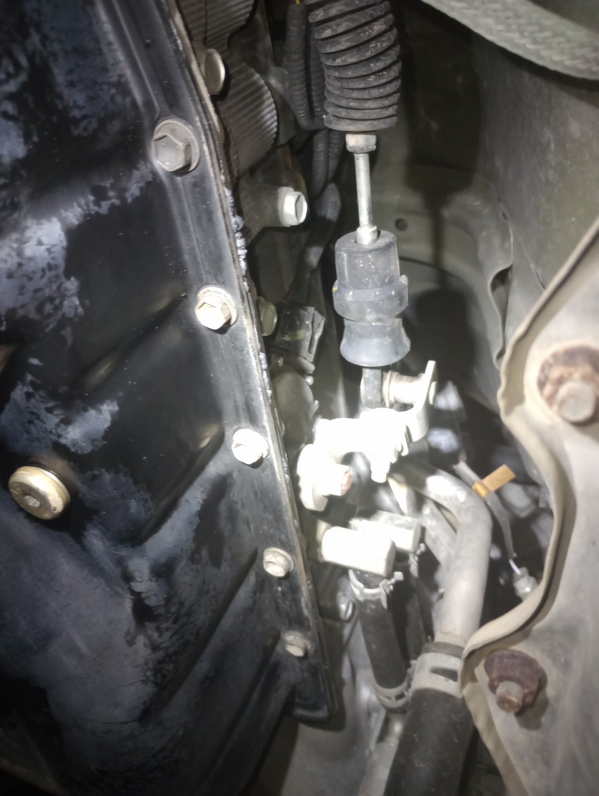

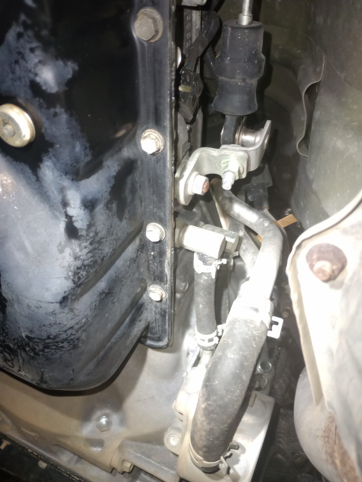

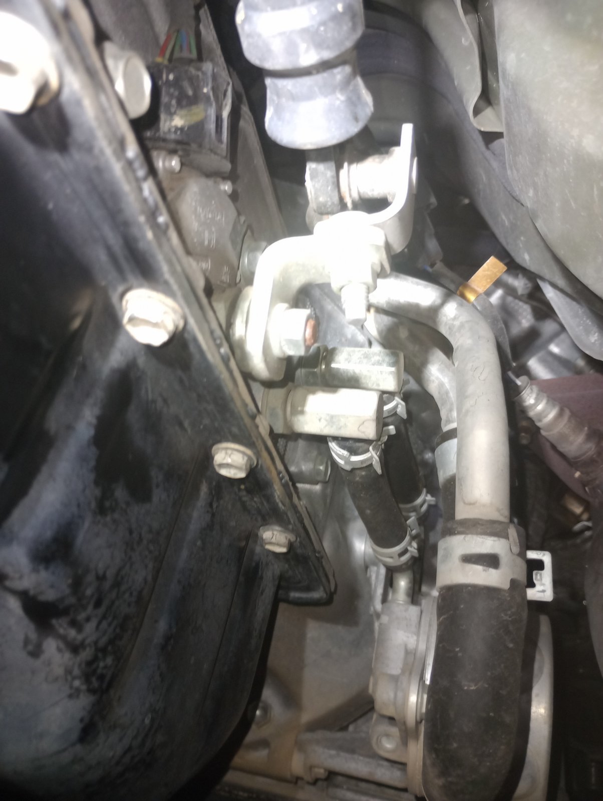

    I have looked and looked and can not find the thermostat on transmission to bypass so I can check the fluid level. Please help! I have a 2018 Tundra 4x2 SR5. I attached pictures also

    Florida
    Thanks because you dont have one.

    Ok all the videos I have saw for my model says you have to pin it before you can get an accurate check of your transmission fluid. So did the previous owner may e put in a bypass kit? Either way, since it don't have one I can check transmission fluid accurately as long as tranny temp is around 112-120? Thanks.

    You dont have a bypass kit. Your is OEM. I believe 18 was the first year Toyota did away with the trans cooler. Yes you can do a trans check as you would normally since you dont have to pin the t-stat open, since you dont have one.

    He's must be one of those that was towards the end then. No cooler on his or no t-stat to be more accurate. No pic of the from of the truck.

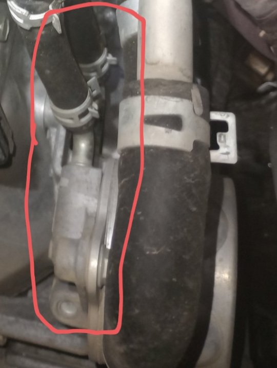

    I may be mistaken but it looks like the warming puck is attached to something resembling the thermostat.

    The liquid to liquid trans cooler/warmer doesn't use a thermostat.
