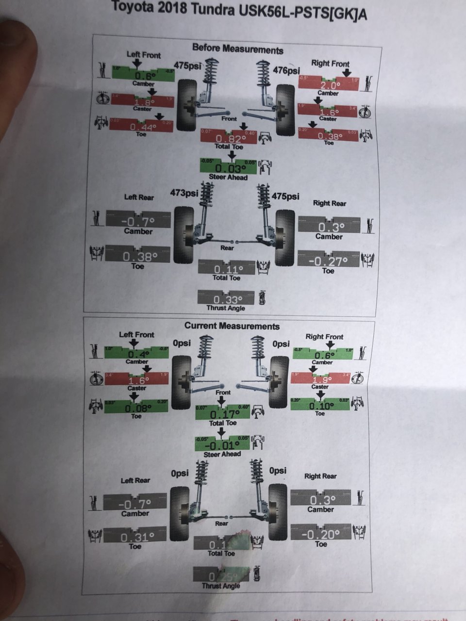

    Here is the alignment sheet from the dealer. The tech said the camber was maxed out.

    Yikes. That is way off. You will most likely need new adjustable UCAs in order to get back to a proper alignment.

    Maybe he said the caster was maxed out. I don’t recall. At any rate when I look at the truck from the front the top of the wheels are out wider than the bottom of the wheels.

    Your caster, camber, and toe are all wrong. Toe is easy to fix. But caster and camber cannot be corrected without adjustable UCAs.

    What should they be and should I be able to obtain these numbers without major surgery and expensive parts.i was under the impression that the coil spacer kits were pretty common and didn’t require additional parts.

    What is the proper alignment specs. Who comes up with these numbers and where can I verify them.

    Camber L- 0.0-0.2. R - same
    Caster L- 2.1-2.4 R- 2.4-2.7
    Toe - 0.5 - 0.7 per side w/no more than .15 Total toe.
    The numbers come from data collected over the years of Tundras being in production and what works in lifted applications.
