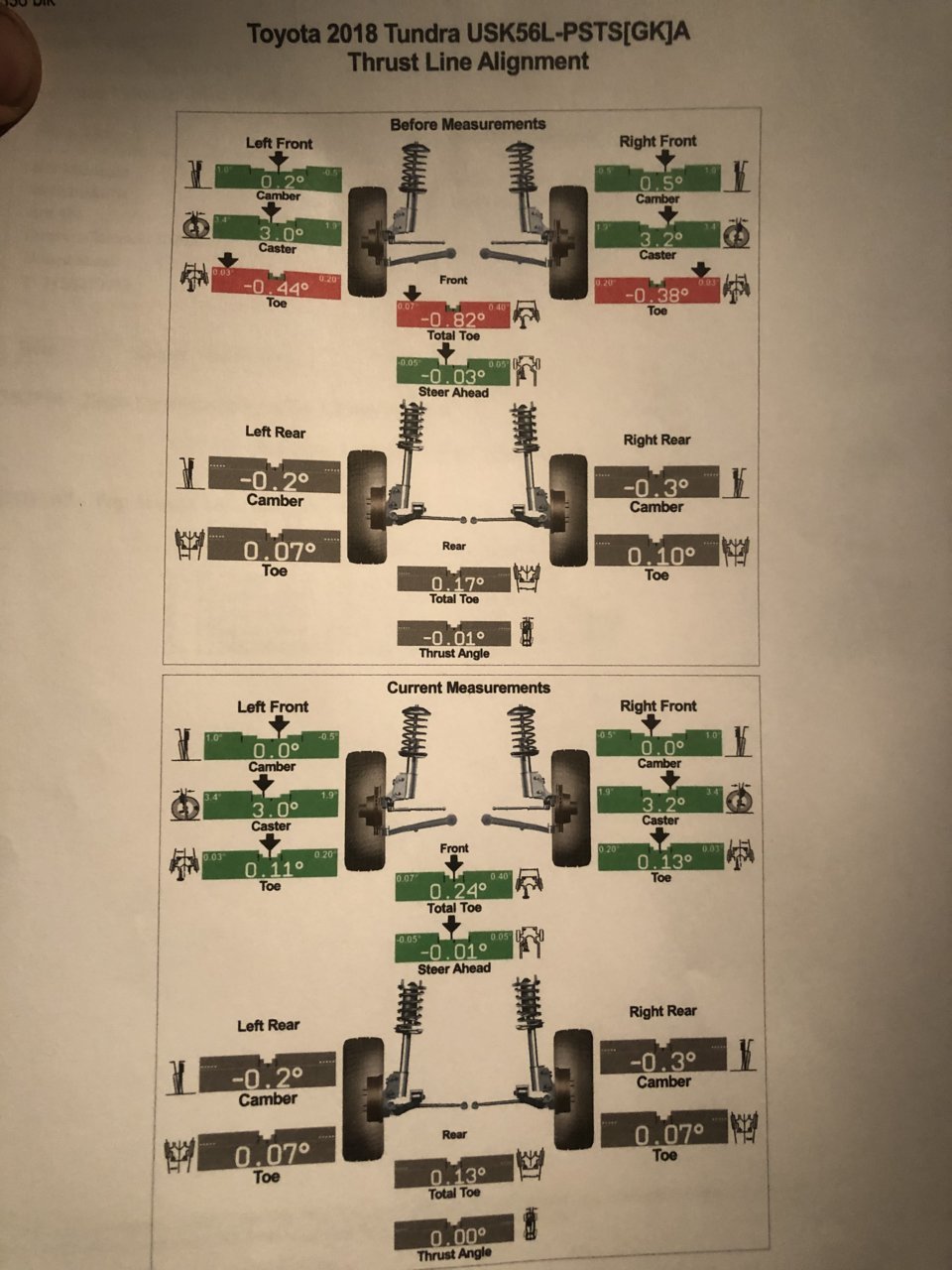

    And thennnnnn, a week from today she’ll be dropped off at Toytec for new shoes and an alignment.

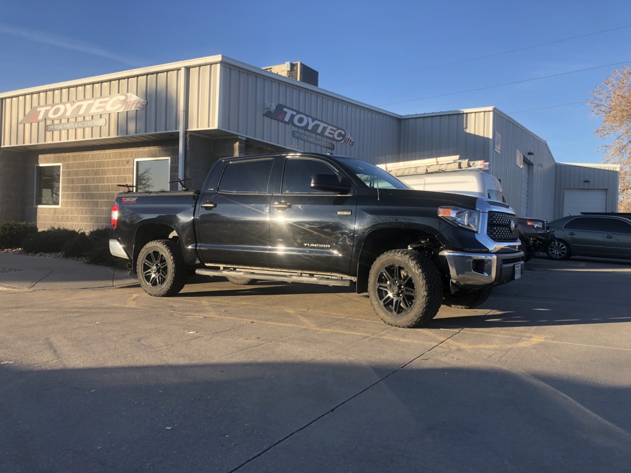

    Got it done in a buddies driveway. New shoes on Wednesday

    New lift only has maybe 20 miles on it. And obviously the measurements were taken from the ground and not the center of the hub. New wheels and tires go on Wednesday...so i'll re-evaluate what shims are needed at that point.
    Stock
    FL: 37 1/8" FR: 37 1/4"
    RL: 39" RR: 39"
    After coilovers at 2.5" setting, 1" shackles in the rear
    FL: 39 1/2" FR: 40 1/4"
    RL: 40 1/4" RR: 40 3/4"

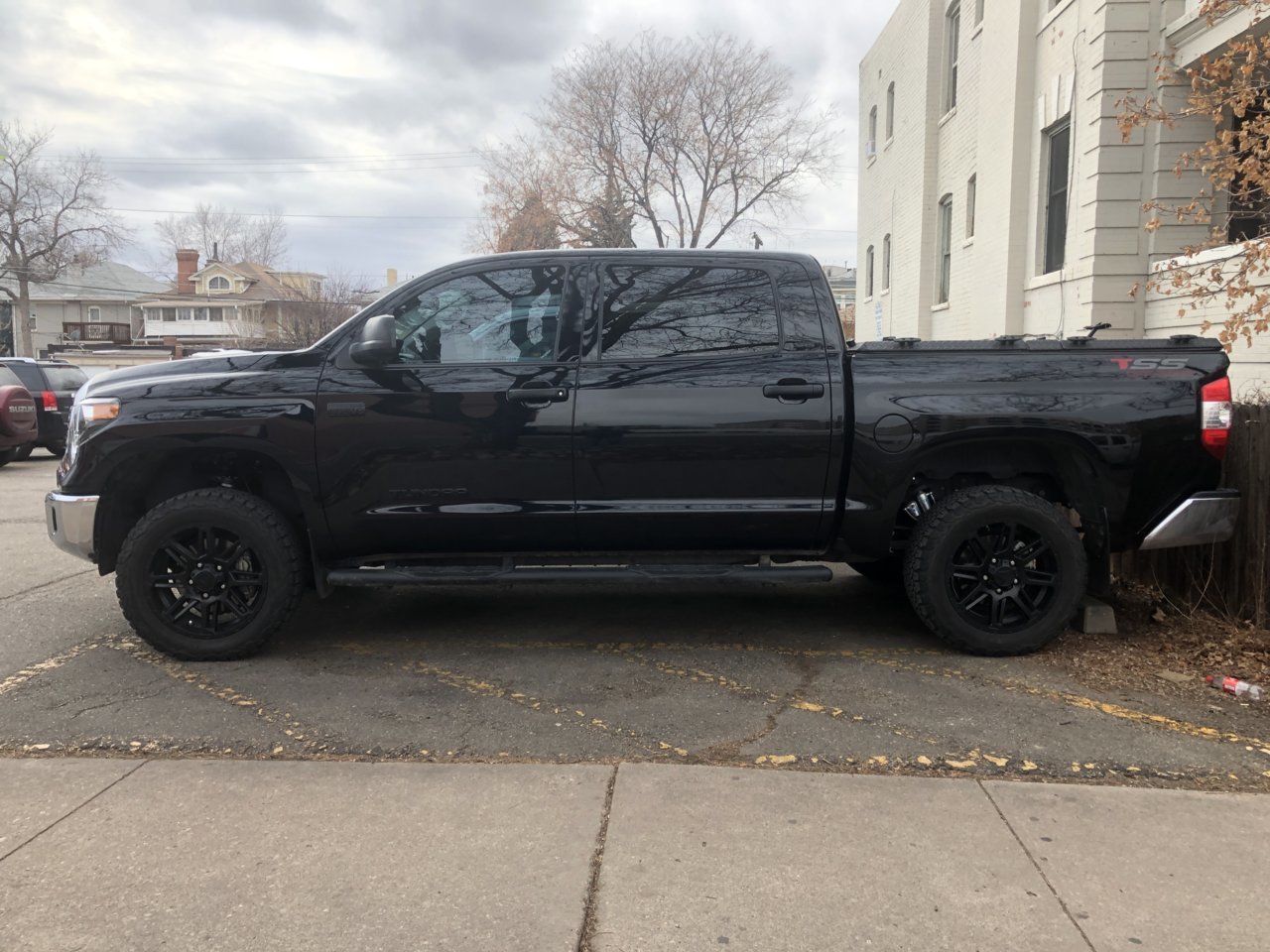

    Stay tuned.... :stirthepot:

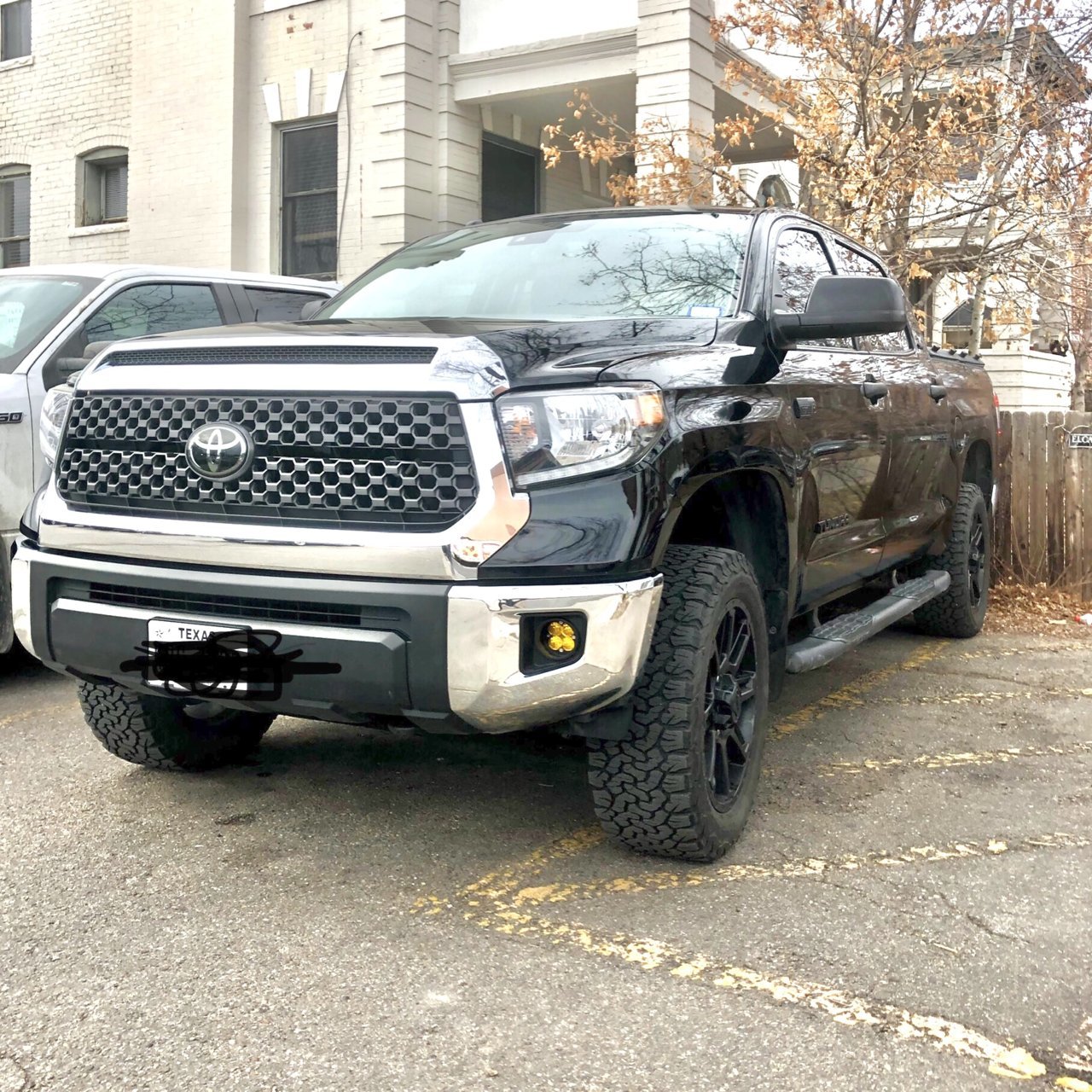

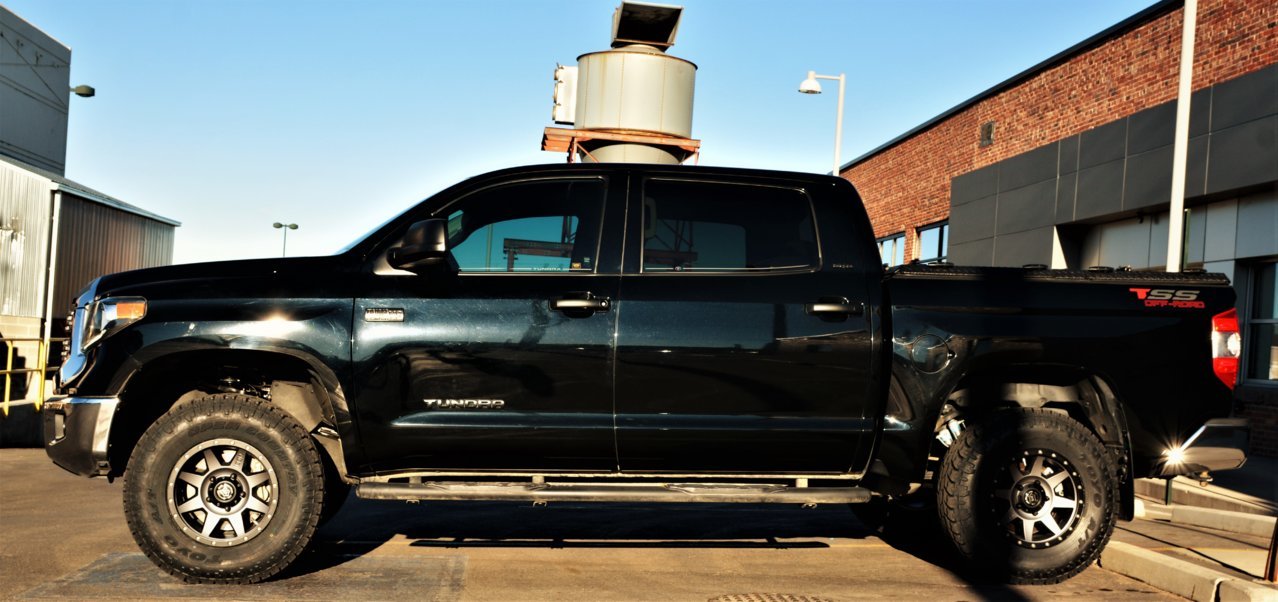

    Chunky boi ;)
    Tundra9831 and RangerBP like this.

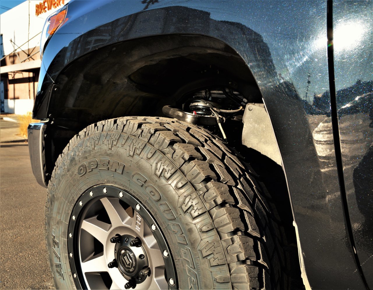

    Thank you @Toytec Lifts
    The truck turned out perfect. The driver side shim that was added leveled it out side to side and I have 1/2” of rake. Love it. ❤️ I’ll add more pictures when I can.
    @mww982 the tire and wheel combination couldn’t be better for what I wanted. They had to remove the mud flaps but no cutting was required for fitment up front. The spare fits underneath the bed very snuggly with about 1/2” clearance from the shackle bolts.

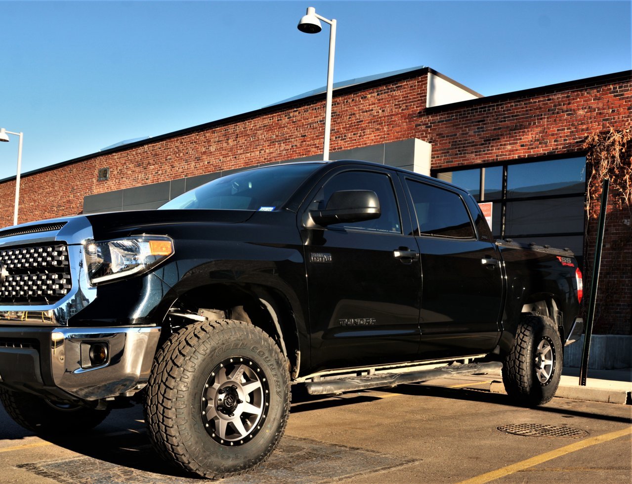

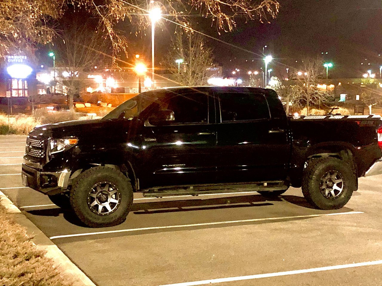

    Okay, now i'm done...haha
    jerzeedivr, D4x4TRD, BCSpazer and 3 others like this.
