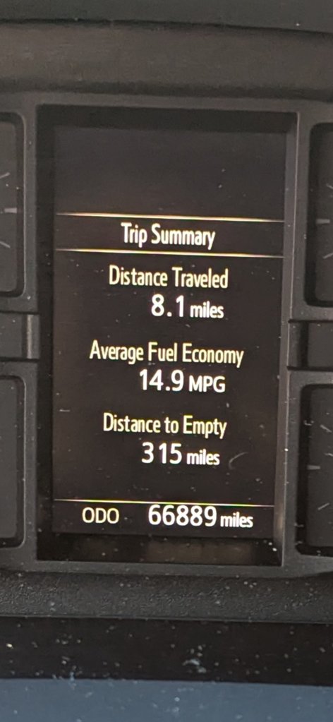

    Just bought mine. Here's my computer mpg. One way to work, 8 miles city stop and go.

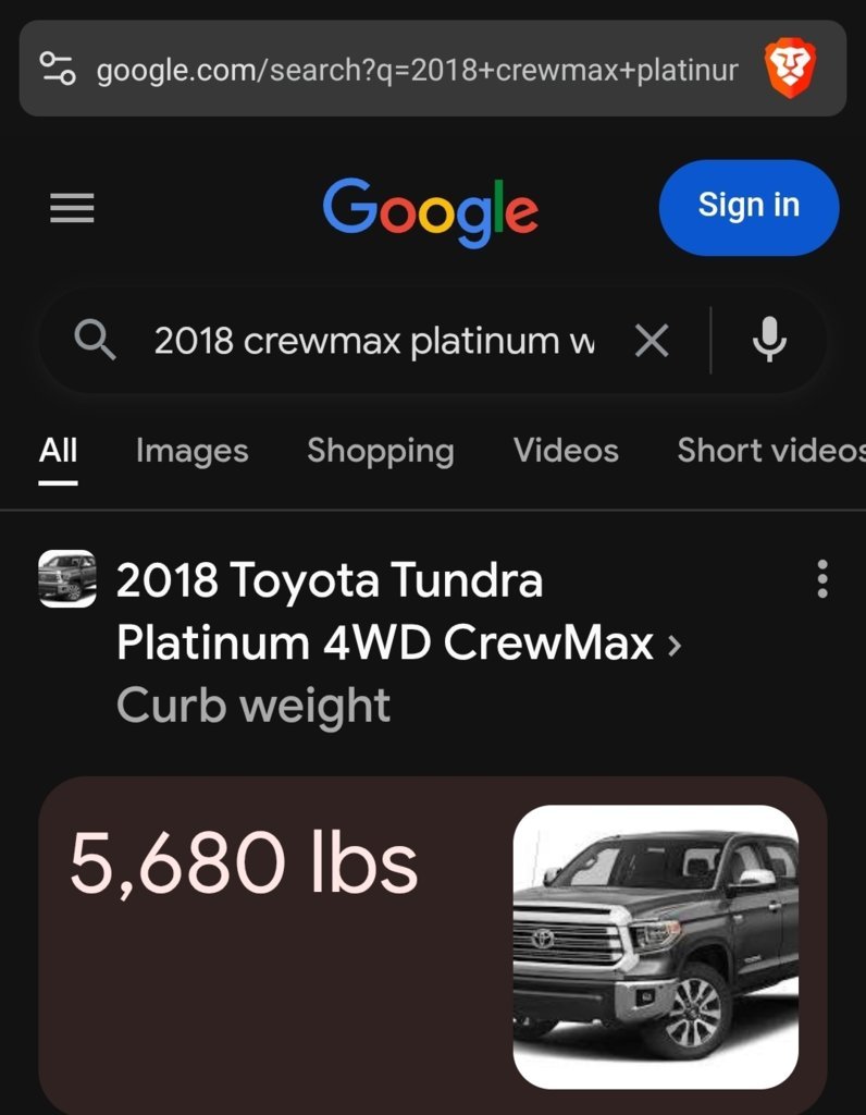

    Stock weight is 5680! What you have is like fully loaded truck! I doubt mods add that much. You don't have any payload capacity left. How much do you weigh, sir?!

    I’m 245#, but still sexy.
    (5) 35” heavy tires
    Heavier suspension parts with Deavers.
    Alcon brakes are big and heavy
    canopy
    Bedslide
    50L Dometic full of cold ones
    Dual batteries
    ARB dual motor air compressor
    Stereo gear with a heavy sub box
    200W Solar on canopy roof
    A mid-size Action Packer tote with a few tools and minor safety stuff
    Bunch of lights
    It all adds up…. I’ve weighed it several times and it’s pretty much always in the 7,100 to 7,200 range. As mentioned, she’s a fat pig. And, you’re correct. I technically have no payload left. But, I’d argue that the heavier tires and wheels (4 of them), the big brakes, and half of the additional suspension weight ought not count against payload since they are unsprung weight that the truck is not carrying. This thread is not about that though, so let’s not discuss that theory here.
