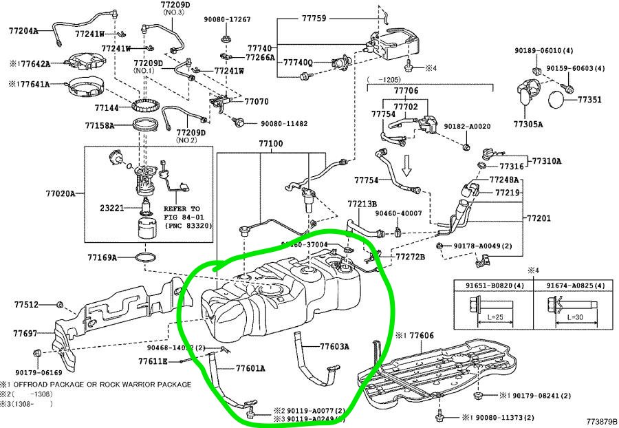

    Like OP, on my 2018 Tundra Ltd, I became concerned when my range indicated 30 miles left, but I could only put 25 gallons in at a fillup. Did the dealership rip me off and give me a 26 gallon tank, when in fact the sticker says 38 gallon?
    Reading through the posts here, most people are trying to estimate their tank size by reverse engineering how the computer works with its range indicator and with average MPG computations, and are suitably baffled by the results. I came here to ask, is there visual indication (such as tank shape, connection points, part number scribed onto the tank, etc) between the smaller and larger fuel tank options that, upon visual inspection, can confirm which tank is installed?
    I am not convinced I got the 38 gallon tank that I paid for, so I'd like to prove to myself with a visual inspection.

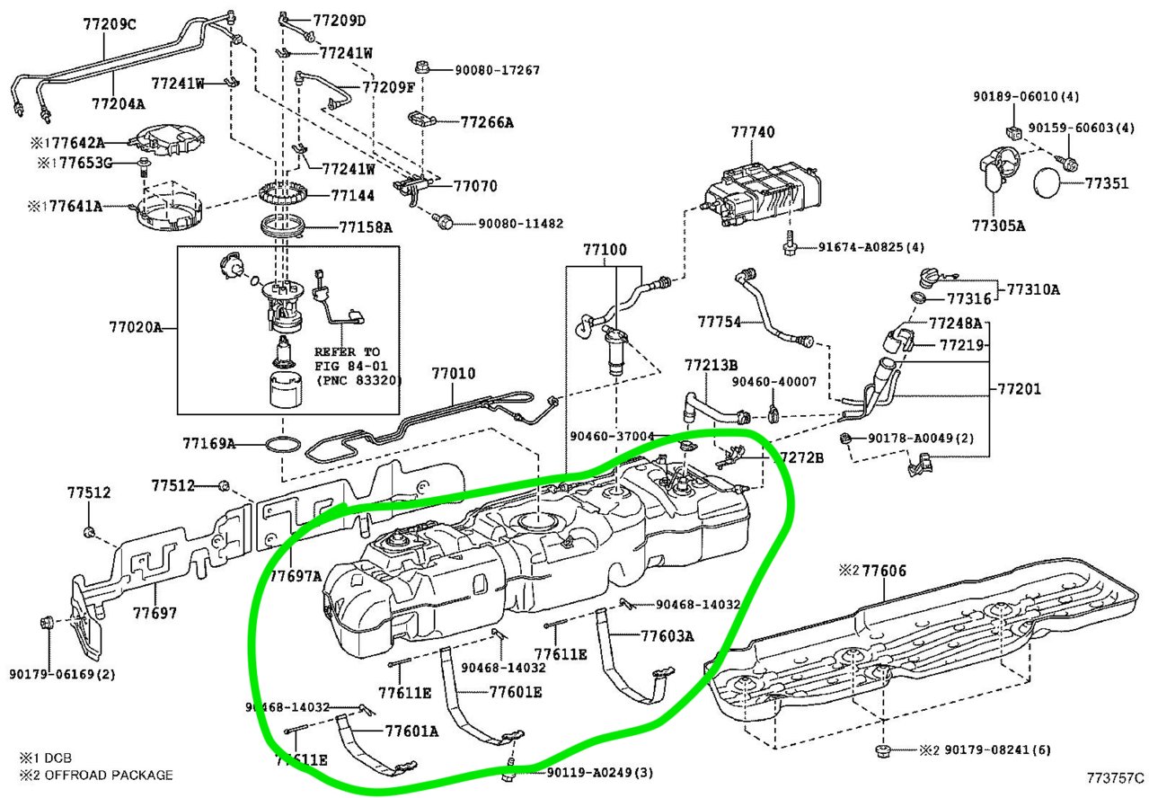

    To answer my own question, after poking around on parts.toyota.com, it appears that the smaller 26.4 gallon tank has two retaining bands, while the larger 38 gallon tank has three -- specifically, part number 77601A which cryptically states, "TRD PRO&FUEL TANK-38 GALLON; OFFROAD PACKAGE&FUEL TANK-38 GALLON". See pictures comparing the two. Time to crawl under the truck with a flashlight!

    2018 Tundra Limited Double Cab Magnetic Gray
    Probably! Very likely! I am 95% inclined to agree with you! It would be scandalous if Toyota dealers were ripping off unsuspecting people by swapping tanks on them!
    But I am an empiricist, I want to know for certain by visual inspection, that is my point in posting here.
    EDIT: Took a picture of my actual tank, it shows 3 mounting brackets (see picture) that match up with the parts guide's 38 gallon tank, so I'm convinced it's the 38 gallon tank, and all is well in the world, and Toyota's concept of "empty" is very, very conservative indeed.

    It is good you did your own research, found a way to confirm. This will help other owners and put their minds at ease.
    Personally I think no dealer would bother spending time to do this work of swapping tanks as it's a waste of time and money for them not to mention fraud and possibility of losing their franchise license.
