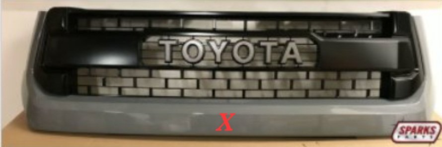

    I have a 2021 SR5 with the TSS in the grill. Is there any way I can install the below 2017 grill and just not have the sensor on? Or will it throw codes and all that?

    You will get errors and some functions will not work like adaptive cruise. But you can use a TSS relocation bracket with that grille to keep functionality.

    Some people have mounted it behind the X

    AJT designs sells a relocation bracket, I used it with that grill on my 2019. Pretty easy to do and it has worked pretty good. It will occasionally disable due to snow buildup or heavy rain, but works fine 99% of the time.
