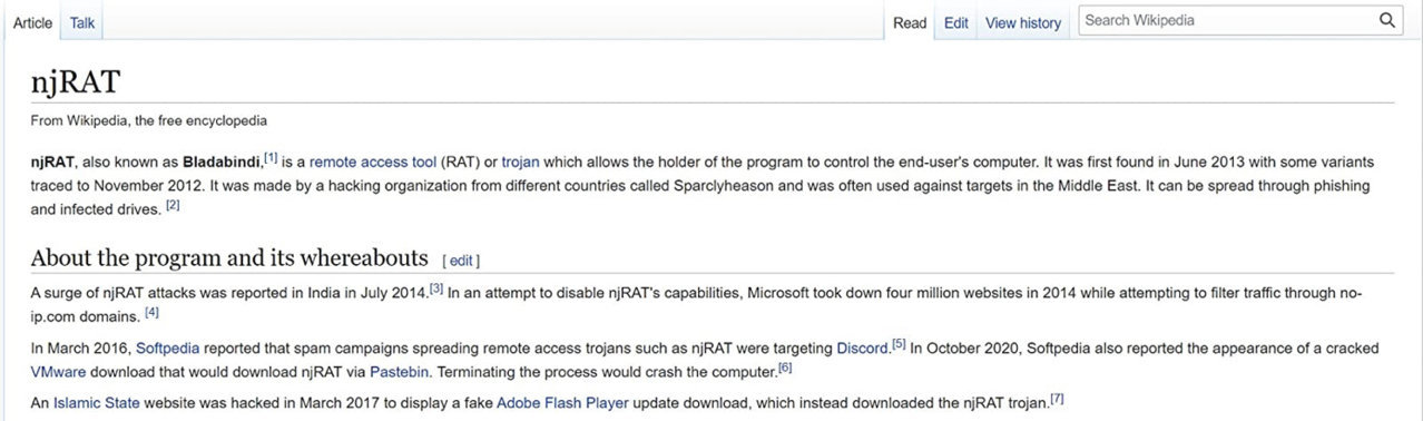

    the concept is cool but I’m not trusting Chinese malware to be installed on my computer
