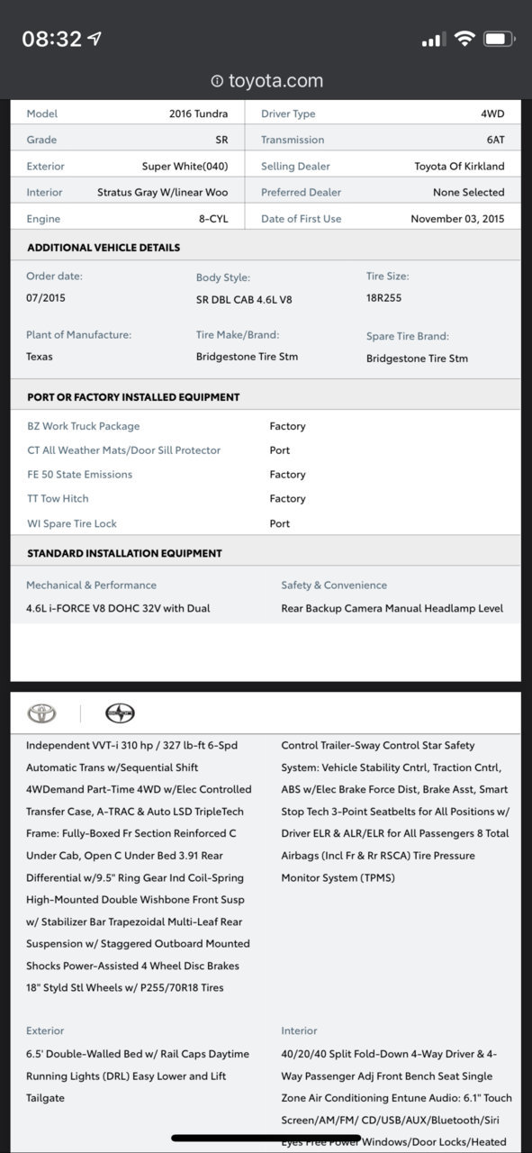

    Can some one help me out with why why I can’t seem to get a fob synced to my 2016 SR? I have looked up the VIN and it says it was sold with keyless entry. I understand that that is not necessarily stock on SR’s...? and it may be aftermarket but, not fobs came with it...so I popped open the driver kick panel and column trim and found no sign of any aftermarket receiver or slicing. I then used techstream and found I can’t add wireless fobs through immobilizer, not even there as an option only to add be transponders(keys). I even re-installed those for S.A.G. I can however enable my security and it does work. Since I couldn’t install new remotes, I then checked to see if the wireless receiver or buzzer were installed, neither were...so I installed them. Still doesn’t work. Is there anyone who could maybe shed some light on this for me? I have cruise control too...It seems that was part of the option with the “convince package” along with the wireless entry?!?? I didn’t have fog lights or intermittent wipers, which I added. Any help would be super! Thank you!177F605A-0423-4E19-93FC-6E10903A7F41.jpgADBD7081-C0A3-4982-8C29-5C58A7EEE076.jpg

    If under the Toyota specs on their website your truck shows keyless, it's not aftermarket, but stock. You need new gem FOBs and to have to programmed at the dealer.

    Cool, thank you for the help. Is that even with the SR’s? From my frustration with some web research, it looks like it might be added by the dealer as an option? Like it was not put in the harness? And Toyota has an approved aftermarket option. Am I wrong about that? Since it says on the website it was initially sold with it?
