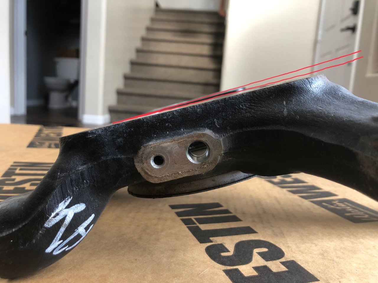

    Spindle gussets are a must have if you wheel. This is how much mine bent after 6k miles. Old spindle in front, new in back.

    I was just reading your post this morning when searching for the answer and seen that I'm planning on wheeling hard just wanna do everything right that I can the first time

    Recommend finding new takeoffs if possible, price was the same for me. Don’t want to gusset a bent spindle.

    I have a set in my garage that were removed before delivery to the customer. Seeing this just upped the priority of getting these gusseted. I'm sure that Schnebly Hill Road did nothing good to my un-gusseted spindles.

    Ha! Last year after a run up Schnebly Hill Road was the first time one of mine bent. It’s cheap insurance, my alignment is still perfect after Sedona, must have imo..
