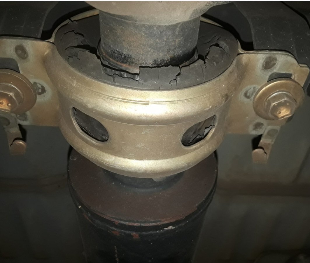

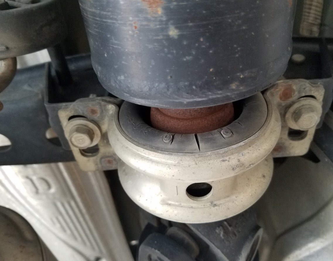

    This. I doubt the Bilsteins did it, but if the carrier bearing was installed upside down you'd have shudder. Please take a pic of it and post it. Correctly installed, there should be one single hole right in the center of it, like it was stamped with a hole punch.
    dtasci53[OP] likes this.
  21. Feb 22, 2022 at 9:24 PM
    19TurdPro
    19TurdPro New Member
    Jul 27, 2019
    #33771
    899
    2019 Tundra TRD Pro
    Screenshot_20220222-212214_Chrome.jpg Yes
    Screenshot_20220222-212231_Chrome.jpg No
    Disregard how shot they are. This is for proper orientation.
    dtasci53[OP], 1lowlife and JLS in WA like this.
