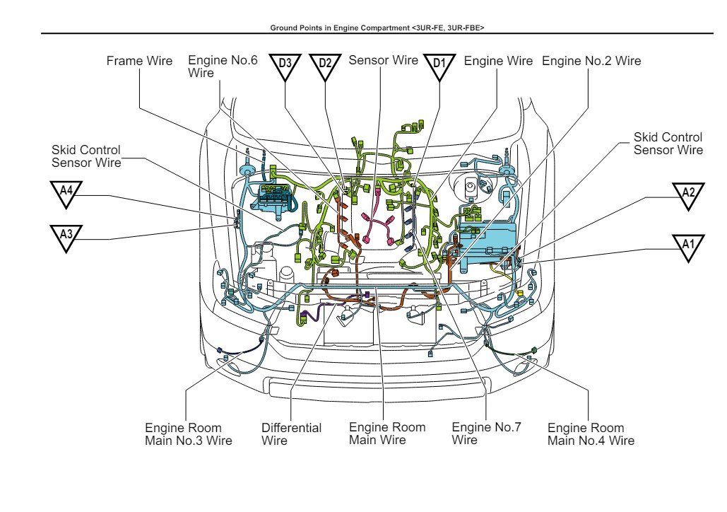

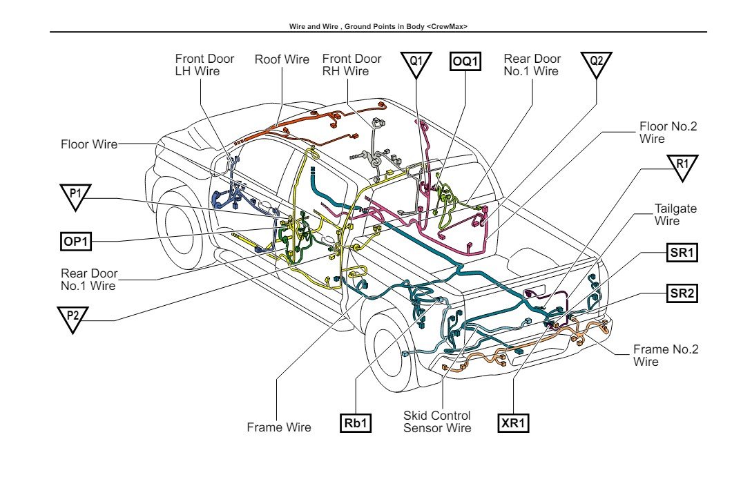

    Knabores do you know where I can find a diagram where to look for them all? Location wise
  11. Jun 22, 2024 at 8:40 AM
    KNABORES
    KNABORES Sarcasm incoming
    Jan 1, 2020
    #40572
    15,807
    Arkansas
    FSM is a great resource. There’s also an EWD floating around here somewhere. Maybe in a sticky.
  12. Jun 22, 2024 at 8:45 AM
    KNABORES
    Jan 1, 2020
    #40572
    15,807
    Arkansas
  13. Jun 22, 2024 at 8:52 AM
    KNABORES
    Jan 1, 2020
    #40572
    15,807
    Arkansas
