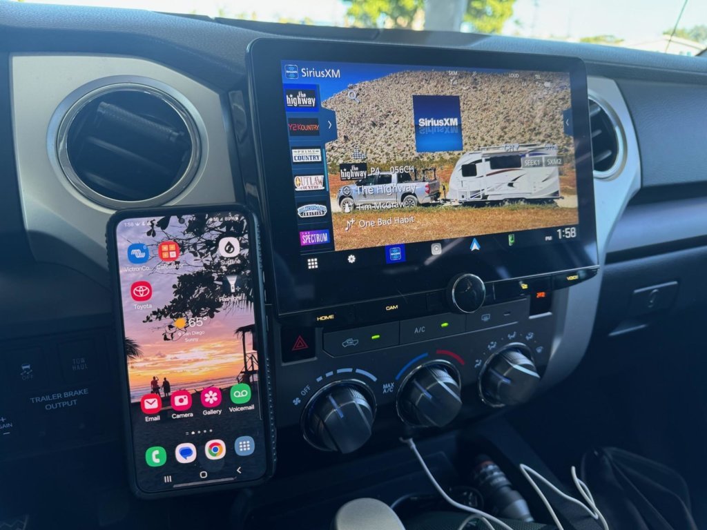

    I've heard only good things on here about Trail Grid Pro.
    Mine's a '19 but had the amplified non-JBL also.

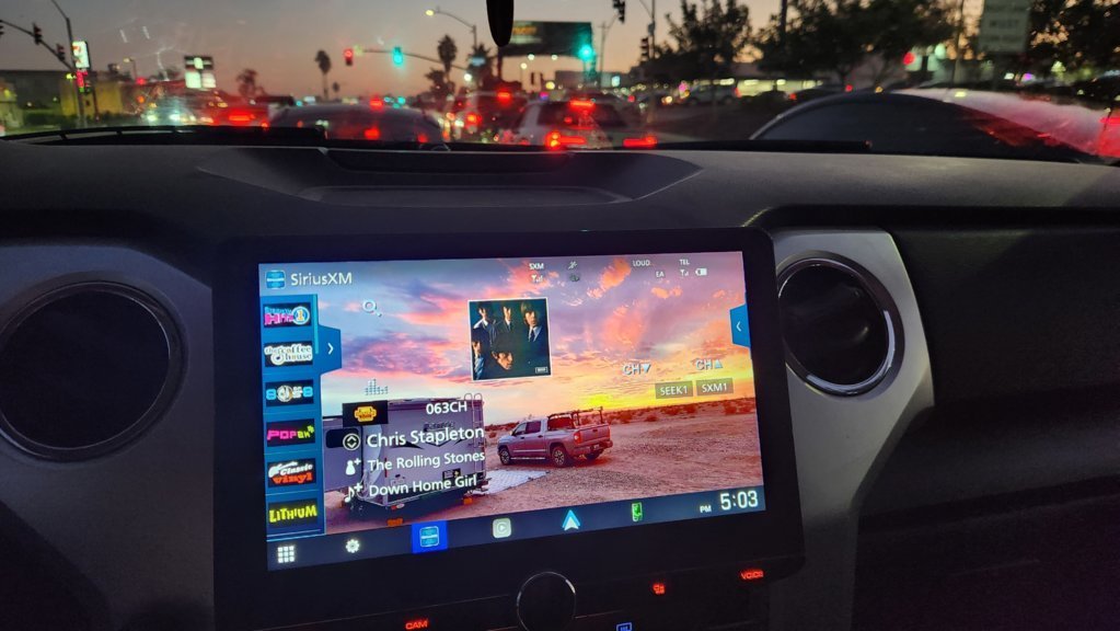

    Just changing out the craptastic OEM head unit was a significant improvement in sound quality as well as functionality. I'm super happy with the big 10" Kenwood I had installed.
    Yes, I'd like to just drop thousands more and do amps, subs, and separates, but I have too many other priorities to spend that money on and this is good enough to keep me happy for now.

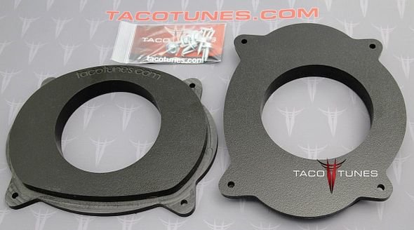

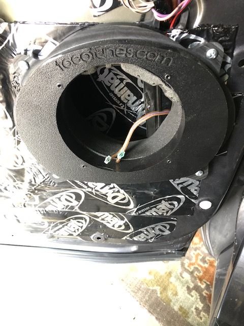

    I would avoid Taco Tunes with one exception.
    They have many satisfied customers, but in the past, some members here had bad customer service experiences.
    That is the reason one cannot post a link to their website on this forum.
    The exception is that they make very nice speaker adapters.
    Cut to order and usually shipped promptly.
    c8f3f776-1853-4d63-b8d8-bd3fcbfe61e7_9a889c907da3667b91d0f53ff142d40afecc7aba.jpg6bac75b4-c2ad-44d1-b77e-f2e11f83c91e_cd43a9a4f11af147f5e55952141276e7768e6882.jpg

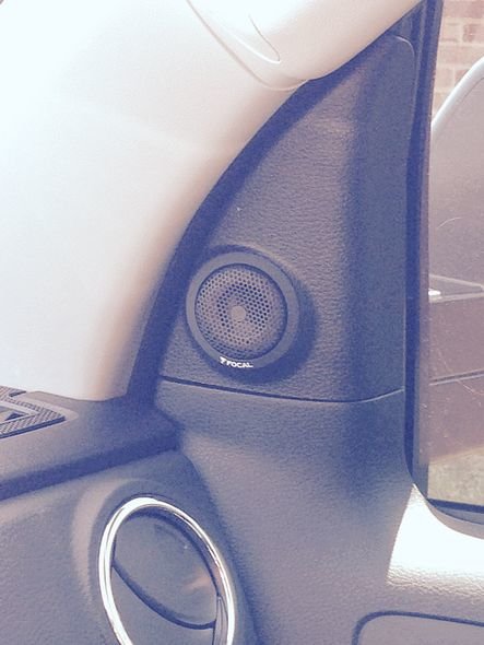

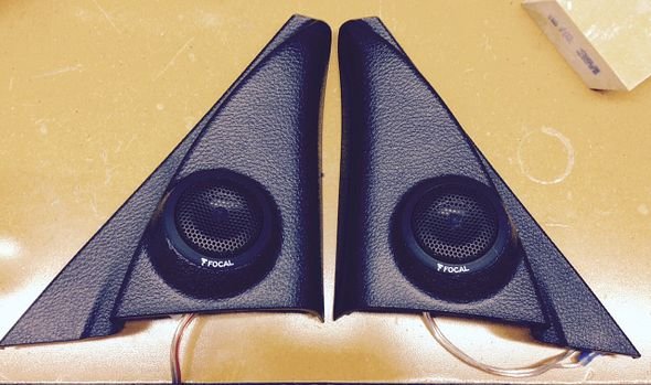

    Tweeters in the front door sail are a good idea.
    With a decent set of front door components, I disconnected all three dash speakers.
    The OEM non-JBL door sails have a slight curve to them.
    If you want something flat to work with, Taco Tunes makes some or go with OEM JBL sails like I did.
    TTunes

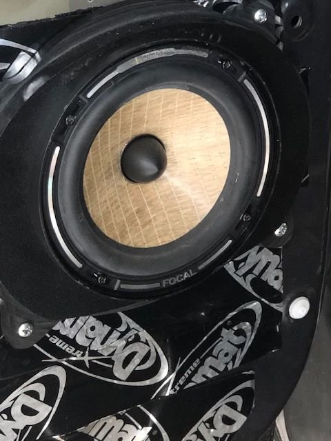

    OEM JBL, I cut the grilles out and fitted my tweeters.
    I love my front door speakers, but they are bit pricey.
    I only paid about $550 nine years ago..
    Focal PS 165 FXE Performance Series 6-1/2" bi-amplified component speaker system at Crutchfield
    I put these in the rear doors, my DC doesn't have tweeters back there.

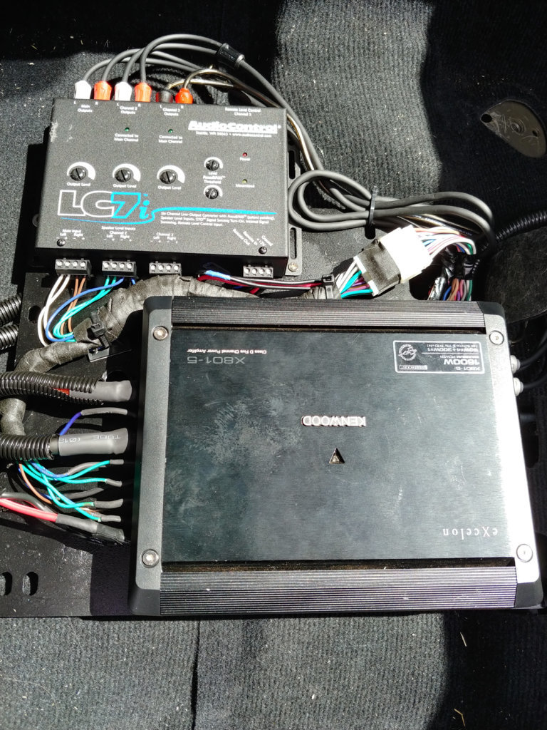

    you can certainly keep the stock head unit and speakers to start with.
    I did on my 2016 and still run the stock speakers except for the dash.
    This was my setup prior to getting a Dasaita Android HU.
    Stock head unit, LC7i LOC Kenwood 5 channel and single sub.

  23. Jun 10, 2025 at 3:36 PM
    Kreole Kid
    Kreole Kid New Member
    May 7, 2025
    #134651
    3
    New Orleans, La.
    2015 1794
    Leveling Kit, Stereo Upgrade

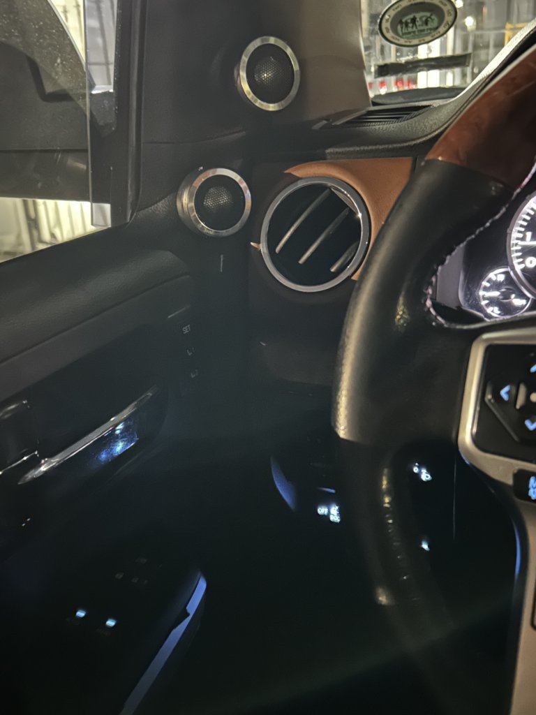

    Forgive me for the Huge Pics, but this is four of the tweeters up front. I prefer my Smooth Jazz very bright with crisp highs!!!,
    The other two are in the rear doors.
    SC SR5[OP] likes this.
