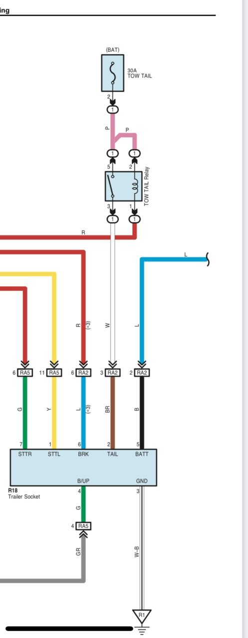

    I may not be the sharpest pencil in the box but this can't be right. Have a 2010 with tow package. Last night in the pouring rain, hooked up my little utility trailer to drag it home after loaning it out. Plugged in the lights and true to form, no running lights on the trailer. Turn and brake work fine. Much to my wife's chagrin, towed it home anyway. Today I start trying to chase down the problem. Fuses all good, bulbs all good!! What gives? So check for voltage at the connector on the truck. Nothing for the taillights. Time for wiring diagrams and thanks to another forum user, they are available.:) Again, I may not be the sharpest pencil but as I read the wiring diagram it appears to me that the tow/haul switch has to be engaged for the running lights to work. Is that for real?? What was Toyota thinking? Why would I need to engage tow/haul to drag around a 800# utility trailer?

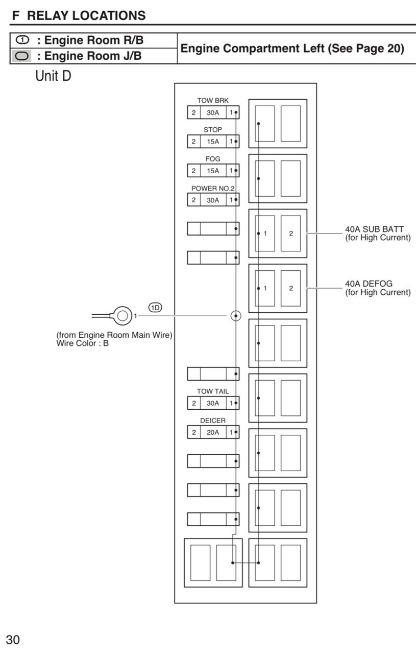

    There is a relay and 30A Tow Tail fuse that specifically control the tail light power to the connector. When you turn the headlights on the relay will close and provide power to the trailer socket. It has nothing to do with the tow haul button.
    Very simple circuit. Check the 30A Tow Tail fuse in the engine fuse box. Also make sure you have a relay in there.
    You are using the round 7 spade trailer light connector right?

    Boy do I have egg on my face. Gonna blame it on being an old fart!! In addition to checking the wrong 30A fuse I also misread the wiring diagram. :confused: After re-checking for a bad fuse, found the 30A Tow/Tail fuse blown. No idea what could have drawn that much current but will chase that another day. For now at least, I have power to the connector on the truck. Thanks for all the help.
