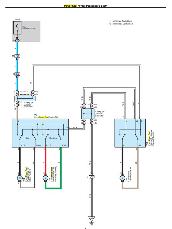

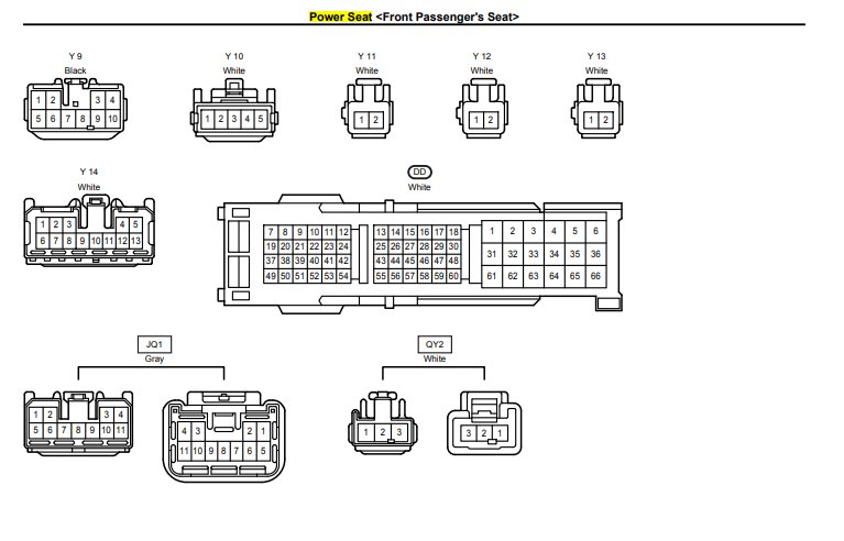

    Morning all,
    I have a 2010 extended sr5. My drives seat is power but the passengers seat is not. I bought leather power seats from a 2010 tundra the drivers hooked up but the passengers connectors are different. where can I find a wire diagram to see what wires I need to hook up to get the seat to work.

    You all are a life saver. Thanks

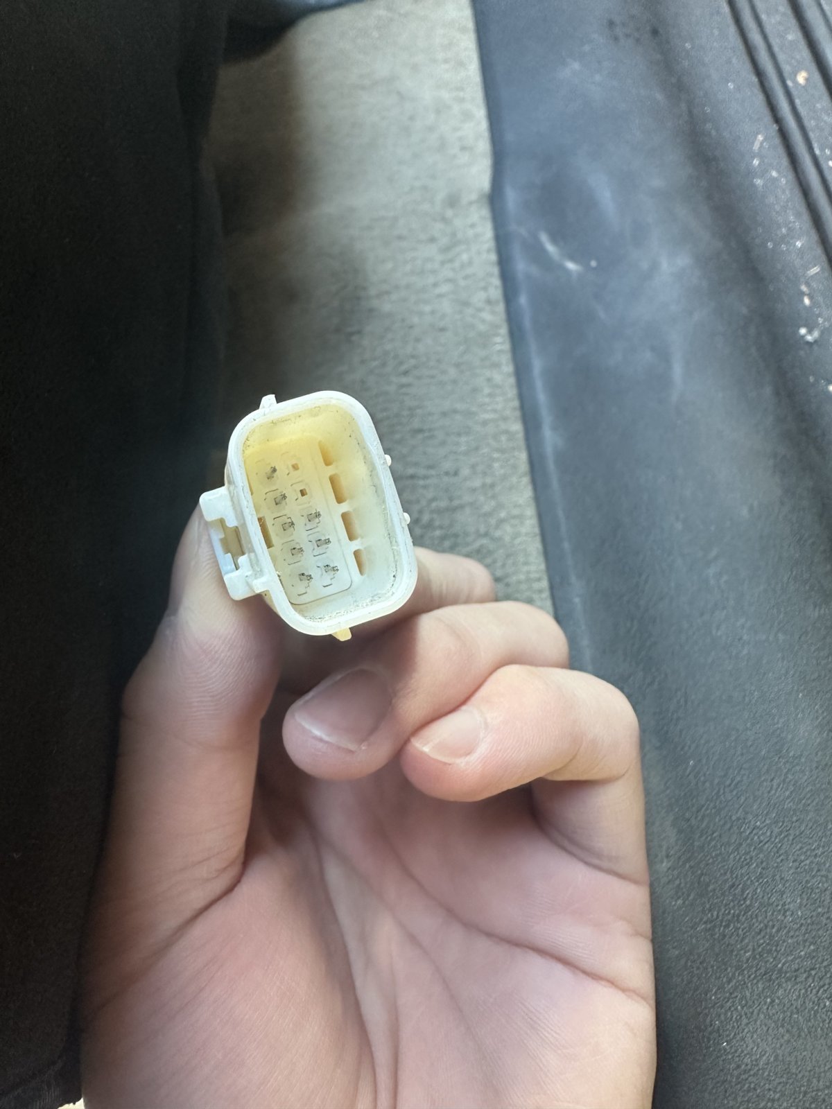

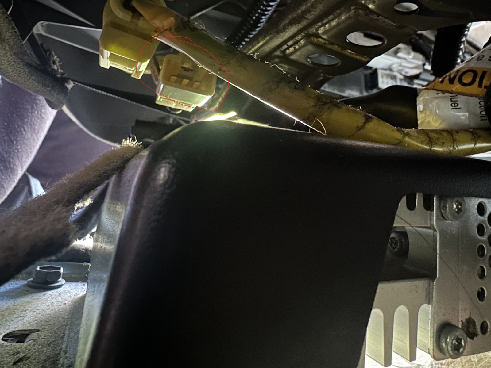

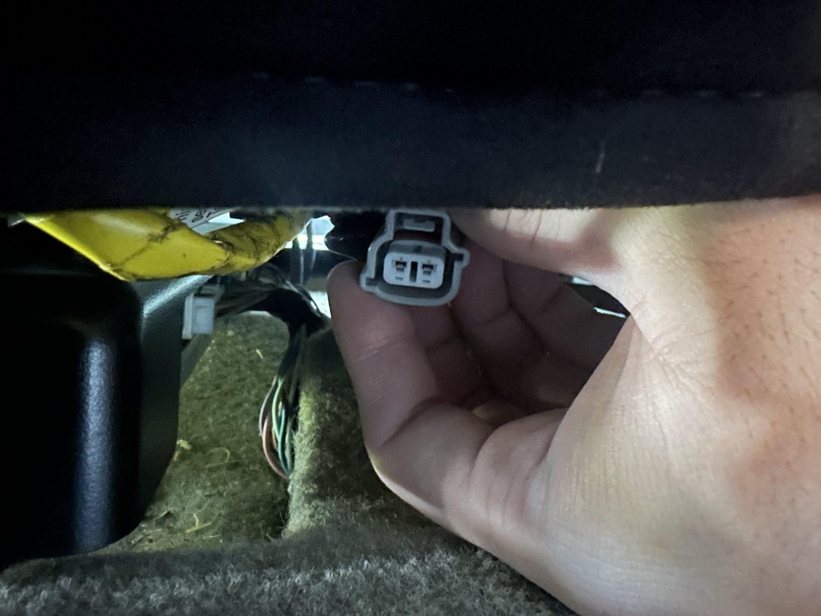

    Did you figure it out? My connector looks a little different from the diagram. The truck is 2010 and the seat I believe is 2008. I have 3 connectors that are left open. Need to know how can I get power to the passenger seat.

  7. Oct 22, 2023 at 2:47 PM
    tmac58star
    tmac58star New Member
    May 28, 2019
    #31106
    330
    Black 1st generation Tundra SR5 Access Cab
    To figure out the 08 seats you need the schematic for that year, noting wire colors. Then compare to the wires/colors in your truck connectors. Plug and play wires in a new connector to get function.
