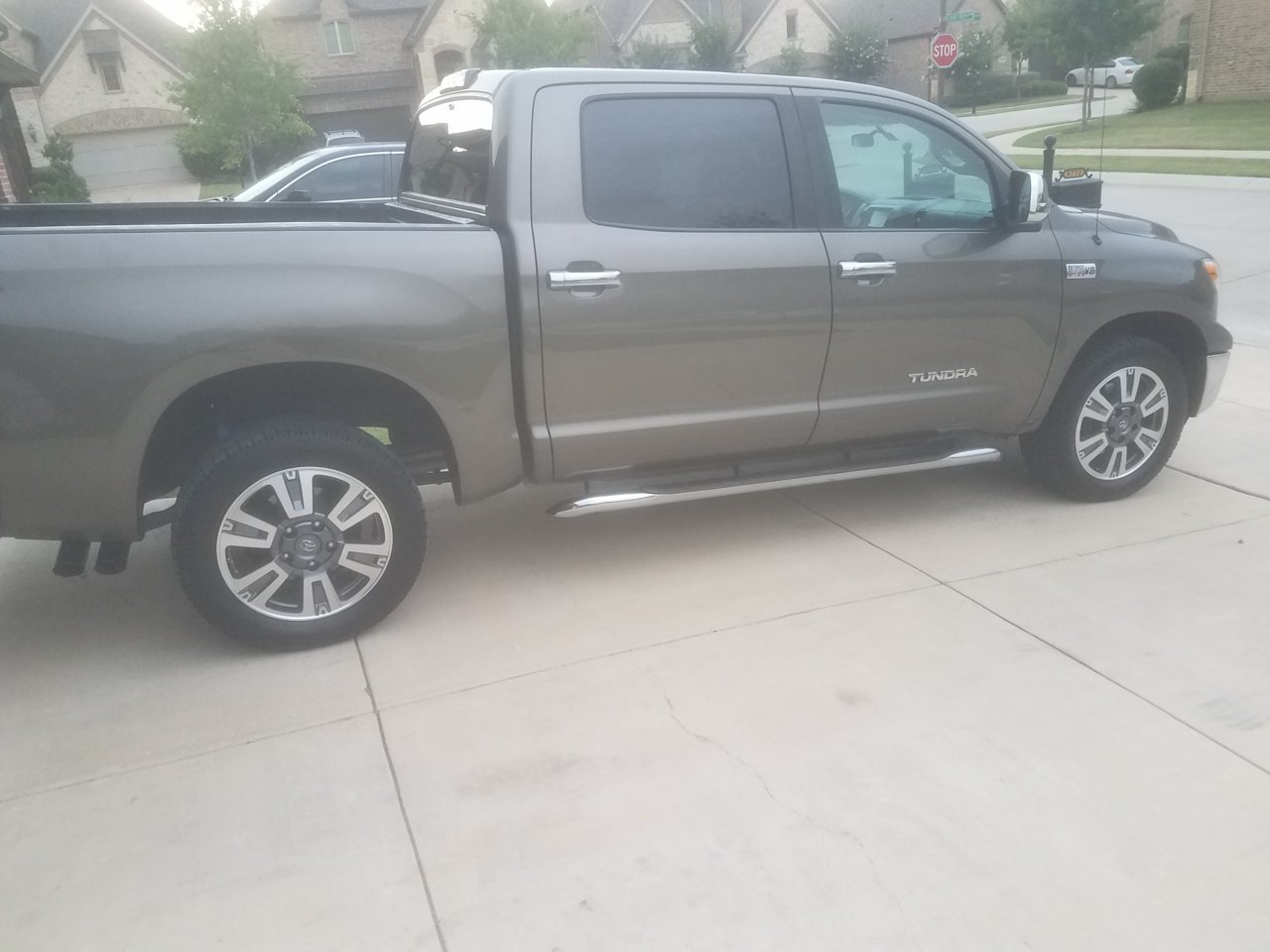

    I just upgraded my 2008 Tundra wheels with 2019 Tundra wheels...wanted to know if the new tpsm sensors from 2019 Tundra wheels would relearn on 2008 Tundra computer..Any help would greatly be appreciated.

    Welcome to the club, awesome truck. Those wheels look great. For TPMS, would a larger tire chain be able to reprogram? Les Schwab or somewhere that might do this often?
