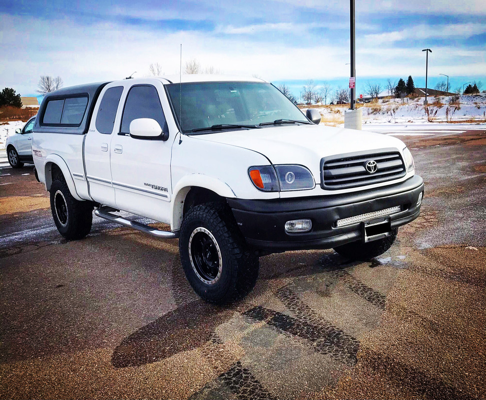

    Ask and you shall receive, 285/75/16 KO2s. This is the sweet spot as PHM said. Not going into the suspension specifics.
