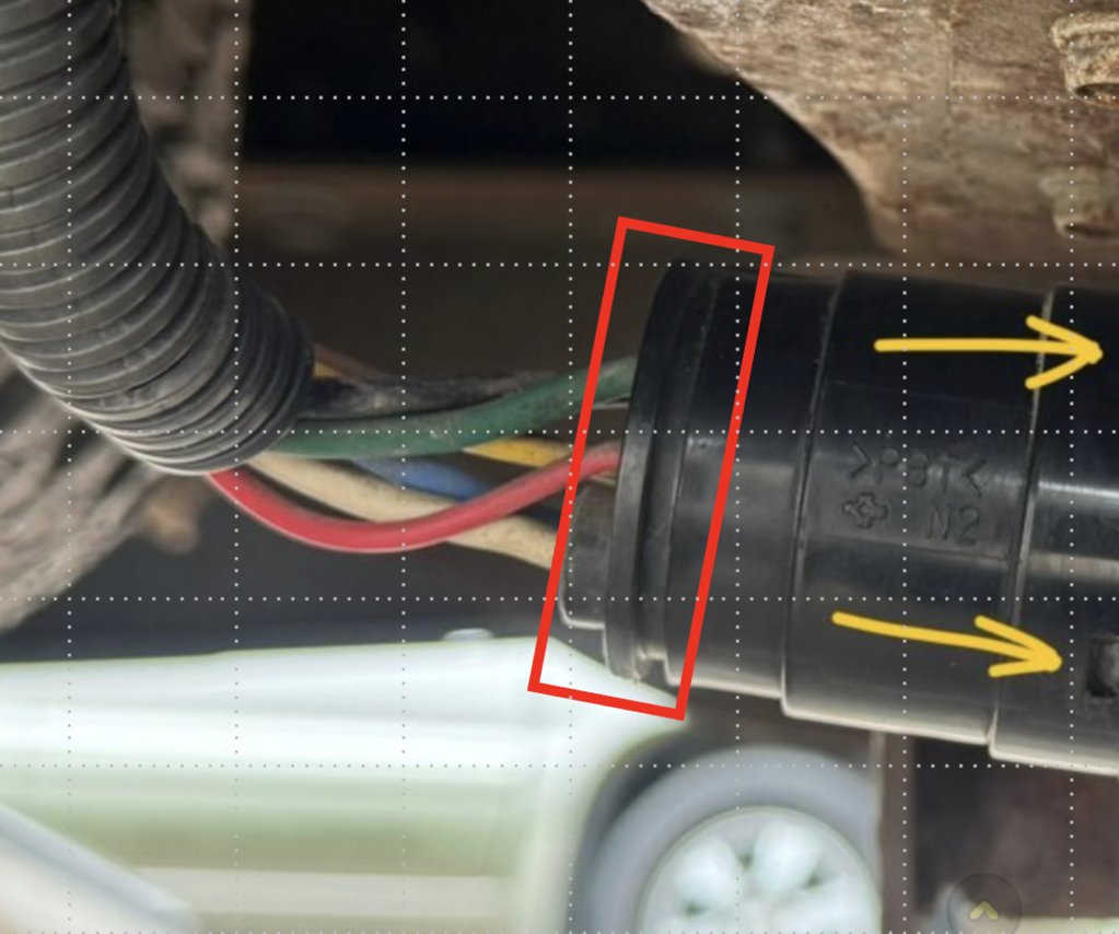

    So I picked up one of those Diode Dynamics trailer hitch brake / reverse lights.
    It came with a harness you put inline before the plug. (behind it)
    So it's supposed to be an un-plug / plug & play set up.
    I have this stock plug (pic below) and it 'appears' to be 1 piece.
    My eyes are crap, so I can't seem to see if there is a joint/ seam where it would pull apart.
    I do see these tabs (arrows) , are those keys to press & pull ? Or are they permanent deal?
    The dotted line is where there 'could' be a seam . . . I'm just not certain with my crap eyes.
    I didn't wanna start yanking, pushing, pulling on something I'm unfamiliar with.
    Thanks for any help.

  3. Apr 23, 2025 at 4:06 PM
    HBTundra
    HBTundra [OP] New Member
    Nov 20, 2019
    #38908
    793
    2006 DC 2wd
    Thank You . . . but I think this one is a different plug unit . . . I don't see that 12 o'clock groove / release tab on mine.
    It's round all the way around it, that's why I thought those little tab indentions may be to release it . . . I'll go double check to make sure.
  4. Apr 23, 2025 at 4:24 PM
    1lowlife
    May 4, 2016
    #3296
    11,139
    DADA
    THE GREAT STATE OF TEXAS
    2014 MGM DC SR5
    If those tab indentions don't release it, maybe the rear part with the wires comes out?
    See if you can gently pry it out.
    Good luck..
  5. Apr 23, 2025 at 5:03 PM
    HBTundra
    Nov 20, 2019
    #38908
    793
    2006 DC 2wd
    Yeah, I think those tab indentions have something to do with releasing it.
    There's 4 of them, they're at 10:00 & 2:00 . . . and 8:00 & 4:00.
    If you look just right you can see through them from one side to the other.
    I was able to get a really small allen key through each side.
    When I push on one side, you can hear a 'click' . . . but nothing when I try to wiggle. Push on the other side and it 'clicks' back.
    I think it'd probably easier for someone w/ more experience with different plug types than me.
    I don't wanna break anything, and I need to trailer my boat this weekend . . . so I'm gonna cool my jets and look on the interweb on how that plug releases.
    I may just look for an entire new one and ditch this one.
    I'll keep this thread updated as I find more.
    Thanks for the help..
    EDIT - I think I may have found it . . . this dude has/ had the same plug. Stand by.
    https://www.tacomaworld.com/threads/7-pin-trailer-harness-plug-replacement-tip.288024/

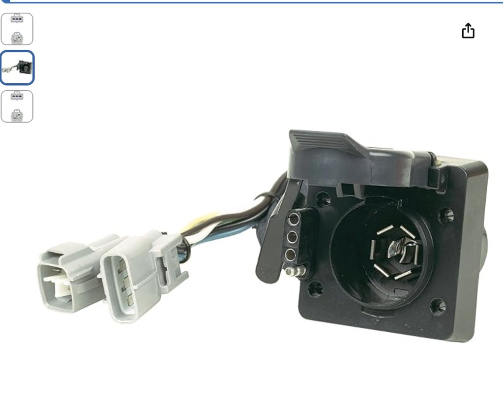

  7. Apr 25, 2025 at 11:08 AM
    Mustanley
    Mustanley Two time totaler
    Sep 10, 2019
    #35898
    311
    Hendersonville, NC
    2004 Limited TRD 4x4 DC
    Eibach Shocks/Coils|Doug Thorley Headers|Spintech 3000XL Muffler
    I can at least confirm that Hopkins replacement (43385) worked perfectly on my DC to replace my bashed and broken factory socket.

  8. Apr 26, 2025 at 7:12 AM
    bd100001
    bd100001 New Member
    Nov 14, 2022
    #86704
    7
    Ben
    2006 Tundra V6 SR5
    FYI - the "12:00 Groove" is on the inside. It's what helps you line up the plug correctly (you probably know this already, but just going off what I read in your earlier post).
    For the Diode Dynamics part - and probably for the Hopkins one as well - I believe you have to trace that harness back to where it plugs into the vehicle harness. On my 2006 Tundra, the plug was on the driver's side, under the bed, near the left taillight.
    I cannot speak for the 43385, but sounds like @Mustanley used it. I replaced the factory 4-wire flat with the round Hopkins 47185 (Universal), so I had to cut wires... but it worked just fine.
    Best of luck with it!

  9. Apr 27, 2025 at 5:31 PM
    HBTundra
    Nov 20, 2019
    #38908
    793
    2006 DC 2wd
    As I expected . . . the Hopkins seems 100% fine for straight trailering, and the plugs that tie into the factory toyota harness look great.
    But there's no way (that I can see) to separate the plug from the insert portion, so I can get this DD pigtail in line.
    The hopkins plug is all one piece if that makes sense.
    I'm just gonna call Diode Dynamics in the morning and see if they know of a vendor who sells what I'm looking for.
    I really don't want to have to make my own wiring harness for this thing, as I HATE wiring.
    Plus I'm color blind, which makes wiring a total pain in the ass for me.
    The type I need is the kind that goes 'through' a bumper where you mount the 'face' on the outside and the plug portion fits behind the bumper. . . 'NOT' the type that bolts to the frame and hangs down below.
    Ideally what I'm looking for is a frame mounted one that separates . . . but I understand that wouldn't make much sense to make.

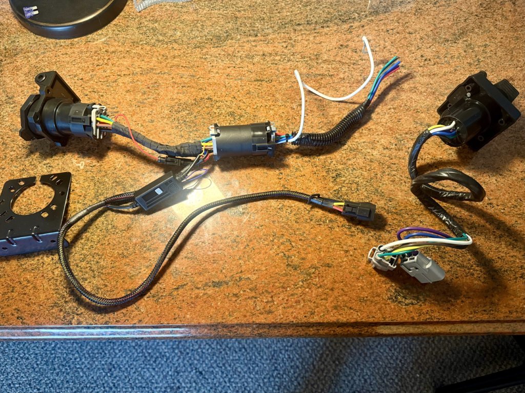

  13. Apr 28, 2025 at 9:32 AM
    bd100001
    bd100001 New Member
    Nov 14, 2022
    #86704
    7
    Ben
    2006 Tundra V6 SR5

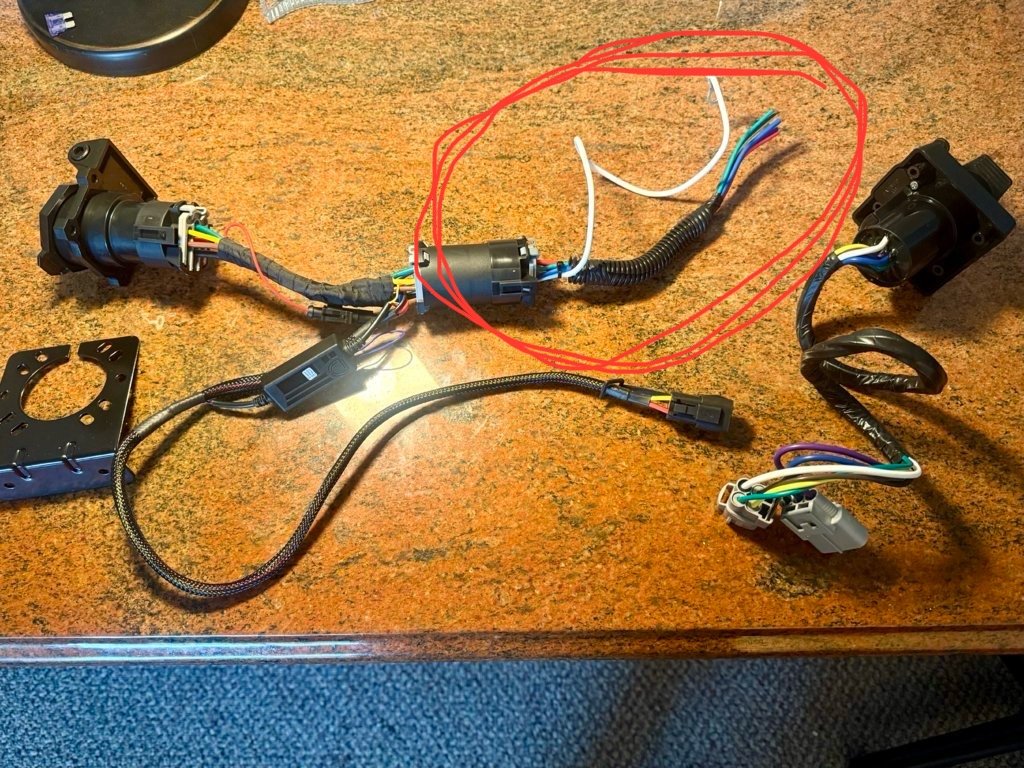

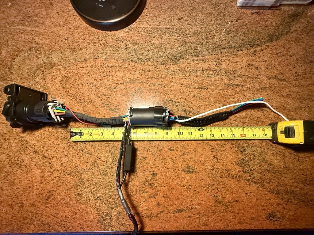

    Could you send a picture of what you got from Diode Dynamics?
    Looking at this with fresh eyes, it appears you're mounting the brake/reverse lights on your truck(?), and the harness you got ties into the existing wiring? If so (and if it's designed to fit your vehicle), it should tie in under the bed, to the rear of the spare, between the spare and the bumper. If memory serves - and I can confirm if needed, that's where the trailer wiring ties in.
    You don't want to pull the existing trailer wiring plug apart, nothing but misery for you in there.
    If you have the DD part number or pictures, that would also help.

    Thanks for sending that. I watched the installation video, now I see better what you're doing.
    IF the light you ordered is vehicle-specific, it should fit right in line, like you said originally. However, the place to take that 7-pin connector apart is not where your arrows indicate. I THINK the place where you take it apart is where I have drawn the rectangle. That more closely coincides with the video. If it comes apart at that point, you should be able to connect your light in-line. Then you slide the light through the back of your receiver - or, slide the light in through the front, threading the wire out the back of the receiver. It also looks like the light stays in the receiver, maybe it slides to the back when you attach a hitch? The videos didn't really indicate.
    If you do have to do some wiring - if the harness doesn't fit and/or the factory 7-blade connector doesn't come apart - you just need to "tap into" two wires on the back of the OEM wiring. The center wire is reverse, and both side wires - at 3 and 9 - are the brake/turn lights. See the image I included. Hope this helps.

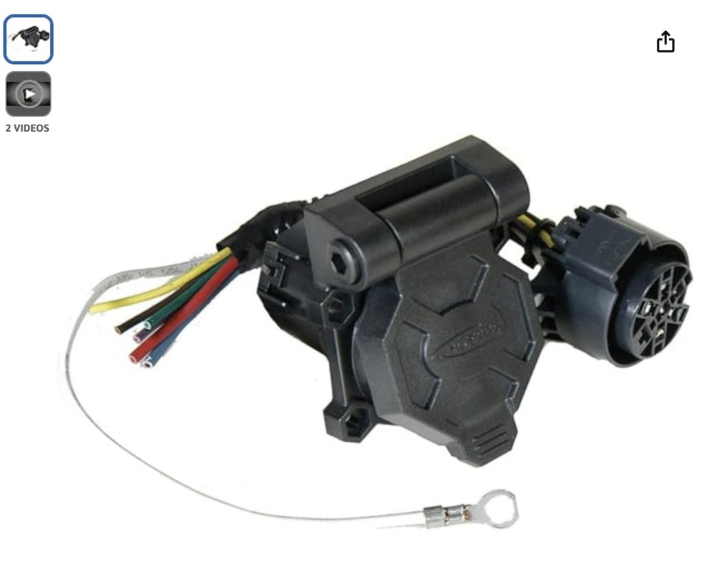

  16. Apr 28, 2025 at 8:26 PM
    HBTundra
    Nov 20, 2019
    #38908
    793
    2006 DC 2wd
    So if I want this thing to work, I'm going to have frankenstein a harness.
    Looks like a Hopkins 47210 may work for the plug portion.
    Then I'm going to have to source the 2 Toyota plugs to connect to the factory tow package wiring.
    Here's a pic of the 47210 . . . .
    G_unit3000 likes this.

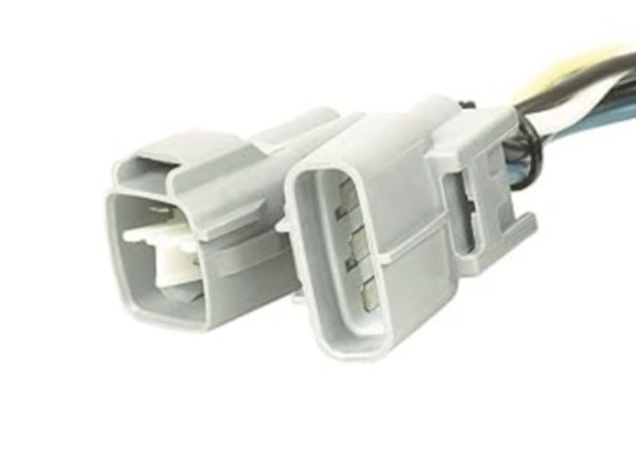

  19. Apr 29, 2025 at 6:39 PM
    daveeasa
    Dec 2, 2020
    #55605
    4,198
    David

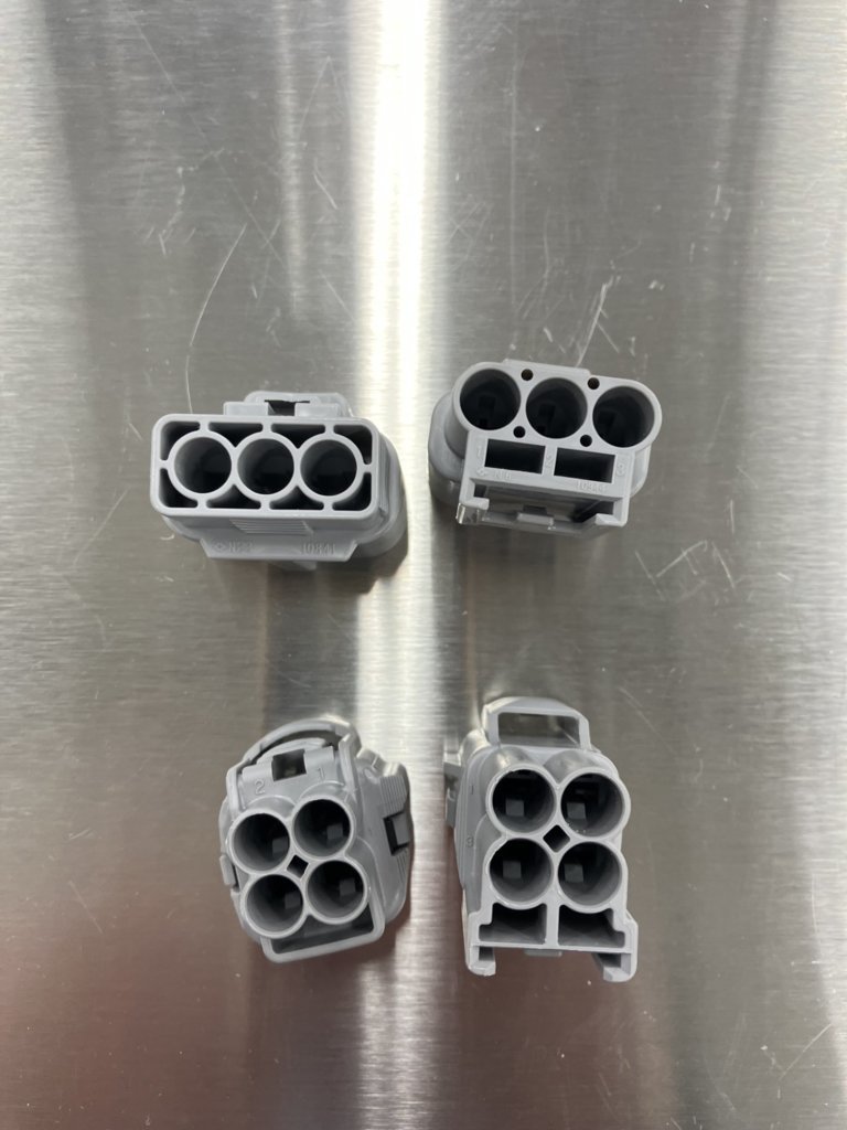

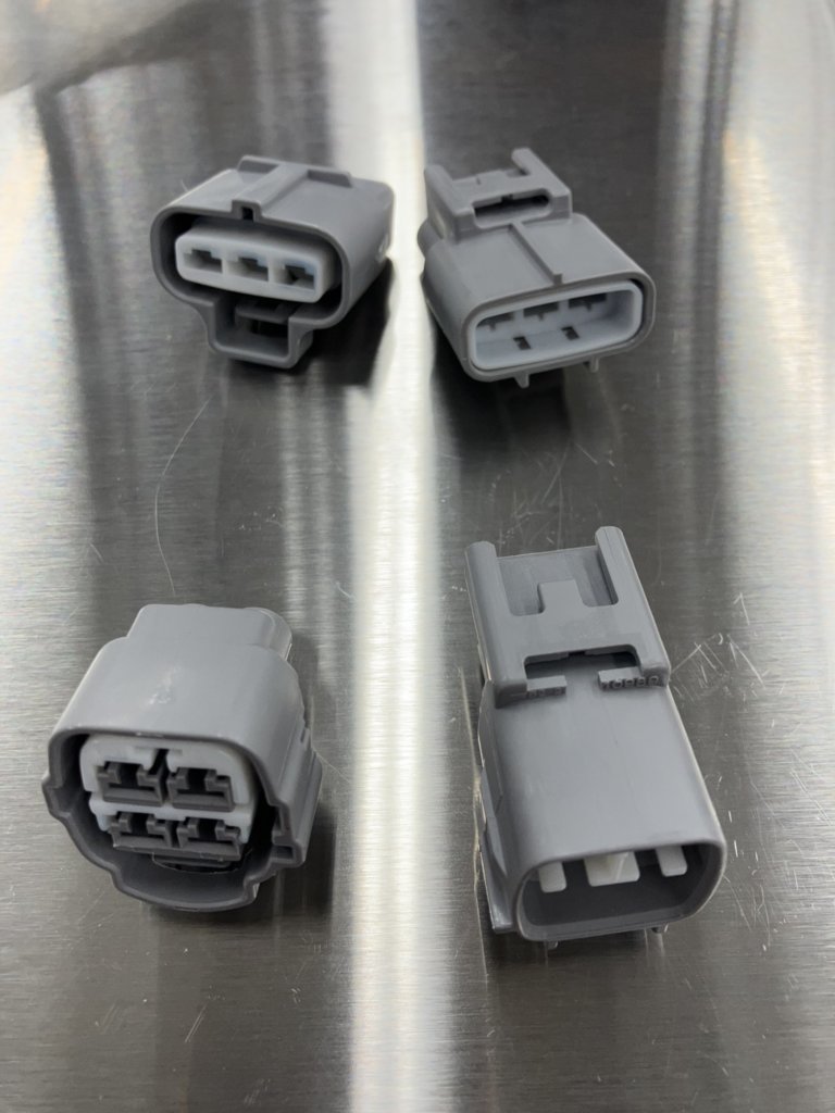

    Yeah, I went with that plan, but @Puppypunter's suggestion was converting to the 3rd gen Taco Aptiv single round connector style. I actually changed mine up a bit b/c the OG setup had ground in the 4 position and reverse in the 3 I think? And I wanted to do all the smaller wires in the 4 and the bigger ones in the 3 since I went 10 gauge for aux power, then 12 for ground and brake controller. I also fed left, right, parking and reverse off the 6 position (only 5 populated) center connector meant to feed the flat 4 way tow connector for the PnP poor man setup so I really wanted a direct feed from that to the 4 position, then I did my own ground (still have to do the ring terminal on it, I picked the prop valve mounting bracket for ground, good size bolt direct to frame and some clean metal once I loosened it, but non structural) and then my 10 and 12 gauge to the engine bay waiting to mate up with circuit breakers and brake controller output.
    I believe Corsa stocks these, let me look them up.
    HBTundra[OP] and shifty` like this.

    Those appear to be what I'm looking for.
    I was thinking that if I can't find them for sale somewhere , I guess I could scavenge the ones off this other Hopkins harness.
    Maybe cut & leave some of the wire length and then splice them in line.
    I was hoping not to add more splices than the couple dozen that this stupid setup already has going. LOL.

    I believe any sumi 187 will work. And I posted photos so you know they can be found. I got mine years ago and don’t remember where. I’m 1 month into the install which is maybe a handful of hours because I’m so time constrained.
    I’ll ask @Puppypunter to help locate the 4 positions. The 3’s are linked above.

  25. Apr 30, 2025 at 9:37 AM
    #25
    Puppypunter
    Puppypunter New Member
    Feb 22, 2021
    #59480
    131
    Johnny
    Denver, CO
    2019 Tacoma
    @HBTundra
    Female https://www.hi-1000ec.com/phone/product/3464
    Male https://www.hi-1000ec.com/phone/product/3463
    hi1000-ec also carries the 3 pin
    Female https://www.hi-1000ec.com/phone/product/2980
    Male https://www.hi-1000ec.com/phone/product/2978
    They are as much to ship as buying the full set unfortunately, but they are the only ones I could find that carry them. They are a Sumitomo TS187 as pointed out by Dave, so you will need these terminals:
    https://www.hi-1000ec.com/phone/product-list/184
    I’ve made a few of these for 4Runners. I think I still have the parts for them if you’d like me to make one up for you, let me know. I can make it tee right in there and run it down to a deutsch DT connector to plug right into the Diode Dynamics C1R. If you’d want to go the DIY route, I’m here to advise as well. Nothing wrong with that. Just be aware that the 187 stuff requires a little larger open barrel crimper than most.
    As to the 7 pin trailer plug, the type you have is different than the one that the “universal” plugs are designed for. The universal style didn’t start being widely used until around 2020 or so, and still isn’t actually “universal” yet. Toyota did adapt early thankfully, but not 2006 early. The type you have will pull apart, but you can’t really make a tee for it. It will be much more like 1/4” spade connectors inside.

    Here's where I'm at with mess so far, bare with me.
    I've got a new hitch outlet and bracket to mount to the frame.
    This one allowed me to put the DD Harness in line.
    It has loose wires at the end where it needs to connect to the factory wiring. (plugs)
    On the right side of the pic. is the Hopkins plug to toyota I originally purchased . . . but I couldn't separate the plug to get the DD harness in line.
    I was considering just cutting the toyota plugs off that harness on the right with some extra wire, and splice that into the contraption I have going.
    All the plugs fit nice & snug so far . . . but I feel like I'm kind of at the end of the road with my program, and realize that it's pretty hokey.
    Thoughts ?

    The new 7 pin fits your bumper okay? If that’s the case, I think putting those Toyota plugs on it is a good idea. Are those wires long enough for what you need? I’d be happy to send you some wires with the terminals crimped on and you can just swap them into the plugs if you wanted. I have the heavier gauge wires, though I’m not sure the colors would match. I can also remake just this part:
    Both of those connectors are pretty easy to de-pin though, so I think just some wires with the terminals crimped would make your life a lot easier. If you want that, shoot me a PM with how long you want it and an address :thumbsup:

    Thanks so much @Puppypunter !
    Yes, that new 7 pin with the frame bracket should work just fine. ( i will triple check though to make sure).
    I'll climb under there this morning and take a measurement for wire length, and a I'll take pic where things connect up to make sure.
    I really appreciate yours and end everyone else's help on here . . . I'd probably be returning this thing to DD w/o your help.

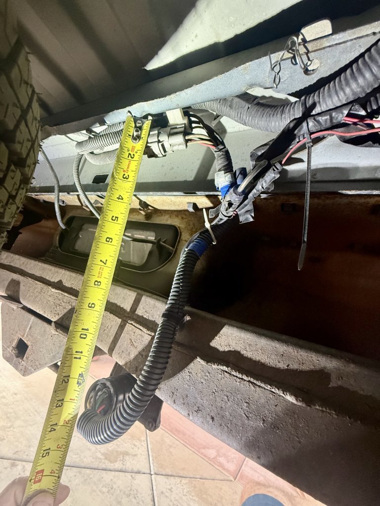

    @Puppypunter . . . Here's a pic. w/ a tape measure for reference.
    Sorry it took so long . . . I've been caring for my out-of-control 93 year old Dad.
    On a straight line it's looks right at 12" from the back of the hitch plug to where it connects to the factory plugs.
    The second pic. is of the hitch plug & DD harness laid-out . . . . looks plenty long. I guess I would need to connect up top with the right connectors.
