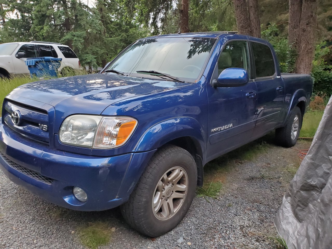

    Looking to buy first gen double cab
    Hi just had water pump and timing belt done. Mechanic recommended lower ball joint, Right now! Expected Im 3rd owner no record of it being done 175K miles.
    18 year old son is starting as a mechanic and asked if we could do it together (rare for me if he wants to do It Im all in). What else should we do while its on the lift? One shock is leaking...
    Upper ball joints? Plan in a year or 2 is to get a 19ft scamp 5th wheel and travel a bit. More dirt road to camp than 4 wheeling. Do not plan to lift.

    I’d replace both shocks, outer and inner tie rods, Sway bar bushings, steering rack bushings, valve cover gaskets if they leaking. ( I’d do all that if it’s never been done)

    Yes, replace both of the LBJs with new Toyota OEM. Repeat - new Toyota OEM. I recommend getting 8 new bolts and some Loc-Tite for the LBJs too since they're so cheap and our LBJ is "under tension". I also don't see any reason NOT to do the upper ball joints as well if there isn't any recent service on them.
    For what you plan on using the truck for, the mechanic's recommendation of Bilstein shocks sound good. I've read that some Bilsteins are back-ordered currently, unsure if that affects their first gen offerings. Maybe the mechanic has a source for them? I don't know the model numbers exactly, but I think you'll be wanting the 5100s or 6112s. Someone else may chime in on that. Replacing shock coils can be scary, I know from experience. Access to that commercial spring compressor is going to save you money.
    I would drive the truck for awhile and see how effective the braking truly is. Your truck most likely has the 13WL calipers already which is the "upgrade" that some earlier model years do. If it's stopping fine, you might open up a can of worms and make it not stop fine if you start doing the other "upgrades" that are possible (rear disc conversion, 14WA Lexus calipers). If anything you could see about bleeding the brakes and replacing the fluid with the Bosch 5.1 PHM got us all hooked on.
    Outer tie rod ends, sway bar bushings, sway bar end link bushings as @Toyoda Tundra mentioned are all extremely easy to do and now's a good time to do it. I haven't done my inner tie rod ends but I hear they are a little bit more work.
    If either of your tie rod bellows have tears in them, it's a perfect time to replace them when the outer tie rod ends are off.
    The lower control arm bushings might be starting to get worn out so I would take a look at those. Replacing them is tedious per other members on here but it sounds like you may have the tools to do it. Some just choose to go with new OEM lower control arms which include the bushings and cuts down on installation time. I noticed an increase in ride quality when I replaced my tired LCA bushings with brand new OEM arms.
    If you try take off the lower control arms you might notice that the cam bolts are frozen. Many end up having to saw them off and go with the SPC eccentrics kit.
    Your steering rack bushings are probably tired as well after 15 years. Replacing those with polyurethane bushings will eliminate some steering slop.

    1) New Control Arm Assys (with bushings already pressed in)
    2) New Cam Bolts
    3) High Dolla Alignment
    Do all these with the shocks and LBJ’s whilst on the rack.
