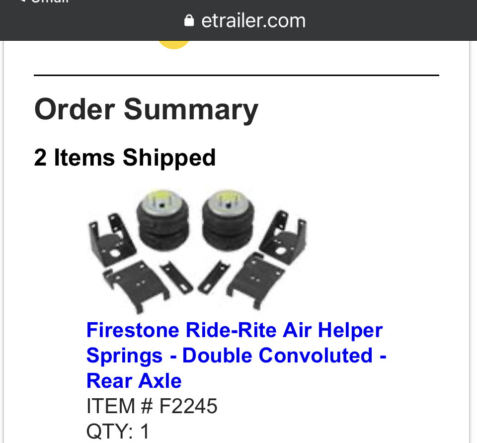

    Thanks for all your input. I decided to give this a try. Once I get them and install them, I’ll update the thread. Thanks again!

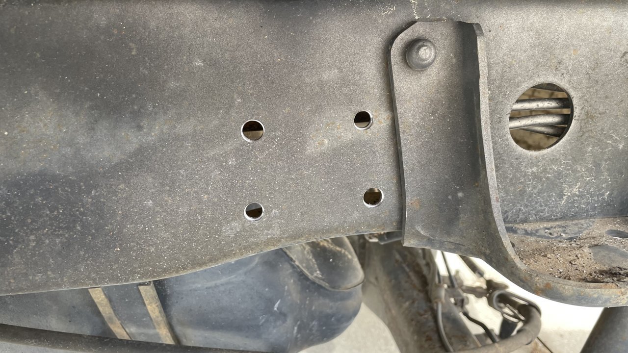

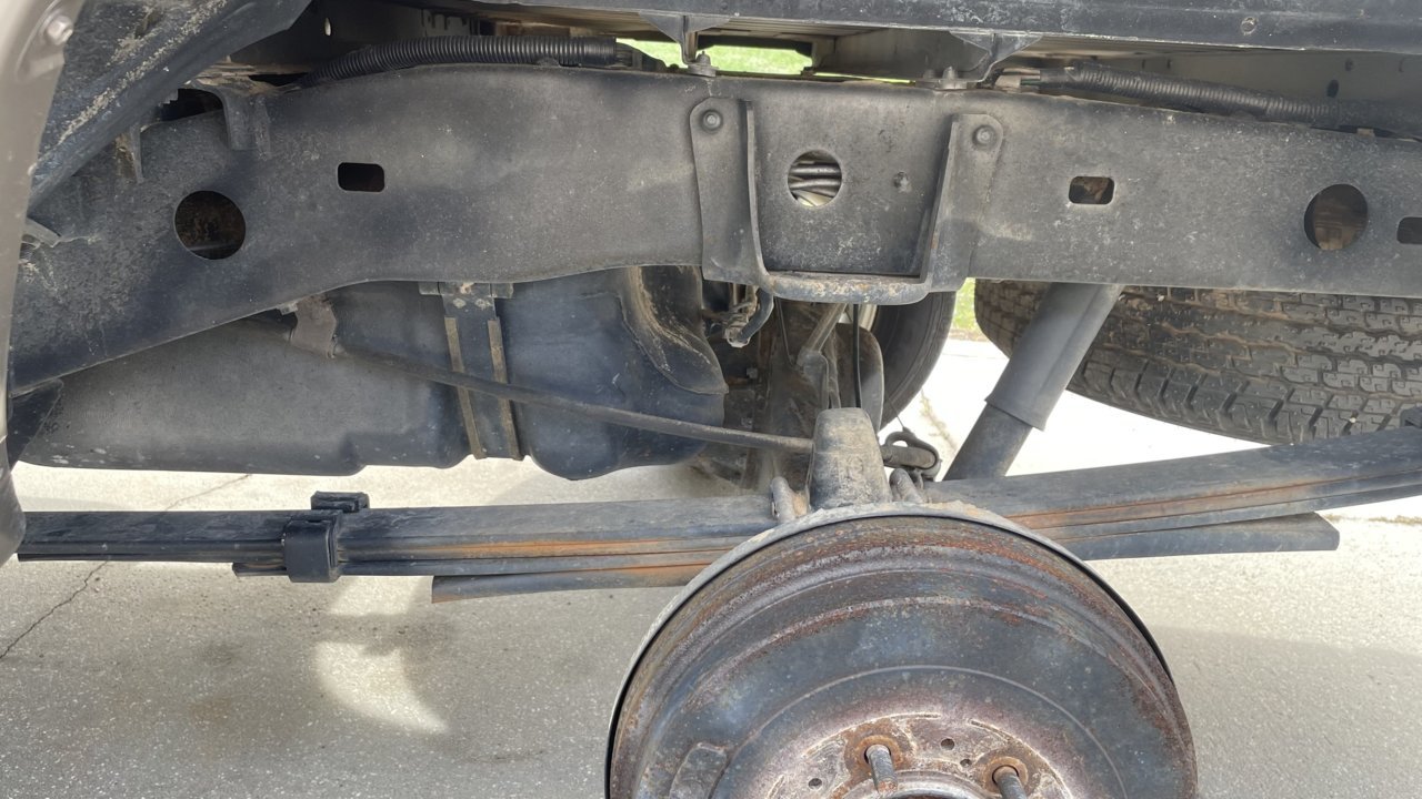

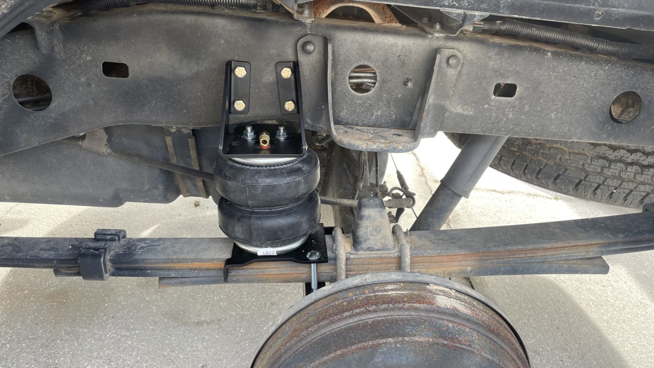

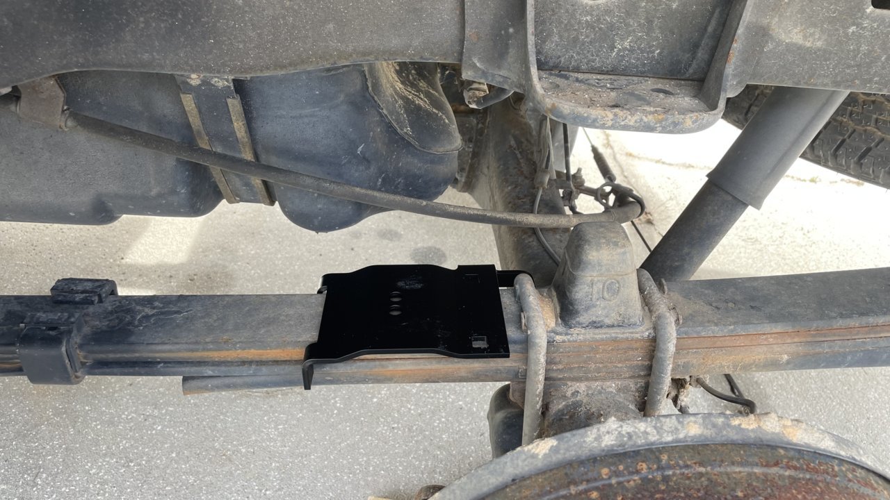

    Update, the install was very easy and very straightforward. I took a few pictures to show everyone. This is a great aftermarket option!BE49B9CE-5F3C-449C-9ACB-5DF24FF76618.jpg 010361BB-AD46-488C-A521-364F287EE0C9.jpg82CCA7B6-F90D-4DE5-A7C5-9220C4E51CEE.jpg 4C8124CC-212F-476F-A692-F3A1E8FBEB8E.jpg

    So that bolts to the frame only, and pushes down on the leaf?
  10. Dec 26, 2022 at 2:51 PM
    wegner44
    wegner44 [OP] New Member
    Nov 22, 2022
    #87156
    11
    2005 Gold Tundra DoubleCab SR5
    correct, you have to drill the holes but that is explained very well in the instructions as far as placement goes. Then it just clamps to the top of the leaf springs.

    How do you plan on filling them? Just a Schrader valve like a tire?
  12. Dec 26, 2022 at 7:26 PM
    shifty`
    Jun 20, 2020
    #48239
    29,485
    ATL
    '06 AC Limited V8/4WD
    Usually anytime you're buying Firestone bag kits, they come with Schrader fittings and hosing, with fittings to isolate, or tees to tie them together. I don't recommend teeing, letting each bag have its own isolated air is better (IMHO) if towing. I helped my dad install his bags on his 2.5, the Firestone kit was easy. We ended up having to pull his bump stops though.

    Noted about teeing. If you've got a fitting/line that blows, you're only down one side. Not both. I think I'd route both hoses to the license plate, or thereabouts.
    That Firestone kit looks good that OP installed
    https://www.etrailer.com/Vehicle-Suspension/Firestone/F2245.html
