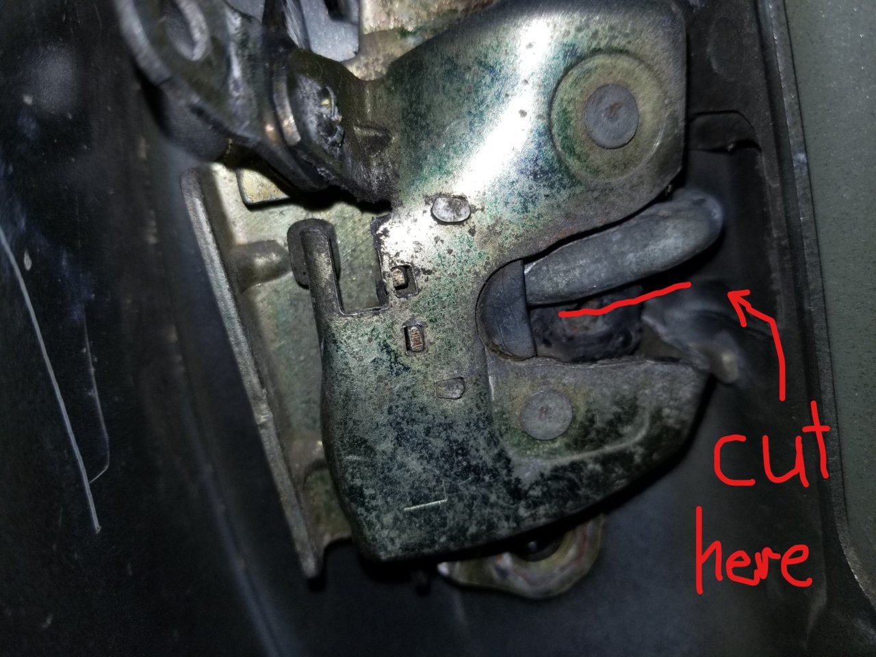

    Ok, if I can remember this correctly, then a simple cut will free up the latch. I recovered the pic from back when I was trying to tackle this same conundrum.

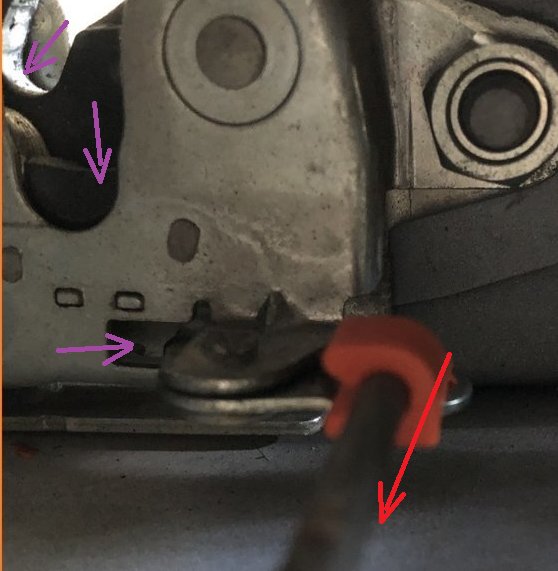

    Once the back plate for the tailgate is off, OP should have full access to the latches.
    I suspect just spraying some PB Blaster all up in each mechanism (purple arrows is where I'd start), let it set for about 15-20 minutes, then hook into the arm with the red arrow with a coathanger and pull on it a few dozen times will probably free up the mechanism, regardless how bad it's rusted up. Rinse/repeat on each side. Once tailgate is out, you can access the light for the bolt. Then go to the JY and get a new tailgate to pilfer parts from, or just swap it in. After lubing everything up, of course.

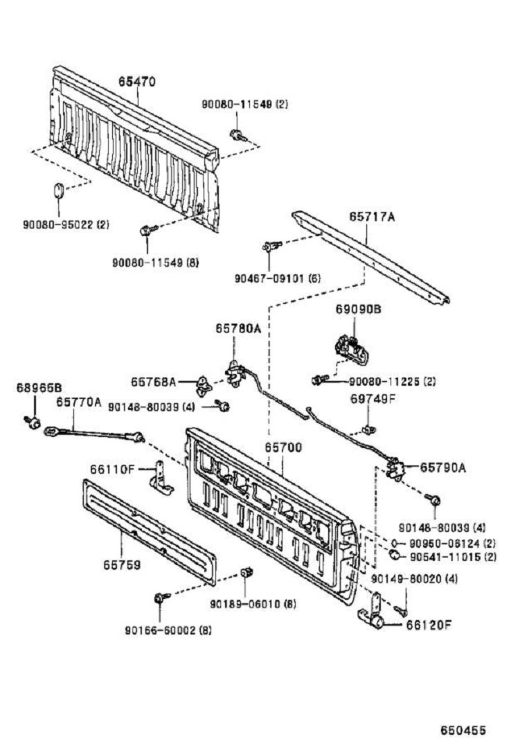

    https://parts.toyota.com/a/Toyota_2...-BODY-GUARD-FRAME--TAIL-GATE/841420-6553.html
    If you need any parts from the bed sides, like the loop the latches hook onto I can grab that too.
    This image should help you cross-reference the parts you need to the parts list below the image on that page. Any of the 5-6 digit numbers in the pic, you can search for them in the parts list to see the longer 10-digit OEM part number.
