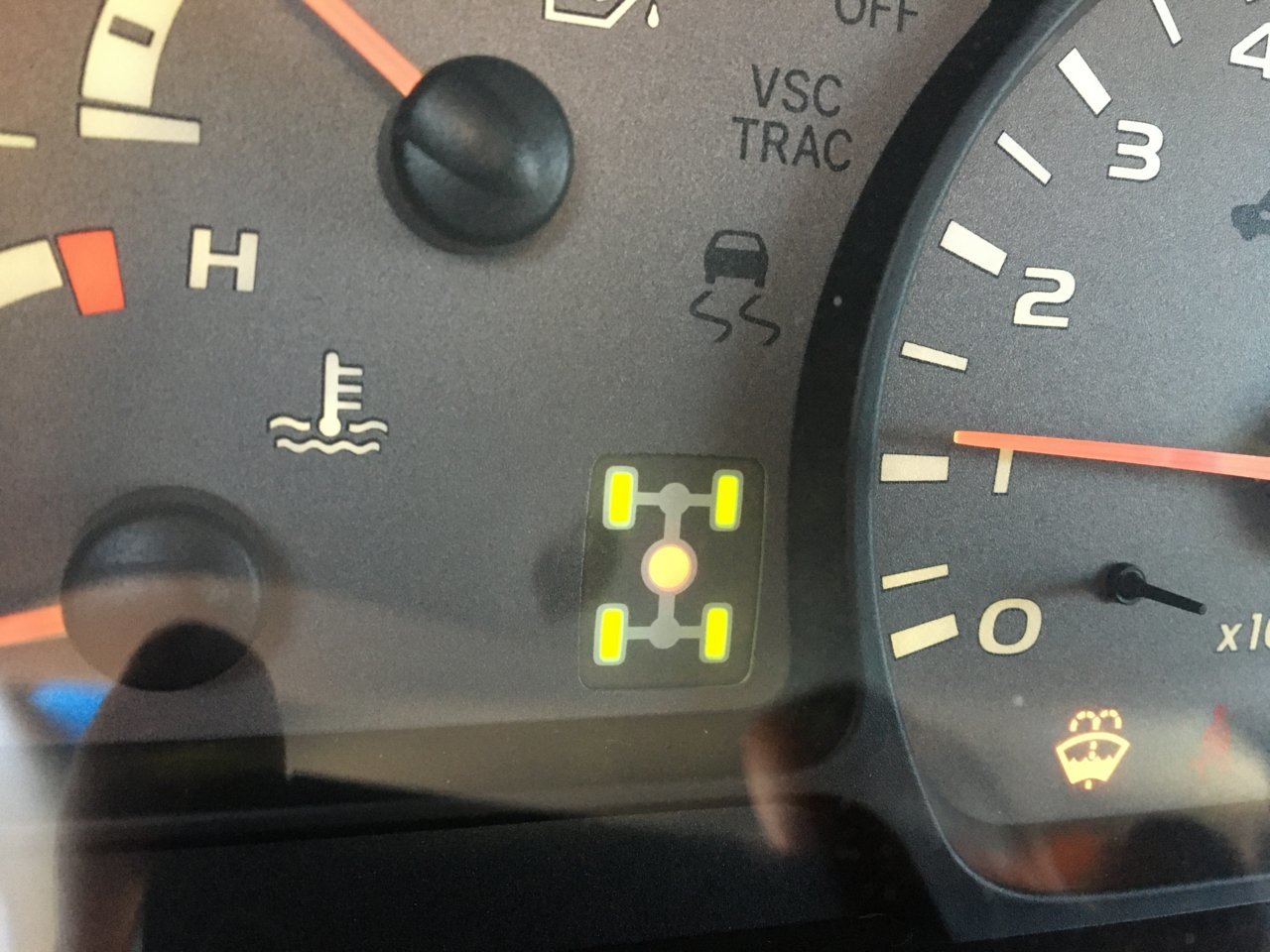

    This is the light that is on. The center round light blinks

    thats a sequoia cluster isnt it? i dont think tundras ever had the AWD case

    If it is indeed a Sequoia, are you sure the transfer case is not in neutral?

    Fixed today. Transfer case shaft was all the way in. Pulled it all the way out and it’s moving now
