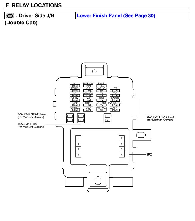

    2 - pulled 15a fuse on inside fuse panel and lights go out, with ignition off
    3 - put fuse back in and the lights turn on, with ignition off
    4 - i can hear the relay click on and off for the head lights.
    5 - i suspect there is a relay for the parking lights on the back side of the fuse panel
    6 - how do I access them, and which one is the parking light relay?

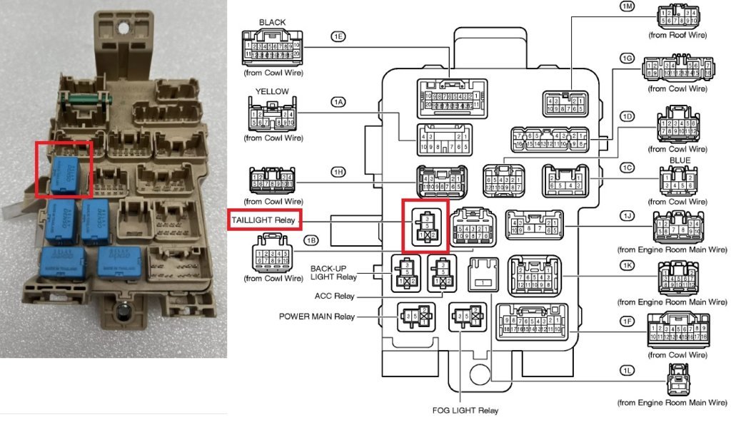

    Are the dash/panel lights on all the time as well?
    They are on the same circuit as the parking lights.
    The TAIL fuse powers both.
    Is it possible the TAIL relay is stuck in the on position?
    And yes, the taillight relay is in the under-dash fuse box.

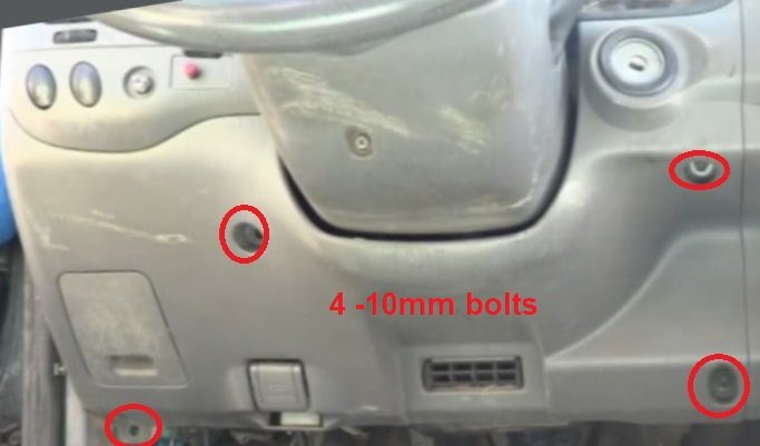

    i can see the relays on the back of the fuse panel, but i can't get my hand in there, do i have to remove the panel to access them?

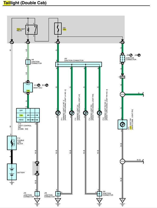

    But you do have "Anti-Theft system with remote keyless entry", which was a Standard feature for 04 DC LTD ? Those 2 can play a part but are the least likely.
    Definitely concur with the below, including the question below in bold @1lowlife asked.

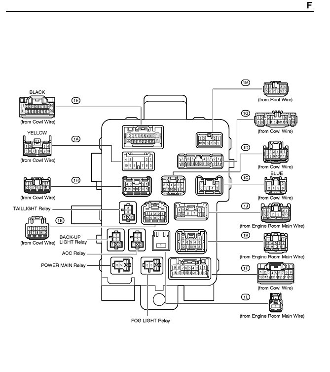

    There's not an easy place to start given taillight relay location, light control switch(combination switch) and the Body ECU(up above cab fuse panel) which is part of the circuit that gives ground signal to taillight relay, as shown in the Taillight circuit @1lowlife posted.
    edit: noticed the below after preparing to post....

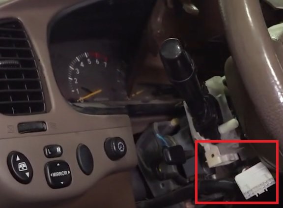

    Yes, you'll have to remove lower finish panel and then attempt to get to taillight relay. I would definitely unhook battery when doing some of these checks. In case you have ot trouble shoot combination switch, the below video should help.
    May be more than you need but I'll post it just in case....

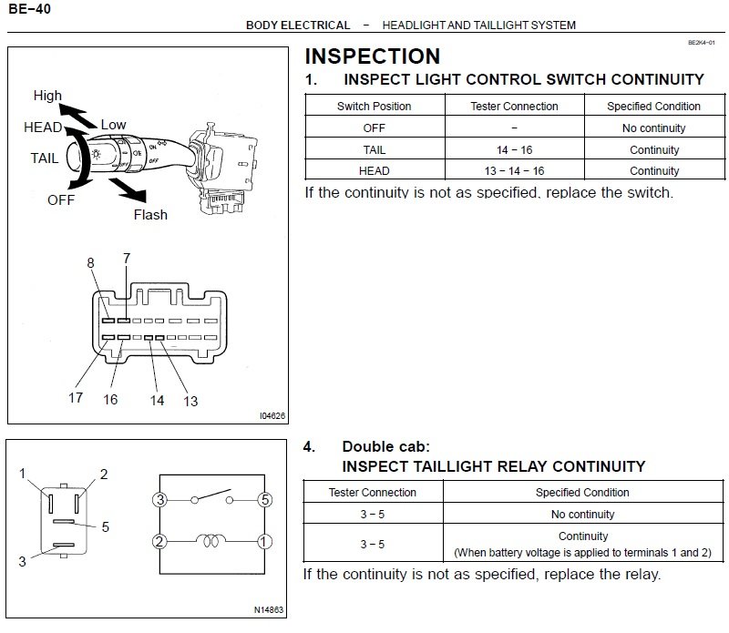

    light control switch tests ok for continuity.

    Just to make sure….you checked the switch itself with connector unplugged with switch in OFF position….pin 14 & 16 ?

    yes, i removed the light control switch, and used a multimeter, and switched back and forth between off and tail, there was continuity between 14 and 16 when switched to TAIL, and then switched to HEAD and tested 16 to 13 and 16 to 14 which had continuity. no continuity when switched to off.

    Something is grounding your light circuit.
    I'm no mechanic but I don't think the ECU is the problem.
    Do you have a trailer light plug on your truck?
    Have you checked the wiring looms under the truck, bed and spare tire?
    There have been threads about crushed wire looms shorting and/or grounding circuits.
