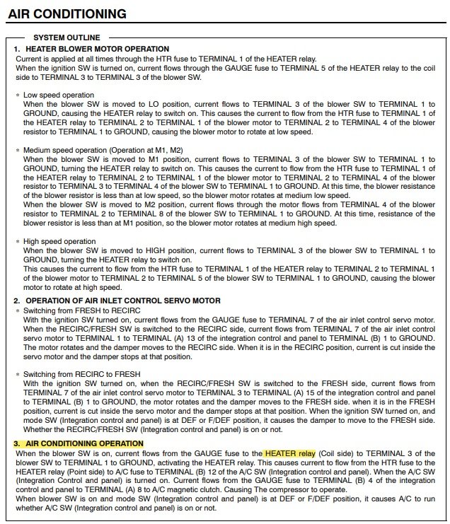

    It is indeed....located under the hood in fuse box labeled "Heater" in my 2004. The heater relay feeds power to the A/C control Panel.
    From 2002 FSM....
    Heater Relay location 2004....also for future reference, there is a 50 A heater fuse in the longer fuse box that would also cause A/C not to work.
