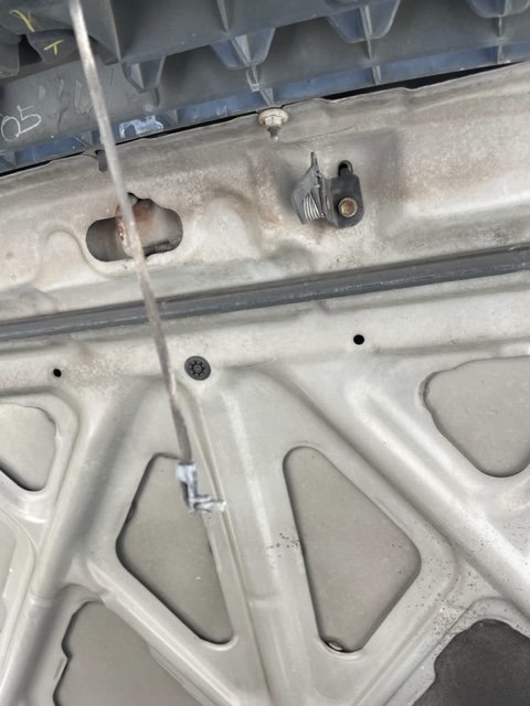

    I have a 2001 tundra with a dead battery and i can't open the hood. The latch in the cab works but the second under the grill doesn't. Any ideas?

    I don't know how the mechanism looks or operates or how i could force it manually and there are no good videos that i have seen that help.

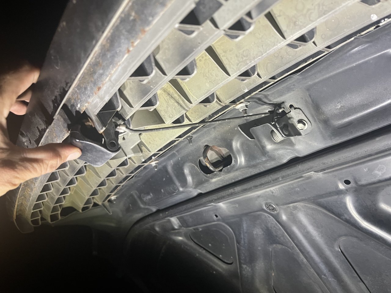

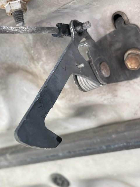

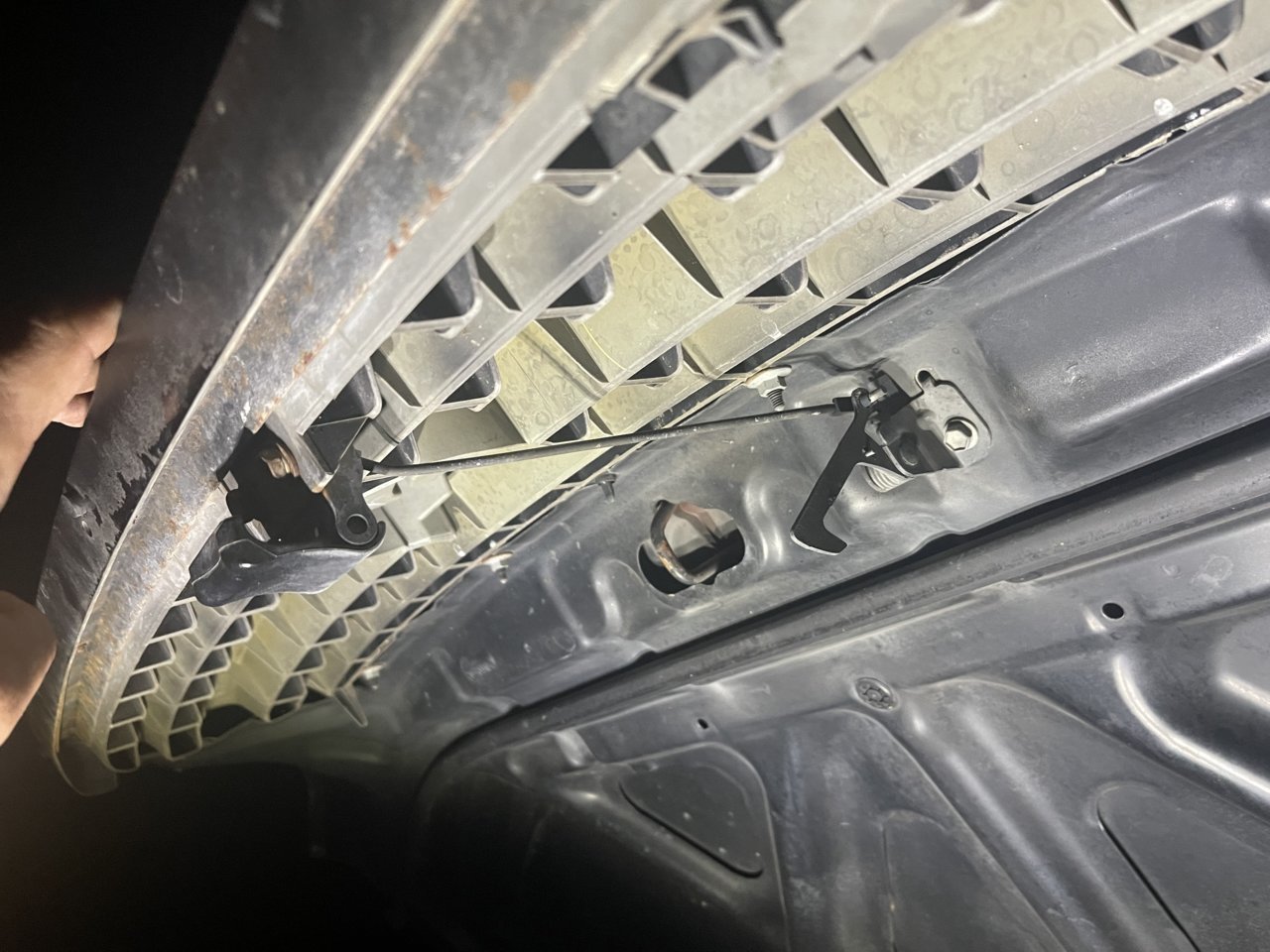

    The rod needs to be pushed up for release.
    NewImprovedRon, Schcoman and shifty` like this.

    I can see the rod and move it with my fingers. Tomorrow, when i can see better, ill try to grab it with pliers and maybe try to manually pull the hook up. Thanks for your help and especially the photos!

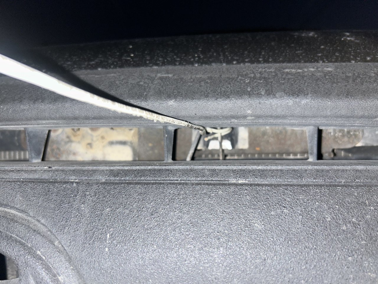

    Mc bee is right, but shine a light in there to the right of the toy logo. Latch pulls easy with wire. As long as you can get some relief from cab latch.

    Grab the bottom of the hook with needlenose and pull it forwards. I dont know about the '01 grille, but i could reach the hook theough my '02 grille.

    Good photo, pretty easy once you know where it is.

    I'll have bright sun in the morning to see. Tonight, i couldn't see anything but the rod but now that i have photos i have something to work with. Thank you very much. Thank you all. will post more when i know more.

    Got the hood up and battery is charging. guessing there should be a clip holding the rod to the latch.

    Dorman makes an assortment pack you can pick up at most local auto parts stores. Dorman part number 75450, info/part pics here.
    The OEM clip you have pictured there is Toyota p/n 69759-0C010 but there are a couple other clips used in the assembly, I can't tell what you're missing from the pics.
