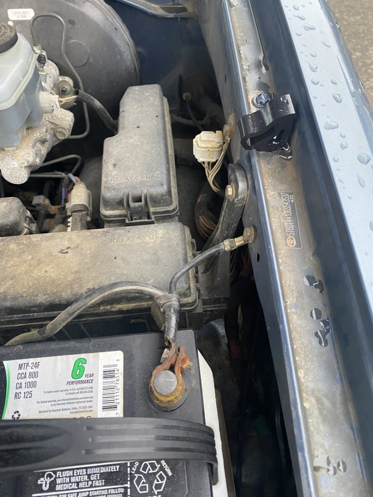

    Post a pick of your engine compartment showing battery and wiring
    G_unit3000 likes this.

    Nothing appears to be out of place. Power (+)cable from the main fuse box is on the correct terminal and ground is connected to the body.
    The backwards starter direction and the doors unlocking when cycling the key to start leads me to believe something might be wrong in the dash/ key start mechanism

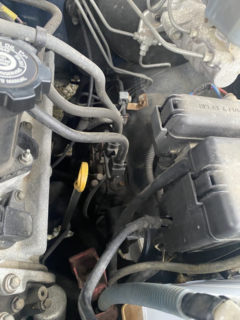

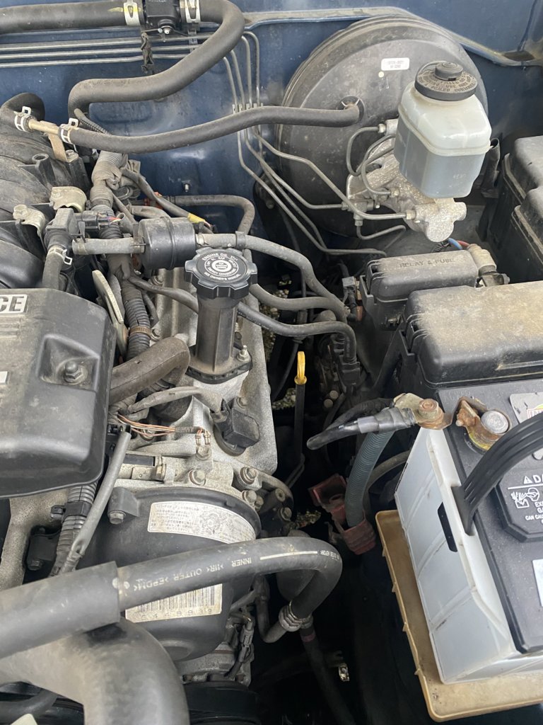

    4W 4 door sr5
    Engine bay wiring appears to be normal

    Dude. Battery maintenance.
    • No hold-down for the battery.
    • Those terminals are rotten as fuck and need to be cleaned up temporarily and/or replaced.
    • You should also be checking for corrosion in the cables, since it's a known problem.
    What's up with all the tape//bulge where the positive cable goes into the fusebox, did someone splice anything?
    But again, I cannot reiterate enough after the many times we've seen it here, since our V8s *are* interference engines and *can* be killed if the timing belt goes or timing is way off, this being the most-recent case, where the poster took 3 pages to finally listen:
    • Verify timing.
    • While in there, assess condition of the timing belt - any hairline cracks, any fraying, are the markings intact signalling it's not too old or is the belt old and shiny? Toyota calls for 9yr/90k miles *if* you use OEM (Aisin/Toyota) brand parts; you should make a point of doing it before 100k/10yr.
    • Make sure the crank position sensor is correctly routed and harness not cut into (proper routing info here)
    • Ensure the cam position sensor wiring (thru driver side cam cover) is intact, not frayed, typical misrouting damage looks like this, correct routing info here
    • With timing covers, be careful not to lose the steel inserts slid into the plastic cover, they will fall out with age.
    • If all that looks good, button things back up, then do a compression test on the engine.
    THEN and ONLY THEN would I be attempting to turn the truck over, start it, etc.
    You need to understand, again, interference engine here. Don't fuck around if the previous owner flat-out told you "motor is damaged" but provided no other details. If he said "motor is damaged", and you find a brand new belt in there, it's possible it threw the belt, and he's not lying.
    NOTE: Compression test throwing bad numbers on a single cylinder or one entire bank does not always equal "catastrophic failure". Other things will (and we've seen it!) cause that:
    • Timing is off by 1-2 teeth.
    • Valve is stuck, which can be salvageable without major surgery

    1: That’s not the battery that was in the truck. I threw in an old battery I had leftover just to get it started
    2: Battery tie down is in my garage. Truck hasn’t started since it was dropped off so it’s not an issue.
    3: timing belt(s) are in sync and good shape

    Let's not forget that there could well be more than one thing wrong. The last owner may not have given you ALL info. So just checking the timing is worthwhile anyway on an unknown 'damaged engine'.
    Also, the -ve battery terminal connector itself looks pretty corroded. That's could well give you a dodgy ground for the electrics, ECM's etc. Slow crank included.

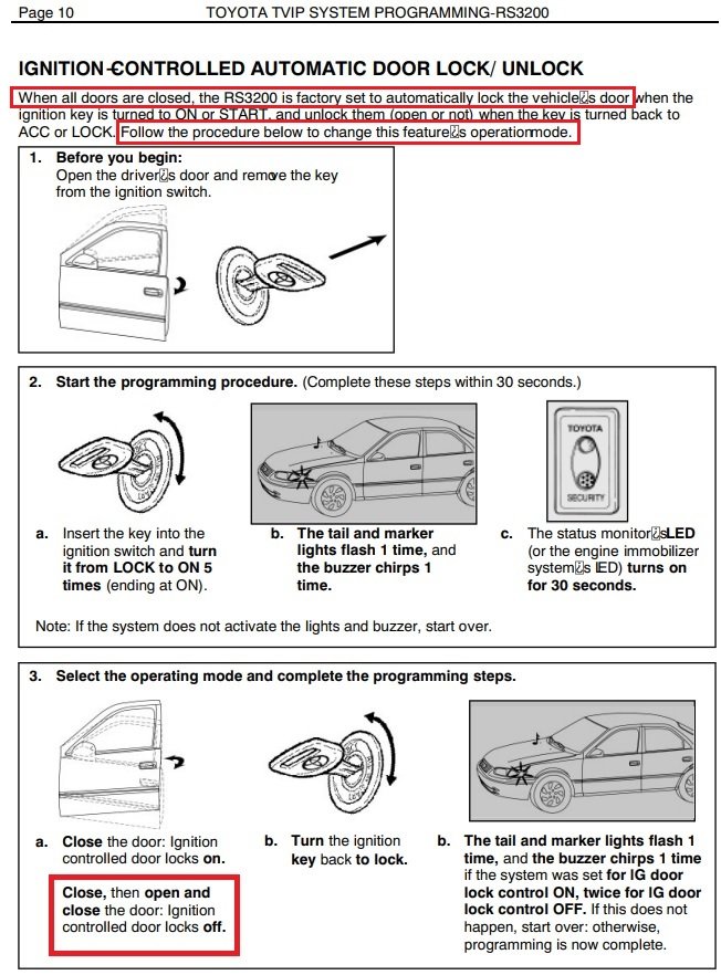

    Sorry, too early for humor but maybe later :)
    Perhaps one of the previous owners changed the RS3200 factory setting for the Ignition auto door lock/unlock to Unlock doors instead of Lock.
