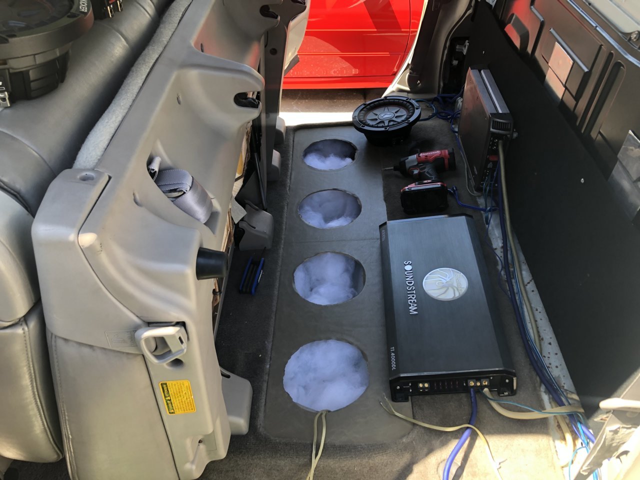

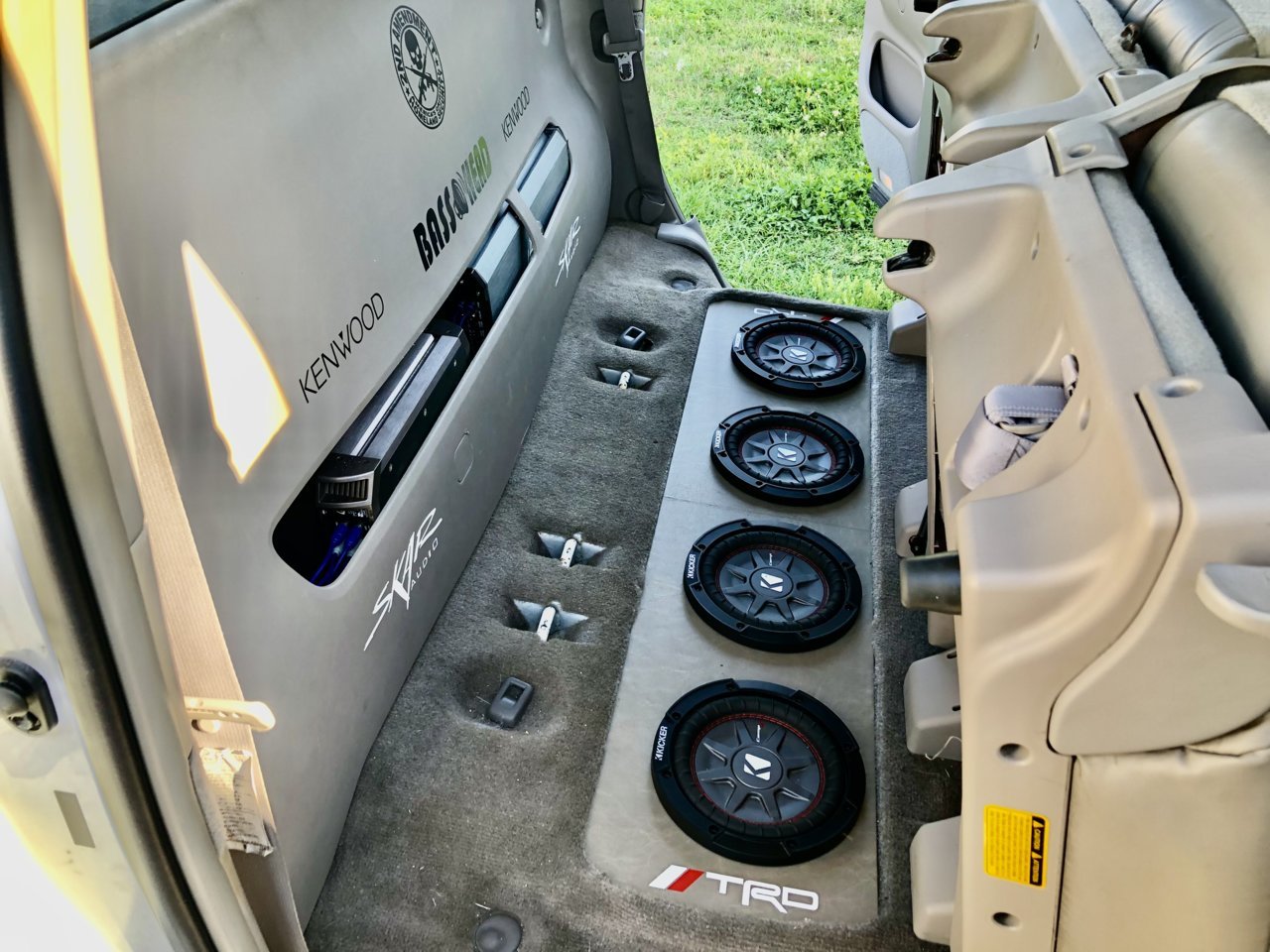

    Kenwood Double Din Skar Audio 6.5 Pros in the doors Rockville 15” DVD flip down TV Rockville (2) 8” shallow subs under seat box Rockville 1k Sub Amp Rockville 1k Mid/High Amp Back up Camera Replaced rear factory Chrome Bumper with all White Bumper. Bed Rug
    CB1E8557-A026-4CD8-8841-A146CF1EFCFF.jpg 4 - Kicker 8s
    1/4” MDF Top

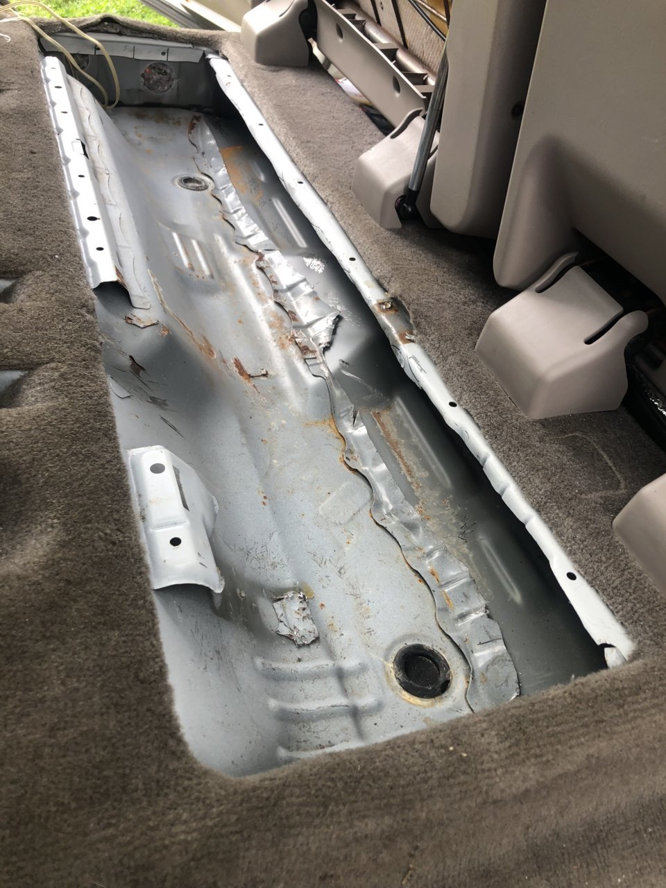

    Dynamated the storage compartment
    Poly filler
    Had to hollow out the dividers for the storage compartments and some of the housing surround.
    Still has the factory look until you lift the seats!!LOL!!
    Came out great!!

    Needed .... a little wattage there? That Soundstream is a freaking monster, how is it possible that's only a $189 amp?

    Nice, thats what I did in mine but only 2 8's. Is there a reason you only used ¼" MDF?

    Huh. I missed that 1st read. Yeah, I would've used 3/4" MDF (1/2" minimum) for that baffle board.
