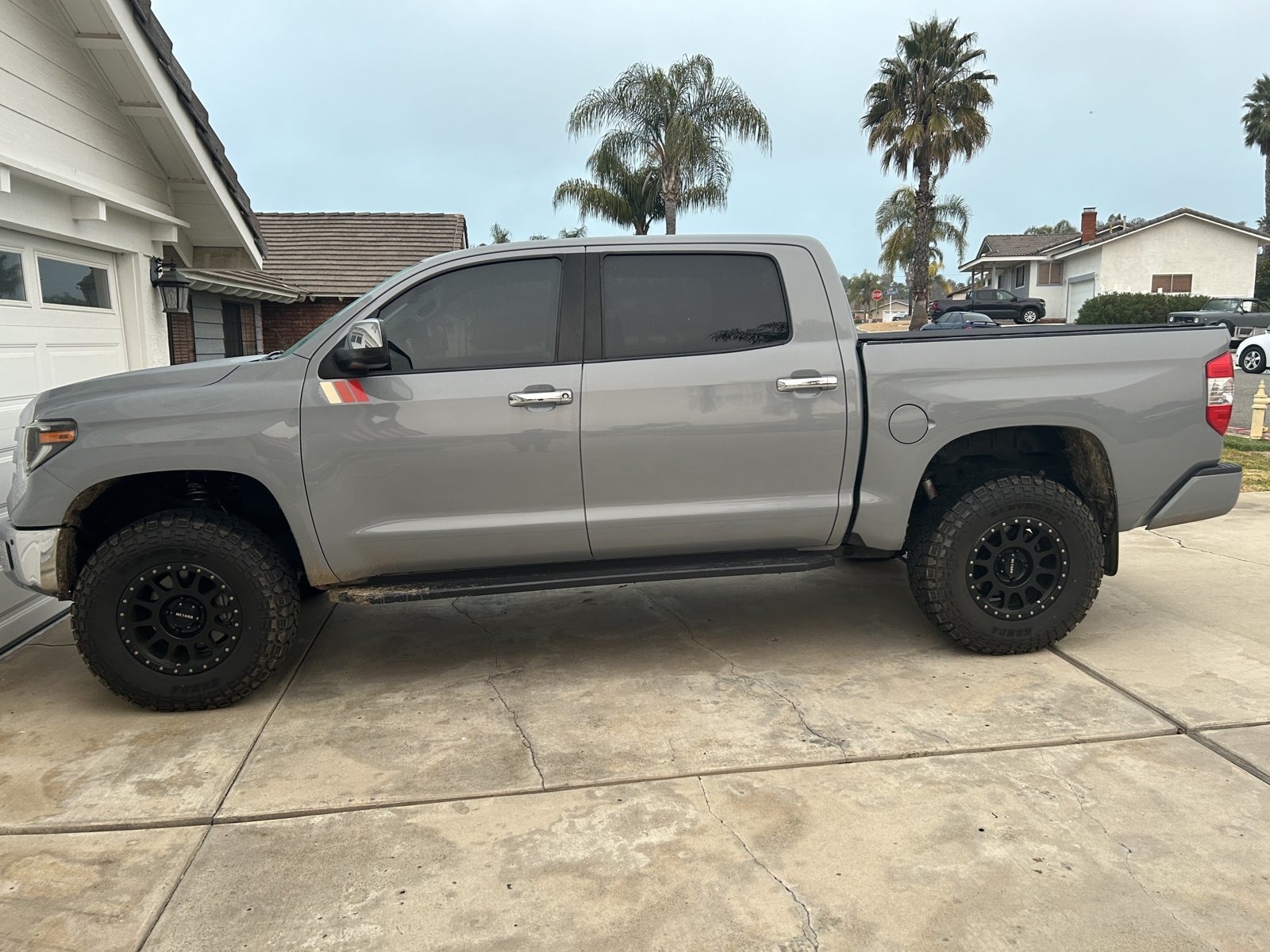

    Let me walk outside…

    285/75/18 Kenda Klever RT on Method 305 NV.

    so mudflaps obviously gone. BMC? bumper spacers?

    No mud flaps. No BMC needed. No bumper spacers. Heat gun and a tennis ball worked great but still rubbing somewhere at full lock. Lift is a Toytec 3/1.5 with SPC UCA’s.

    I do have the stock skid plate. I’m thinking that may be where it is rubbing. Articulation is good but stuffed with the 285/75/18. Spare is a slightly used 295/70/18.

    I loved my 295/70/18’s but they just didn’t seem to fill the wheel well enough. They looked fine but just slightly small. I can post a picture with the 295/70/18’s too if needed.
