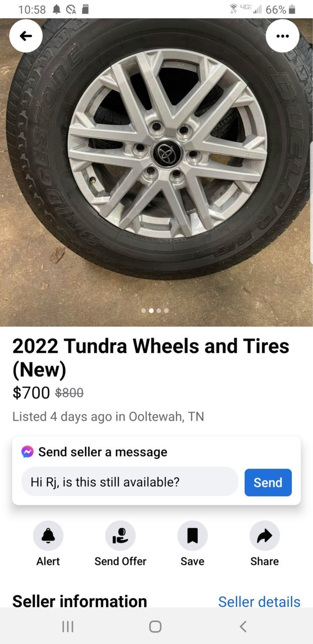

    6 lug 18in 265/70R18. I have a Rough country 2in lift. Can I make these work on my 03 tundra, Or should I sell them. Running 2018 4runner 17" wheels now with no problems of rubbing. Thanks Screenshot_20220411-225827_Facebook.jpg

    Don't seem to be deepset, should I run 1.5" spacers or maybe 2" spacers ?

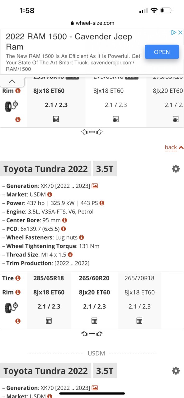

    I still wanna know the hub bore. If the new wheels have a smaller hub bore, are there spacers that can adapt?
    big hub bore:

    On a quick glance it appears Toyota is still using the same bore. But I’ve yet to measure one
  14. Apr 19, 2022 at 11:59 PM
    empty_lord
    Feb 1, 2019
    #25441
    10,129
    Dan
    Indiana, Chicagoland
    05 rollover special
    Quick google search shows it’s still a 106mm bore.. should fit

    Hmm found a photo of one. Yea. These are a no go for any Toyota other than the new tundra. A slave can make it fit yea. But you won’t be hub centric anymore

    If I put 2" Spacers wouldn't that nullify the center bore difference ?

    Bassani cat-back
    I wouldnt recommend it, but i did find spacers without the hub lip. It also said those wheels are for m14 studs. I dont know if that could cause problems. You’re gonna kinda be on the bleeding edge of this. Would be cool to find spacers with the 106mm on the hub side and the 95 (or whatever it is) on the wheel side.

    Yes noticed the holes in those wheels are a little bigger than my other wheels. Don't think I wanna tackle that , probably just sell them, Tires have a 150 miles on them guy said, look brand new. Bridgestones
