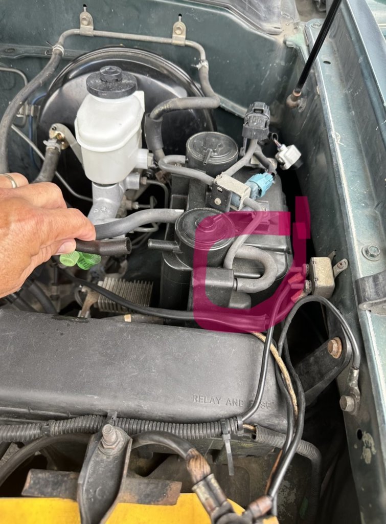

    The little 180 degree vacuum hose on the evap cannister of my truck turned brittle and cracked. The part is not available separately and the cannister assembly is crazy expensive. After some searching I found a solution using a section of 5/16 mandrel formed 5/16 project hose I found on Scamazon.
    Amazon.com: 5/16" Mandrel-Formed Molded Rubber Fuel Line Hose Elbow 45° 90° 135° 180°degree bend-5/16 molded hose(45 90 180 135 degree bend turn angle) : Automotive

    Hi, Great- question answered.
    Seems like every diagram shows everything but that one. Smog mechanic pointed out was spitting at ends.
    I cut the cracks off and was able to slide back on for temp fix, hose clamped ends with mini nylon ties, w/ many others too
    in case they crack. This should be inspected by anyone with a 4.7. Ordering the one at Amazon noted. Thanks!

    Tagging this for later. Mine looks rough too.

    As well as the 5VZ. I have replaced mine also. Exact same canister.
