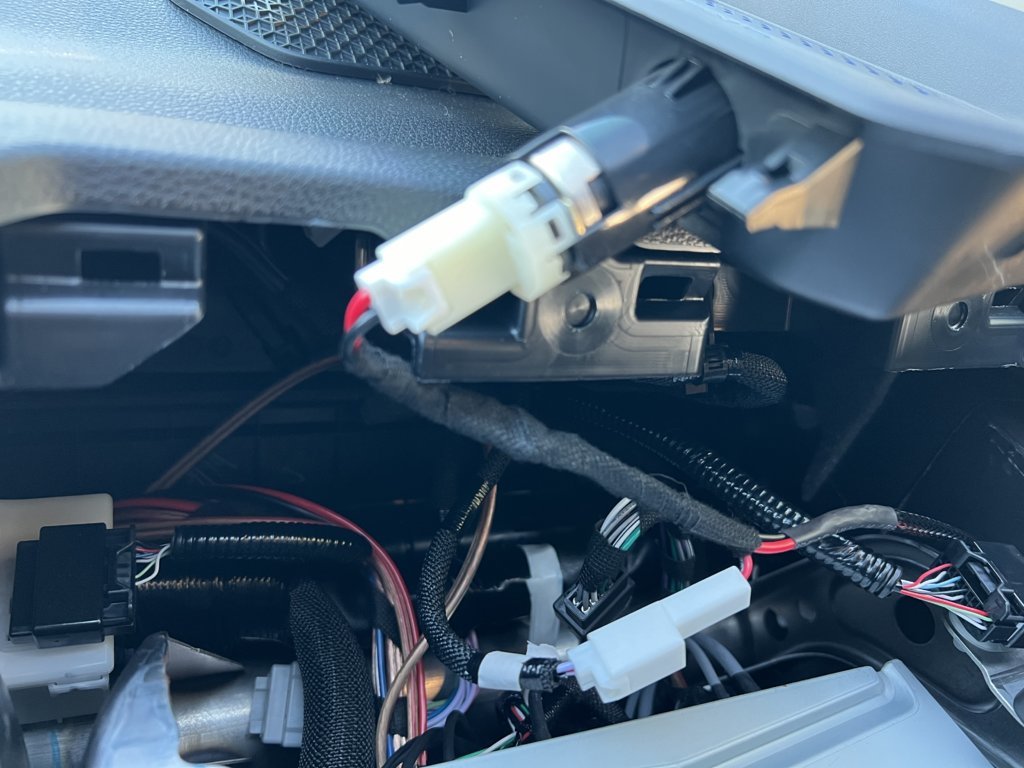

    I don’t use my cigarette plug up on the dash, and since it’s already wired for “ignition on” I’d like to use the positive to run the backlights in my Diode Dynamics SS3 pods…
    I’m assuming that the gray with red stripe is the +, as opposed to the solid grey, but wondering if anyone else has tapped into this power source or has a way to confirm…

    Multi-meter is the easiest way to confirm without damaging anything. Put the black (-) probe into the grey wire half of the connector, and red (+) probe in the grey and red stripe wire half of the connector. If the multi-meter reads positive voltage, there is your answer. If the multi-meter reads negative voltage, switch the probes around.

    I went and grabbed a multimeter, and sure enough, the red stripe was +…

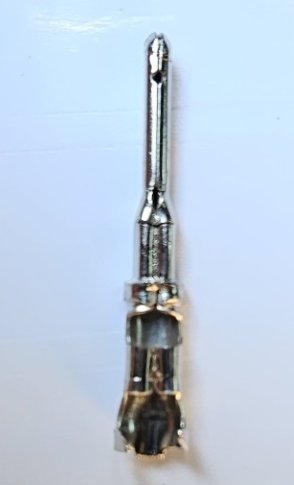

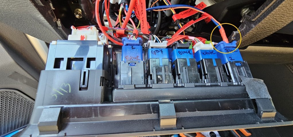

    The smallest posi-taps they make are these...
    https://www.amazon.com/Posi-24-26-Youll-Choose-Amount/dp/B0B34SK6KH?crid=C89EL0TZKLVO&dib=eyJ2IjoiMSJ9.lPi6VeUqExis7inrl7_5-bdRYyVsnFpGge8xiMuSgpbJIeQIeJrLho7GoZlJTCjvBmY9Vkg1xusyDSptSuBVR6PgqI9o2dnTHipyhk8YXitbX461E7VtAs8lOHahU918ZCt3xu7yEU_A7HyqF-s-5i0igOq-Iv_Im5H014EV0mhPNyL5JvarhnCPHmD6h0Y8eOjaX7xXKNKmbj0fy7D6HuDc6Hs0o8EWbNAGpGqEs1JDaHPYneoyqaj0tTe_uawN-cVZuZLQl-oVK_QFyjMyvp_wypY6slSjy4gjxttwt_o.poKcvkbhT1olzNcoqY06Lz_GN7H43_WK-FysjnqB3SM&dib_tag=se&keywords=26+posi+tap&qid=1730423475&s=industrial&sprefix=26+posi+tap%2Cindustrial%2C89&sr=1-1&th=1
    I just tapped into the dash lights this week. I used a male Deutsch connector, crimped on my wire, heat shrank it and inserted the Deutsch connector into the rear of the stock plug, tan wire. I do like the idea of posi-taps but not a wire as thin as the stock ones.

    so you stuck the deutsch connector into another switches beige slot, and it fit with the original switch’s connector still in tact?

    Depending on how much wire is available, you can strip extra wire insulation off and fold the bare wire back onto itself to get more thickness for a better crimp.
    It looks like they de-pinned the original switch's deustch connector and cut it off, then got a new pin for it and crimped two wires together on it before re-pinning the original connector.

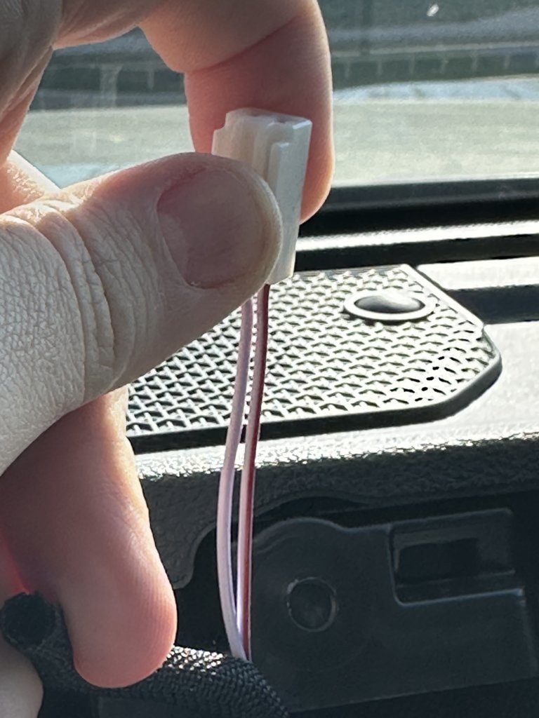

    Could reach out to AutoHarnessHouse and I'm sure they'd be able to identify that connector and make a female harness with bare wire ends for pretty cheap. I think I found the right connector on AliExpress 1 Set 2 Pin 90980-12498 Automobile Cigarette Lighter Cable Connector Wiring Socket With Terminal For Toyota Vios Levin - Cables, Adapters & Sockets - AliExpress and plugged the part number into a Toyota Parts site and it came up with this: 90980-12498 - Toyota Parts Deal, of course you'd still have to get pins and wire, hence why I'd reach out to AutoHarnessHouse. No t-tapping, splicing etc. if you go that route.

    I have a few of the male and female connectors if someone needs a set just lmk and just pay shipping.
    I made my own jumper harness for the cig lighter when I wired up my phone charger and got a 10 pack

    Yes, the Deutsch connector is just pushed into the back of the stock plug where the tan wire is. It holds itself in by basically wedging itself against the sidewall of the connector and the existing crimped tan wire. You could also tape the wire your adding to the stock tan wire to prevent the Deutsch connector from slipping out but in my instance it doesn't seem to need it. My picture shows 2 wires in the Detusch connector, one is for the 22mm air compressor switch I added in place of one of the blanks and the second is for the air gauge I also installed.
    Again, the reason I did it this way is that it is easily reversible, just pull the Deutsch connector out. If I were to do it any other way it would be to use a Posi-Lock, I would personally consider that permanent since it is putting a hole in the sheathing and penetrative the wires. That wire is so small and thin I'd be afraid that if the posi-lock were removed the wire may split.
